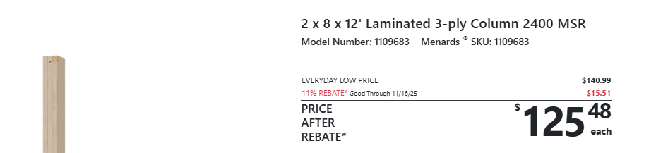

I would buy them from a glu-lam manufacturer. Nobody can do it better than them. They are PT on the bottom only and use finger joints at the end joints. I'll see if I can find the link to the manufacturer I saw in PA. All the PT & SYP comes from down your way, there should be something in your area.

>Glue laminated columns as stated earlier are the best, but are also very expensive.
I've never priced the poles myself but I have heard the glu-lam poles are reasonable if you are shopping for longer poles (>16'). I'm sure there is some length were the glu-lam posts become a no-brainer. Probably not for your 12', 14', or 16', posts though.
I used 16' solid posts on my last barn and ordered 6 extra "just in case". Boy was I glad I did that, a bunch were warped and or twisted, and couple had some big nasty cracks down the length of the pole. In the future it's nothing but glu-lams for me. I'll probably save money as I know I won't have to buy extra /forums/images/graemlins/grin.gif

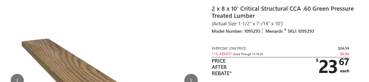

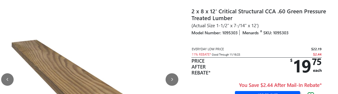

Marine grade PT is 2.4 as compared to the .4 deck material at the big box stores. Big difference. The stuff is heavy. Don't know what .8 is but anyone who builds docks or bulkheads in salt water wouldn't touch .4 or .8 stuff.
FWIW, I had no problem getting a quote on true 8x8 sized marine spec. 26' posts.
