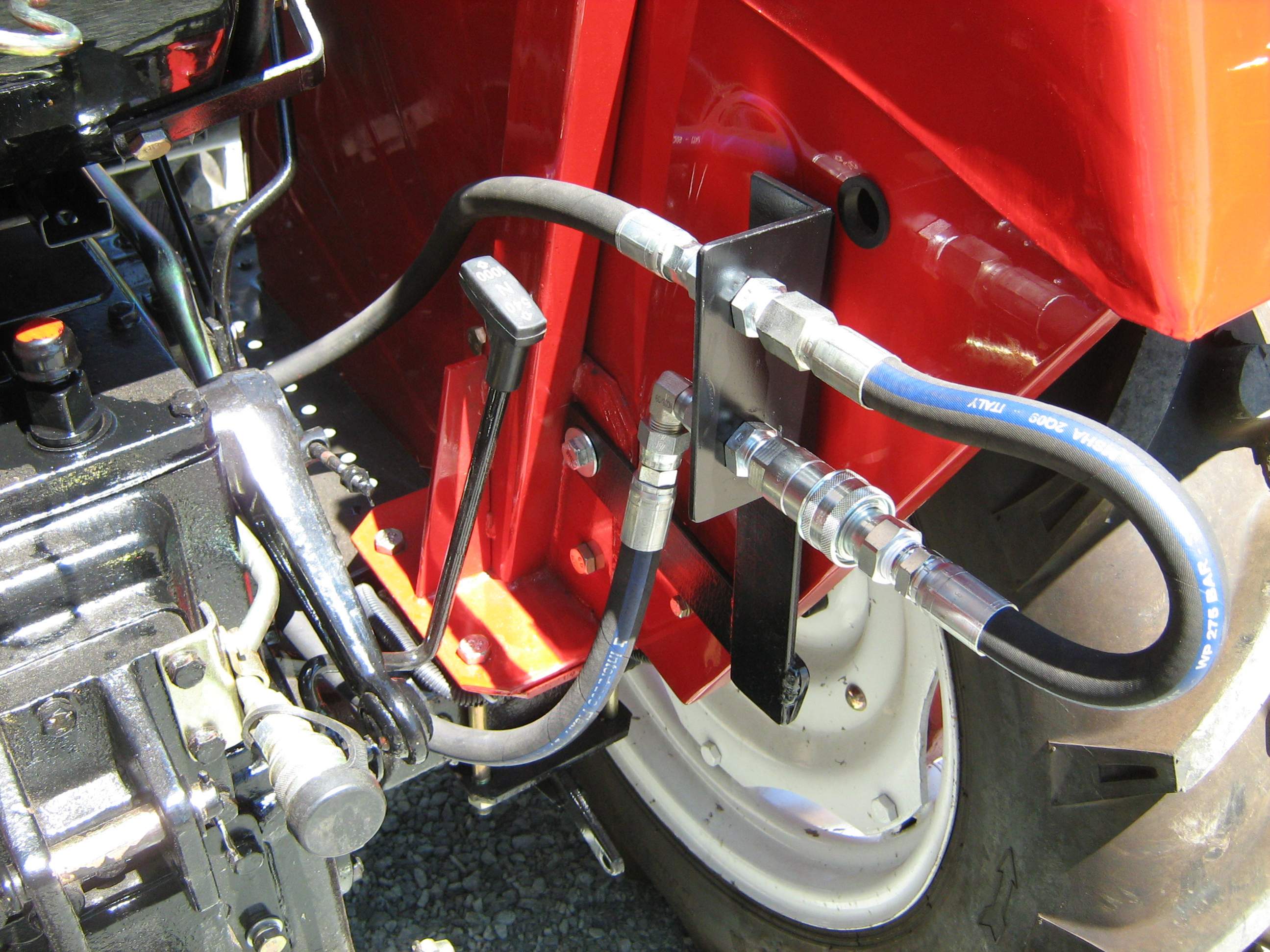

Tommy suggested I purchase Ronald's constant flow kit. I called Ronald and after telling him I was a tractor newbie, Ronald explained in great detail exactly what I could expect, with and without his product... sound effects included! I ordered the kit with the unpainted bracket.
I really cant say enough about the kit. It works as advertised. The instructions were the most detailed I have ever seen for any product of similar complexity. I'm not making fun here, but Ronald even tells you to hold a specific part while you tighten the nut! How detailed is that? Pictures, pictures and more pictures. My wife could have installed this kit following the pics alone.
To further dummy-proof the kit, Ronald has washers, standoffs, etc, already attached to the appropriate fittings and bolts. My Christmas Eve bicycle assemblies back in the day were far more confusing.
On my tractor, the longest hose to the diverter valve was a bit of a challenge, requiring me to pry one of the hard lines out very slightly to gain clearance (The supplied hoses are very stout/stiff). I considered routing the hose differently, but thought better. Ronald has obviously given much thought to this kit and his hose routing is ideal.

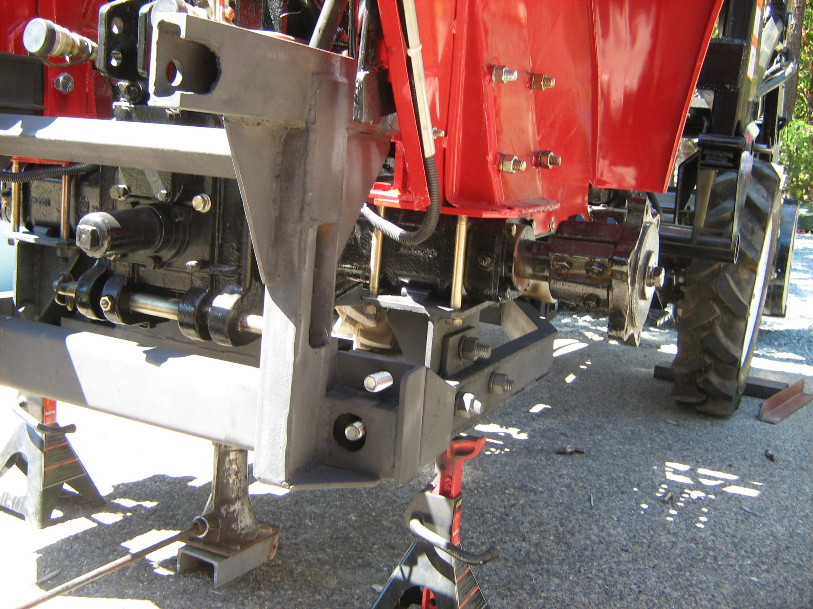

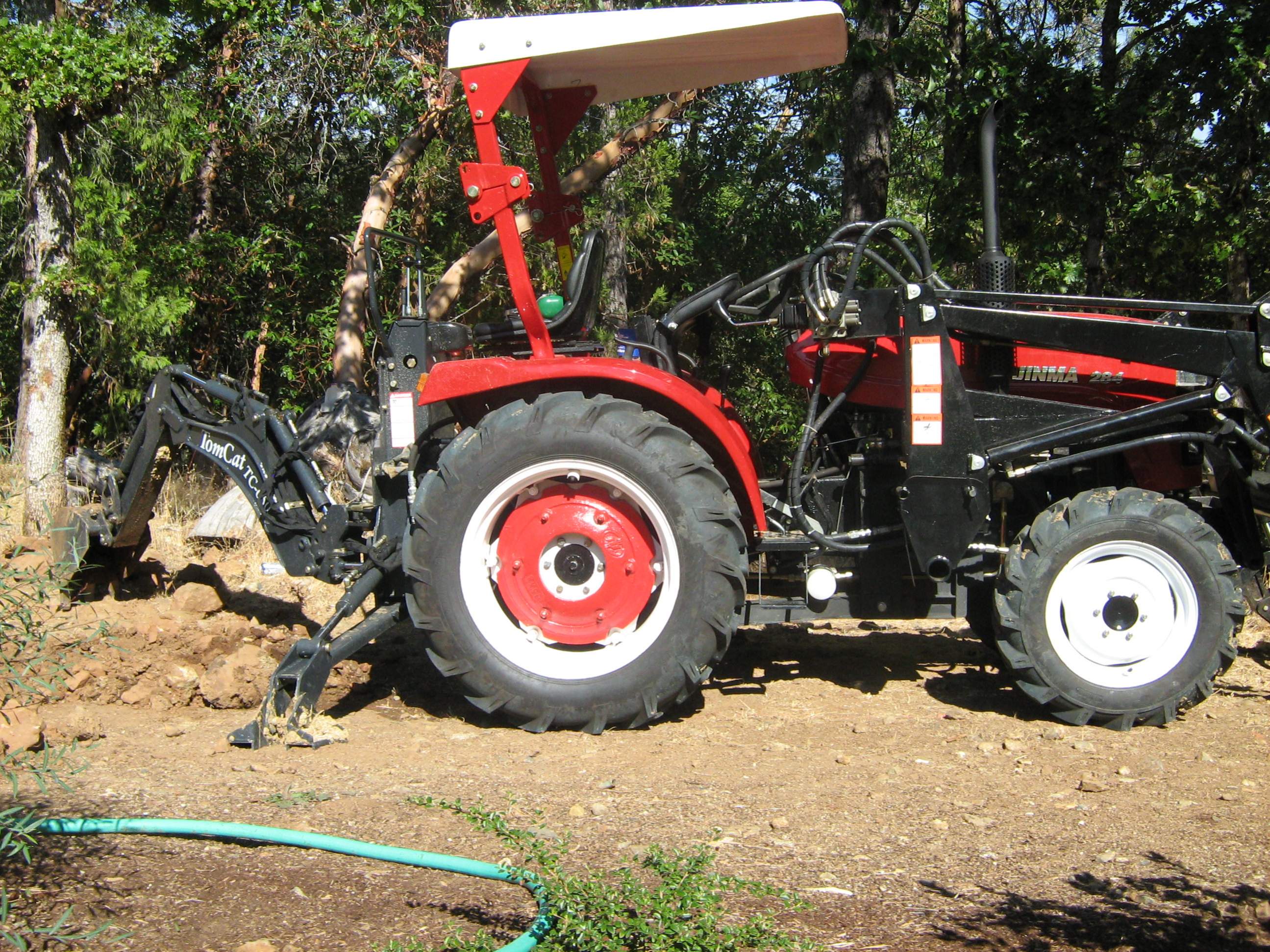

I have the two auxiliary QD's at the rear of my 284. The pressure side comes off the valve between your legs which can control the speed that the TPH raises. You can see that QD in my second pic.
As Ronald explained it, I could use these original QD's, but the hydraulic volume is so reduced due to the routing through the TPH valve, that I would not be happy with my B/H's performance.
Ronald's kit replaces a hard line from the diverter valve, which is the first valve after the pump and FEL circuit, and sends it straight to the B/H. The return line completes the circuit going back to the original hard line's destination.
Hope that was close and reasonably accurate. The kit I ordered is at the bottom of this page;

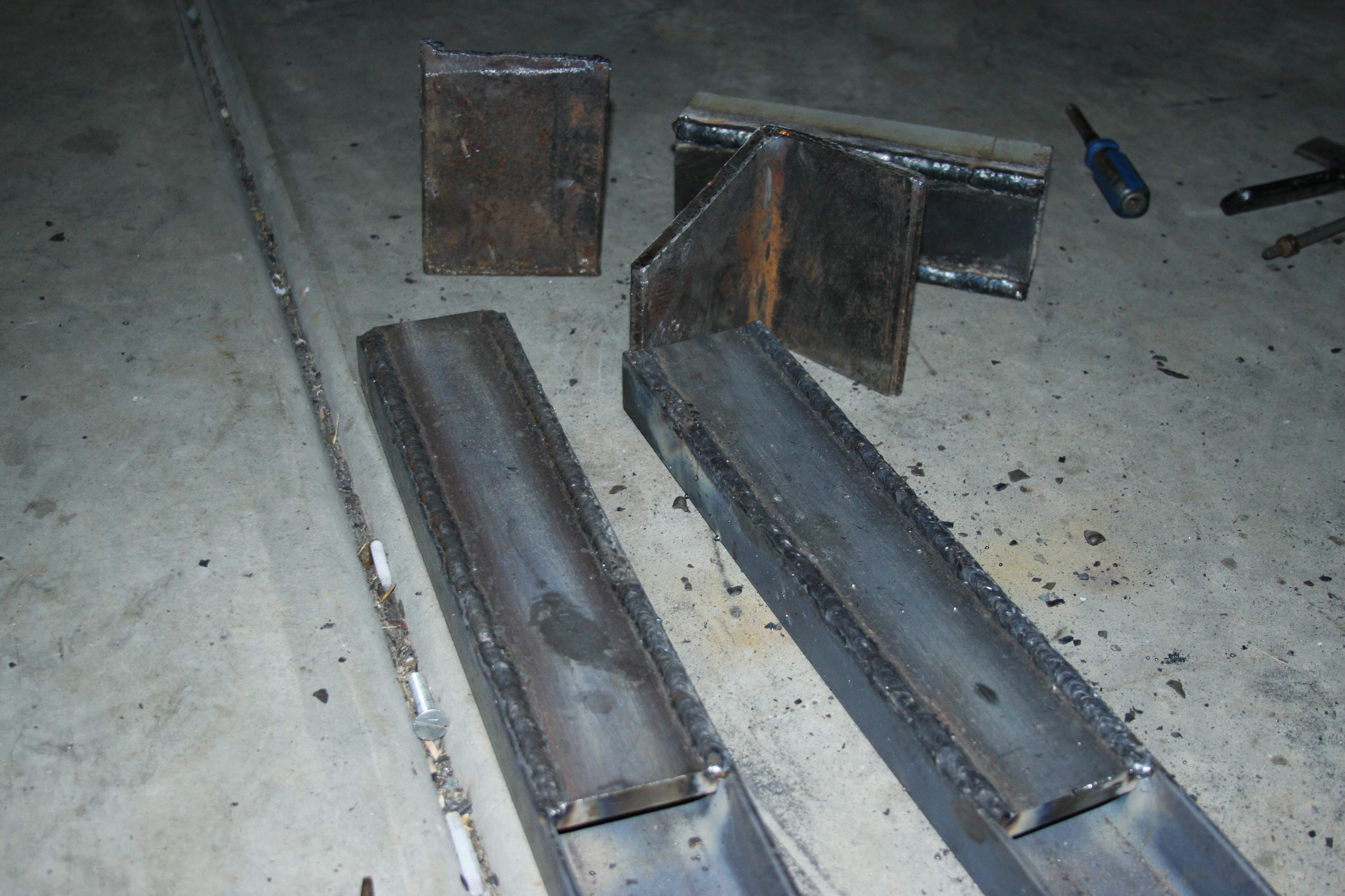

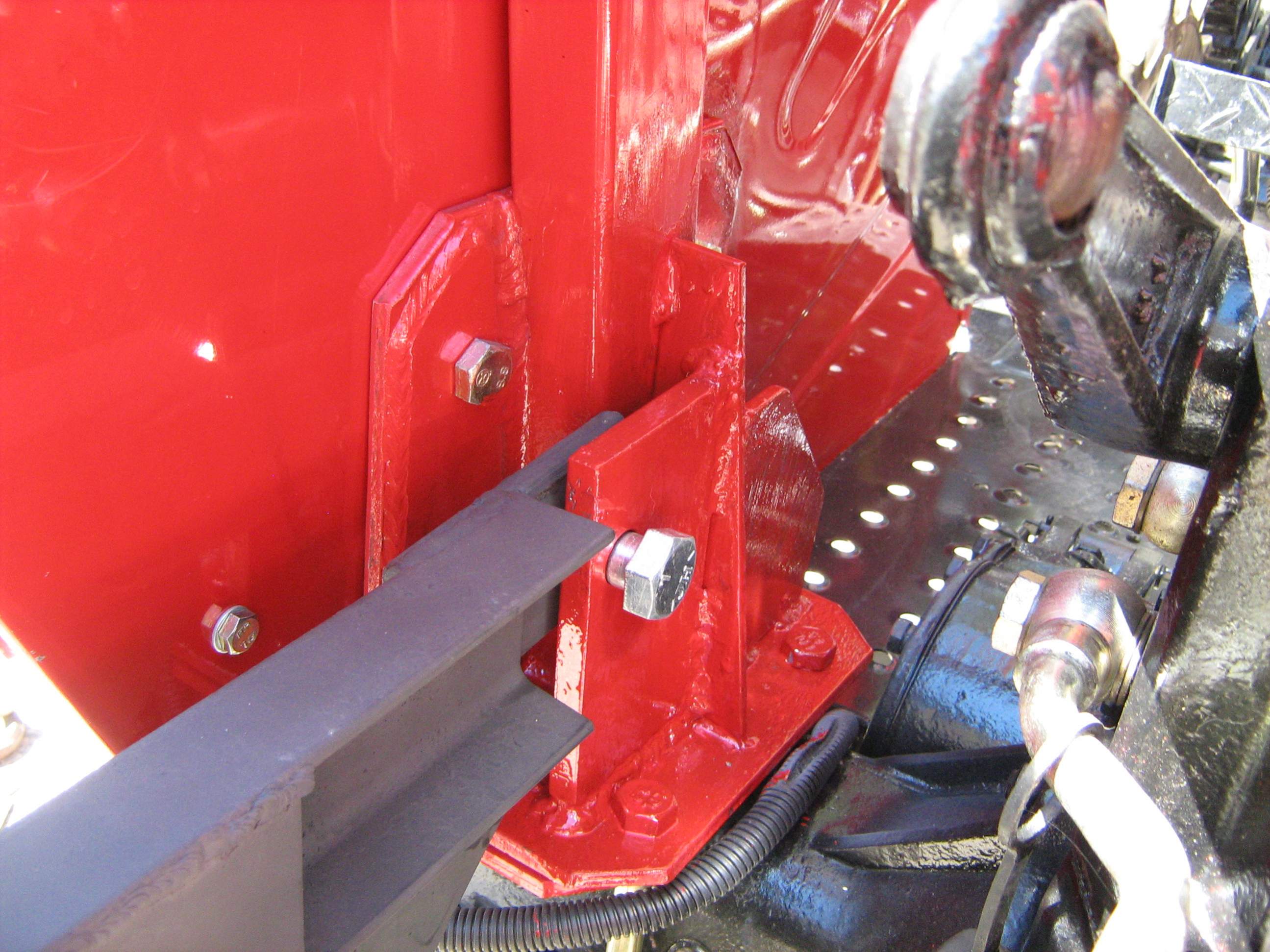

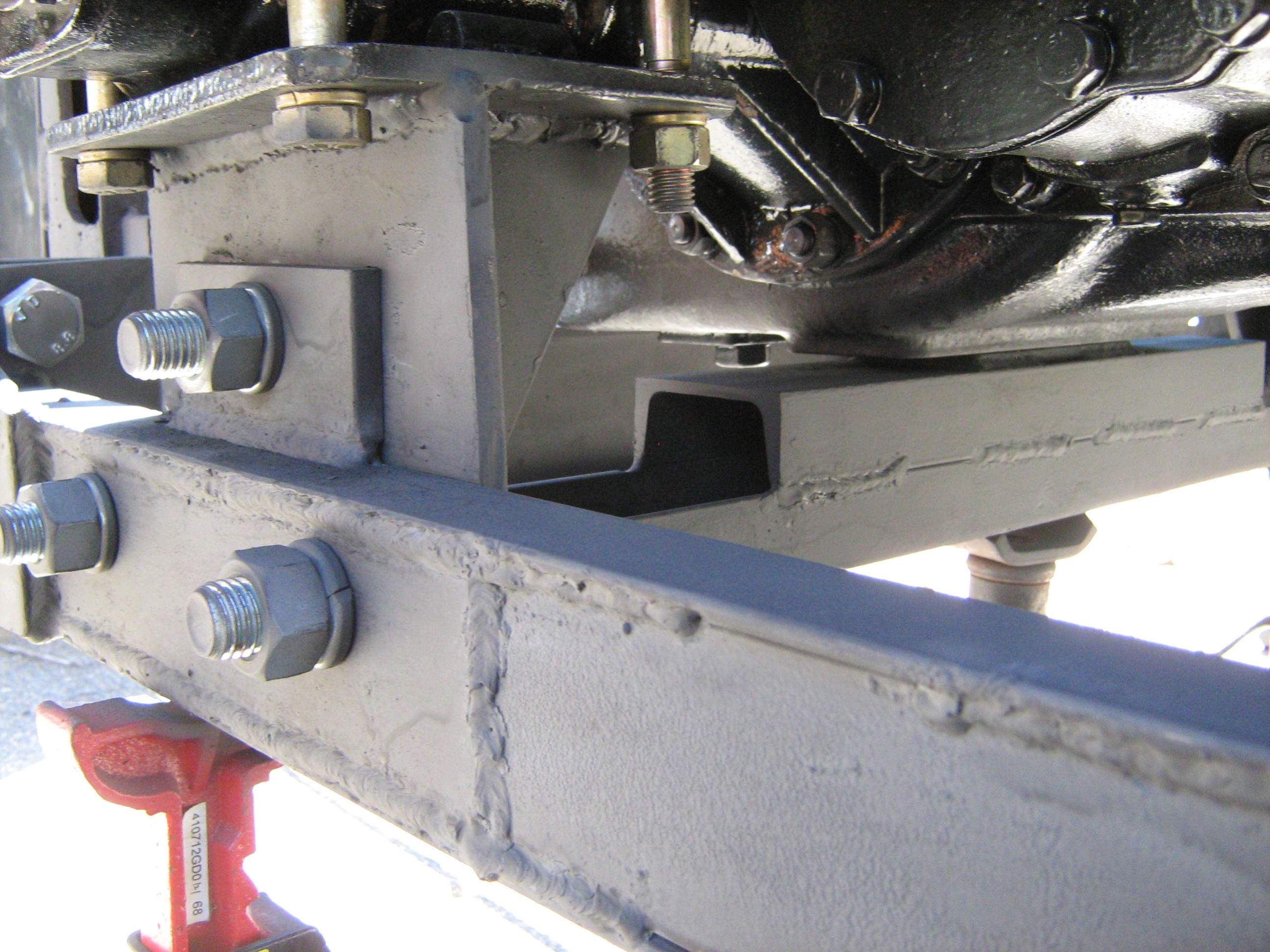

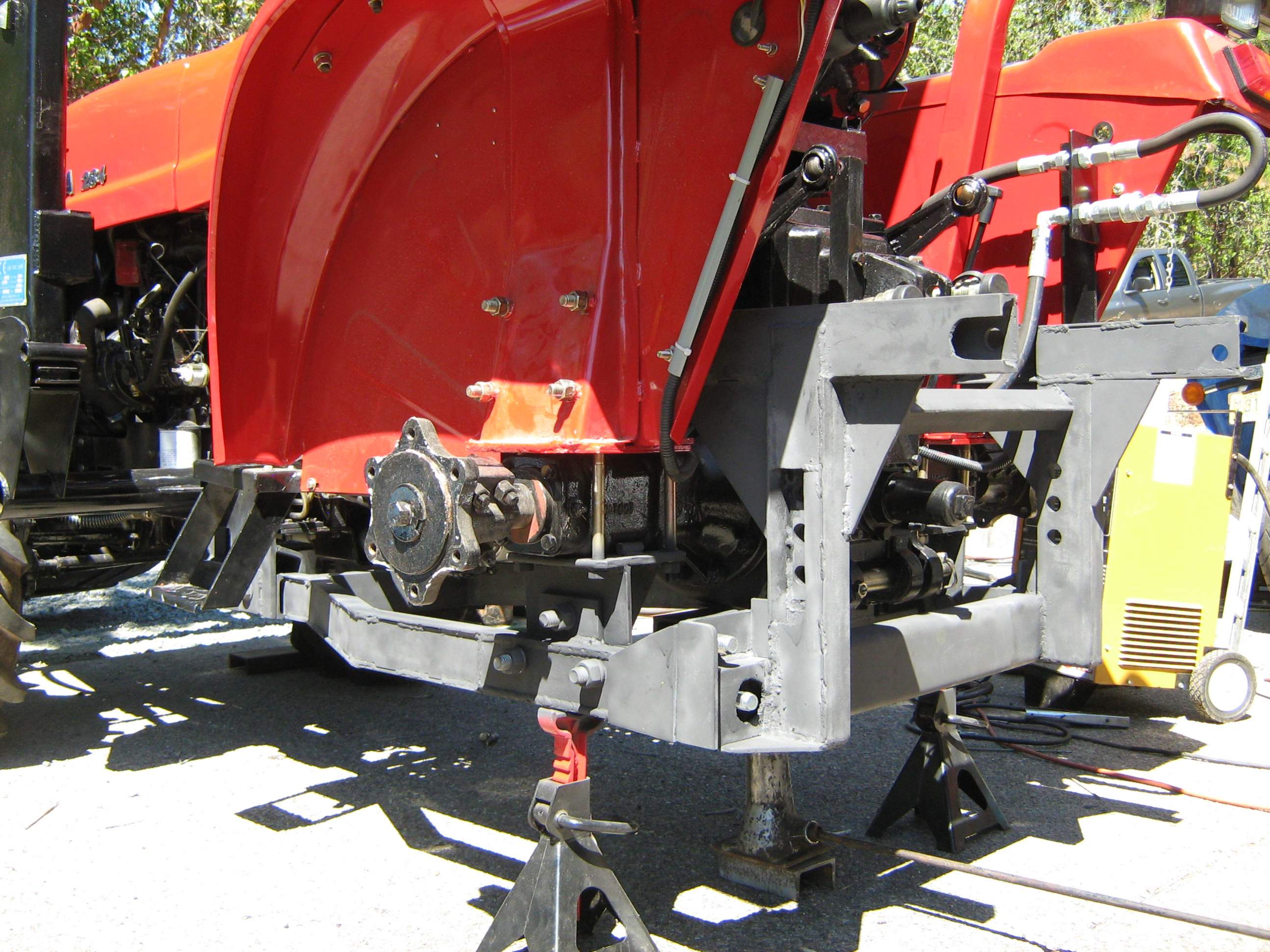

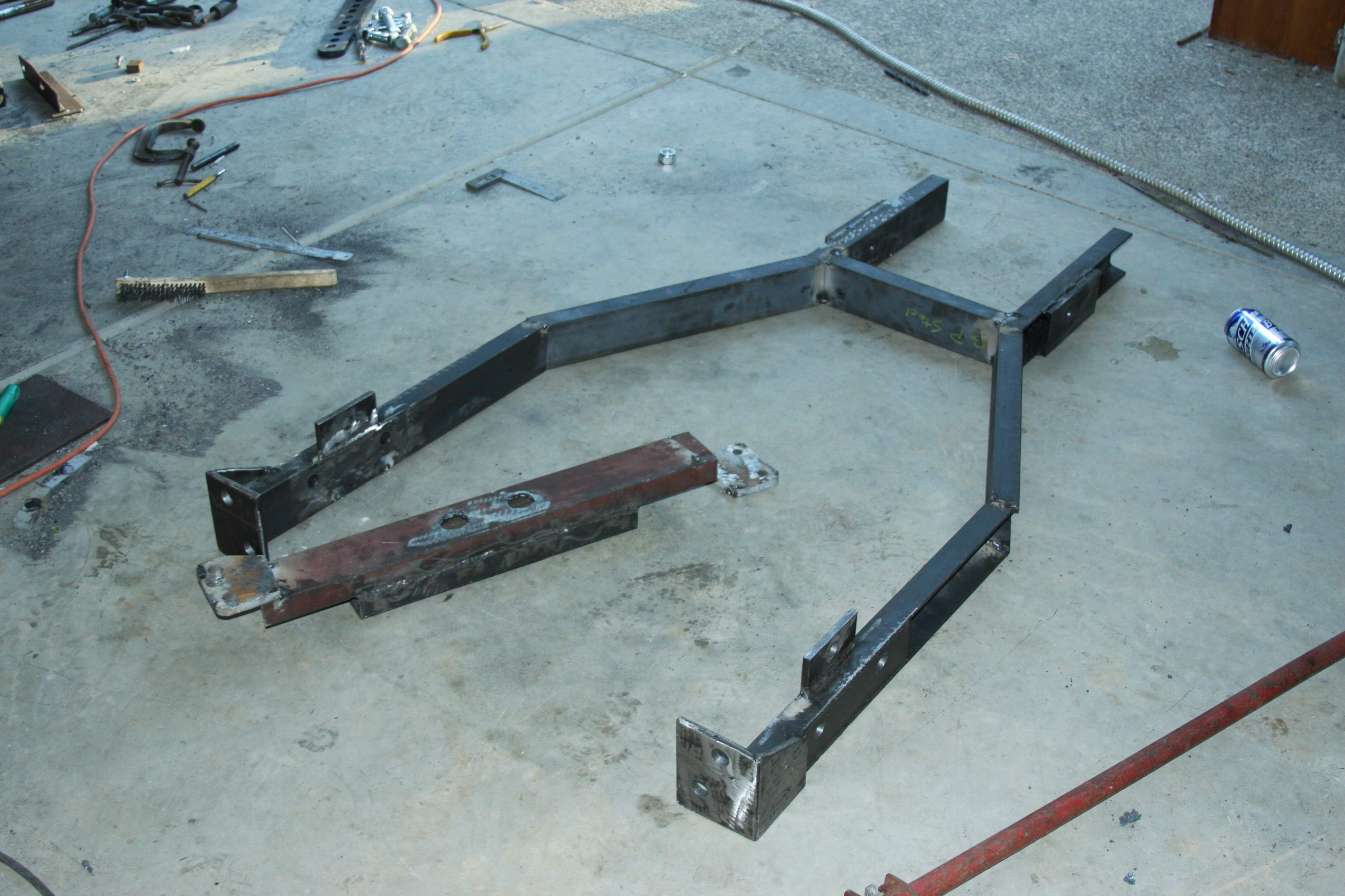

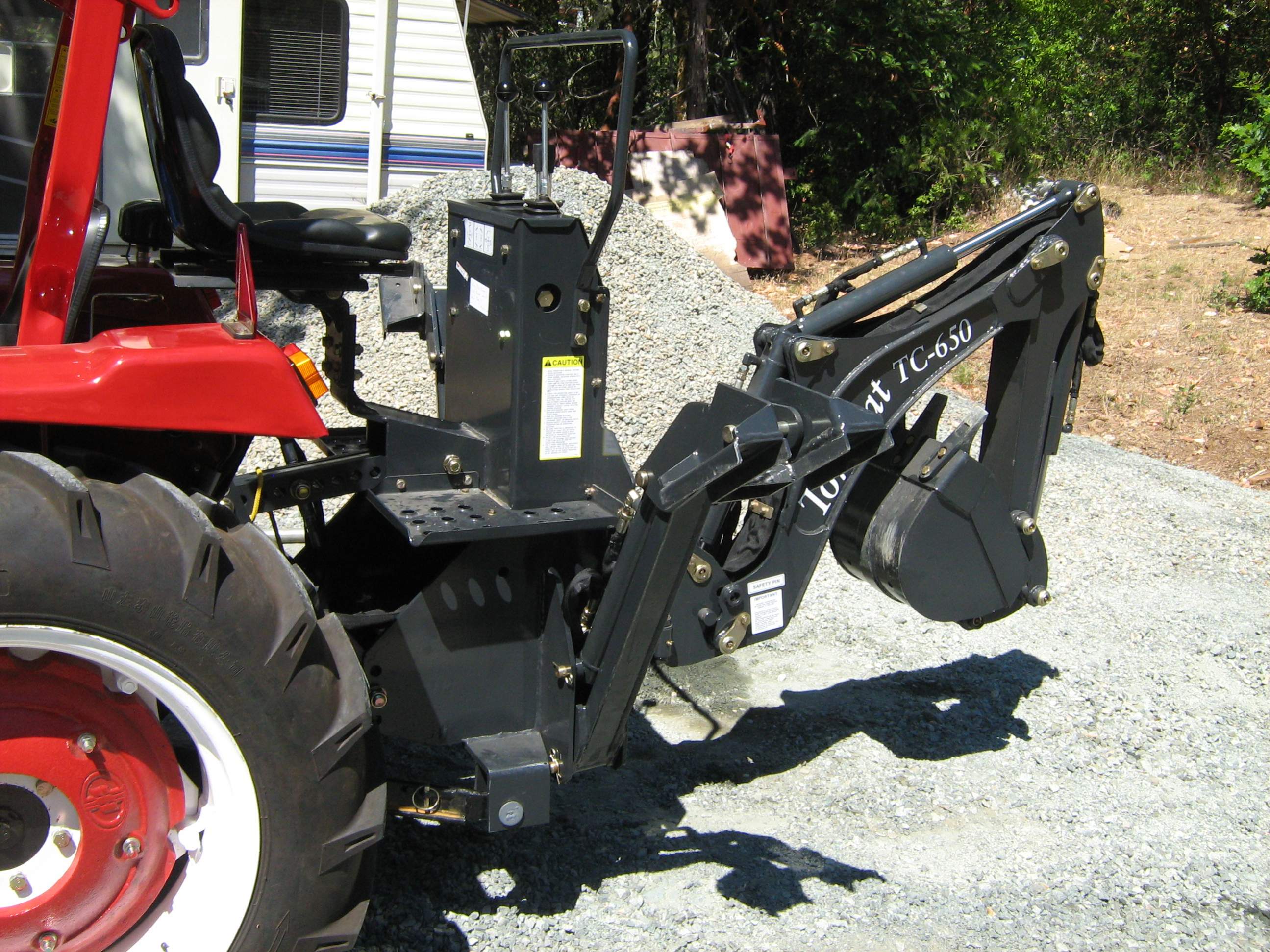

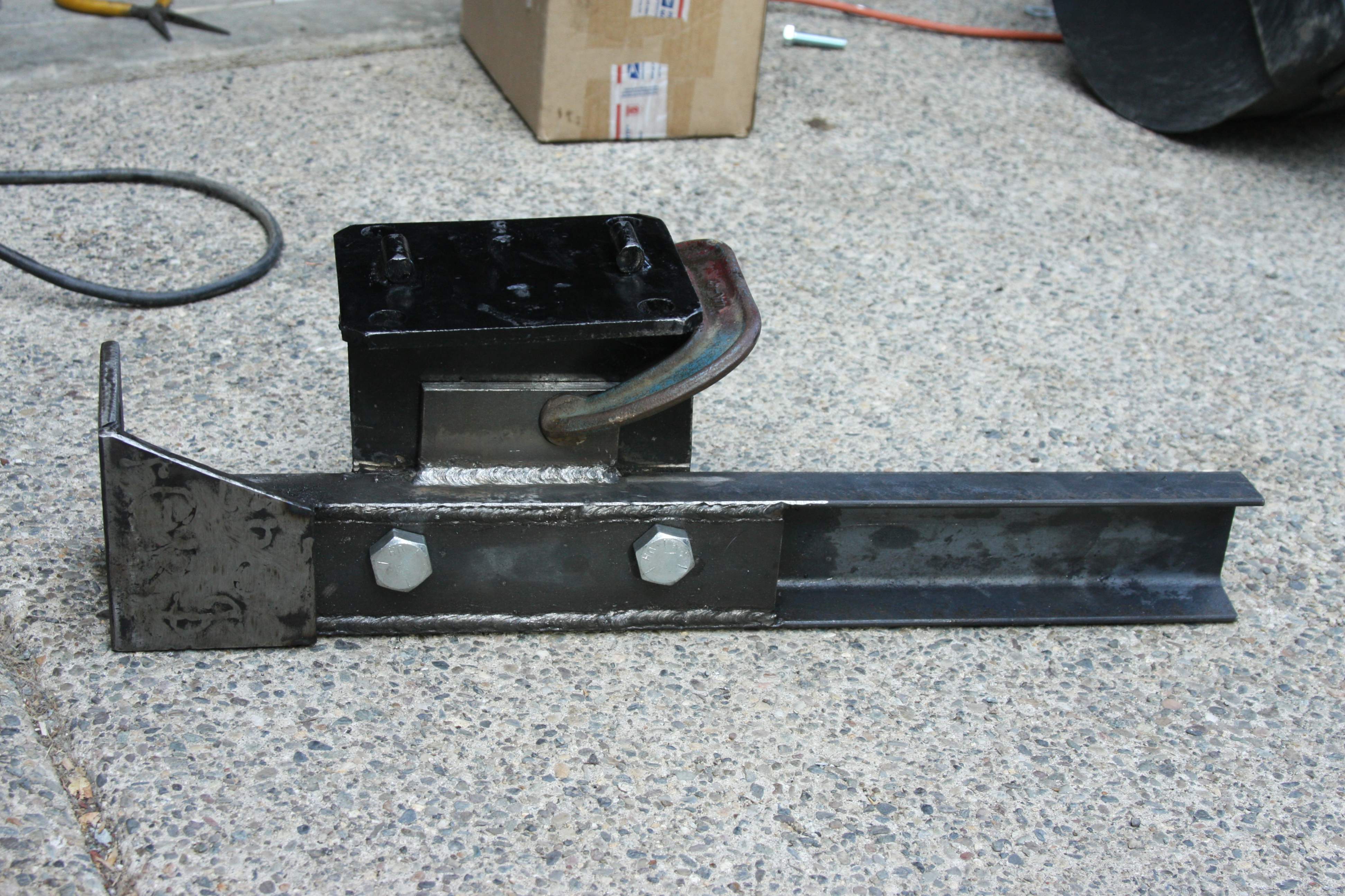

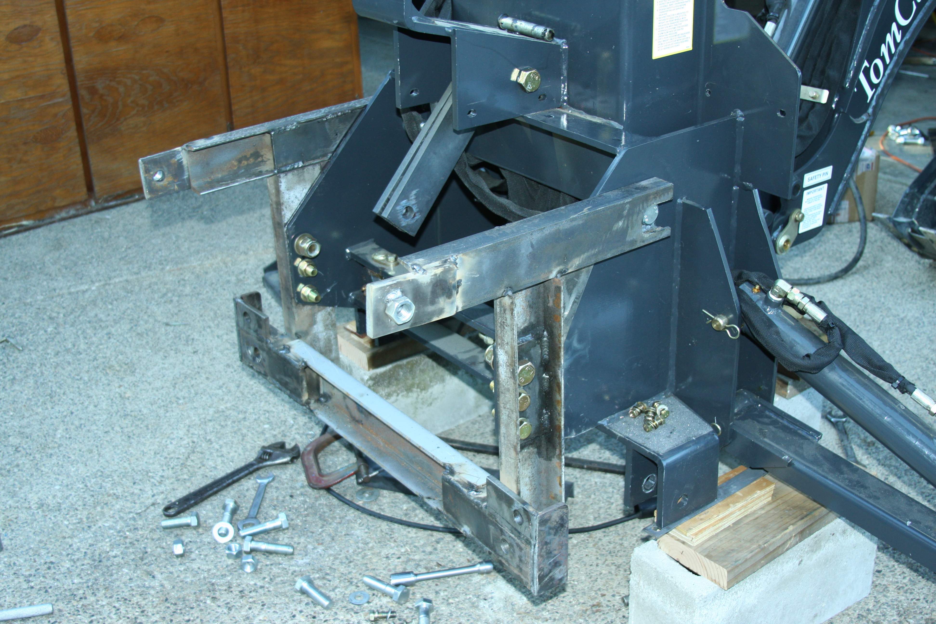

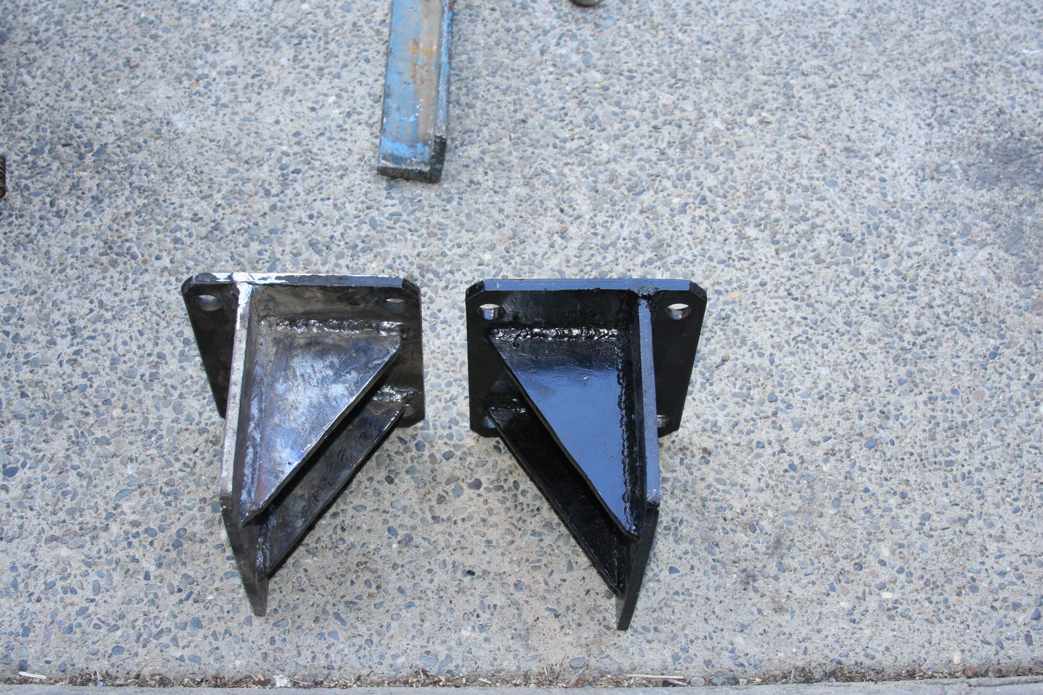

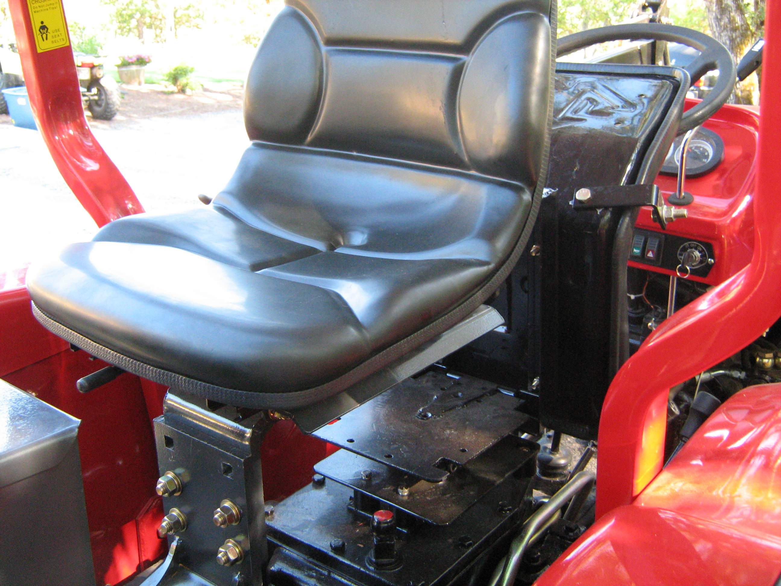

I completed my frame mount and have been able to give my "Tomcat" a good workout. I am very pleased with the BH. I did have an issue with the shared boom/dipper pin shearing after 10 minutes of use, but Tommy replaced the faulty pin and I have had many trouble free hours.
Never having owned a BH, I have no comparison, but I can't think of any improvement, other than the usual "Bigger, stronger". A tad faster might be nice, but it probably wouldn't be worth the increased wear and tear... this thing snaps to pretty quick as is.
I'm real happy with my mount. It has proven to be stronger than the hoe (My goal). I was able to mount much closer that the original 3PT, as can be seen in the pics. I did have to modify my tractor seat to get it this close. I'm hoping the fact that I extended the front of the frame to the engine mount/front rails, will prevent any load stress problems later. The frame stays on the tractor and separates from the hoe frame with 6 bolts, Fun project!
