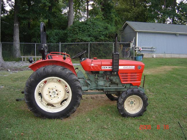

I too had no idea what he was talking about! I thought they all had the cast manifold, even the chineese replacement parts. I thought this pic was of your tractor California, till i read your post. I too have never seen one with this sheet metal cover?
I think what Bruce & myself are talking about is the muffler its self is cast . There is a cage around the muffler as well as the cast manifold
/ Considering a YM2000 purchase #43
ok, i see the picture again, the muffler looks cast. Mine is just stamped steel, heavy steel but still just like a normal tractor muffler. Its a china made repro i think.
/ Considering a YM2000 purchase #44
Yours maybe round . Where mine is rectangle & cast iron. Here's a pic

/ Considering a YM2000 purchase #45
Yea i knew which ones your talking about on the swuare ones. The newer model YMs i think had the square ones. That pic Cali posted shows what looks like a round cast muffler? But mine is round pipe that is reduced and welded. just like what Hoye lists and sells i guess for the ym2000. There all the same now as the repros. Really anything that fits on the manifold will work.

Muffler -- I went on Hoye and looked the other day for a replacement muffler and saw the round one and went "What?"
Mine is what looks like sheet metal (gray ... not painted black) like the picture posted above.

/ Considering a YM2000 purchase #47
Hoye is not making the mufflers to my knowledge, i think there buying them from the aftermarket, which i belive means they come from china. its basically the same muffler on probly some small kubotas and mitsus and probly isekis etc. So there is a strong market for them i guess, you can find them on ebay as well.
