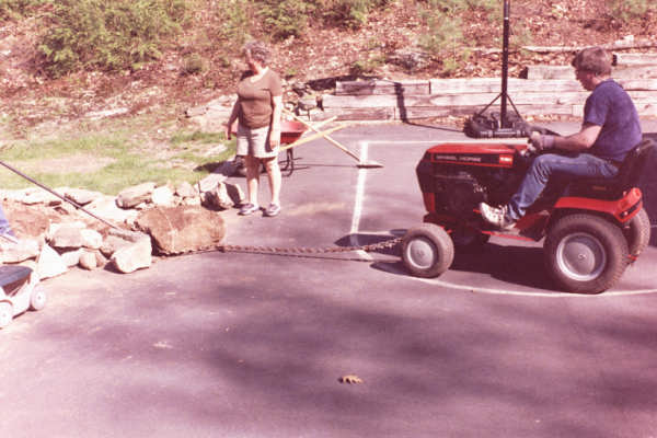

Thanks for all the replies. I appreciate it. Hazmat thanks for the offer. I have been to Chapperel's Milford area store. I like the NH Boomers. I was hoping to spend a little less. That was why I started to look at the sub compacts.
I have been looking at these things for 4 years so I don't have to rush into anything. But I have been seriously considering the PT422 now due to the sale price. I was almost ready to order and the cold start thread started. that gave me cold feet.
My wife is all for purchasing a tractor. She gave me the thumbs up last summer when we spent 2 hrs getting a large rock out of her rose garden. /forums/images/graemlins/smile.gif But I am the one dragging my feet now. Funny how things change.
The input on this thread has been very helpful and has alleviated some of my fears.
Thanks again. Phil
