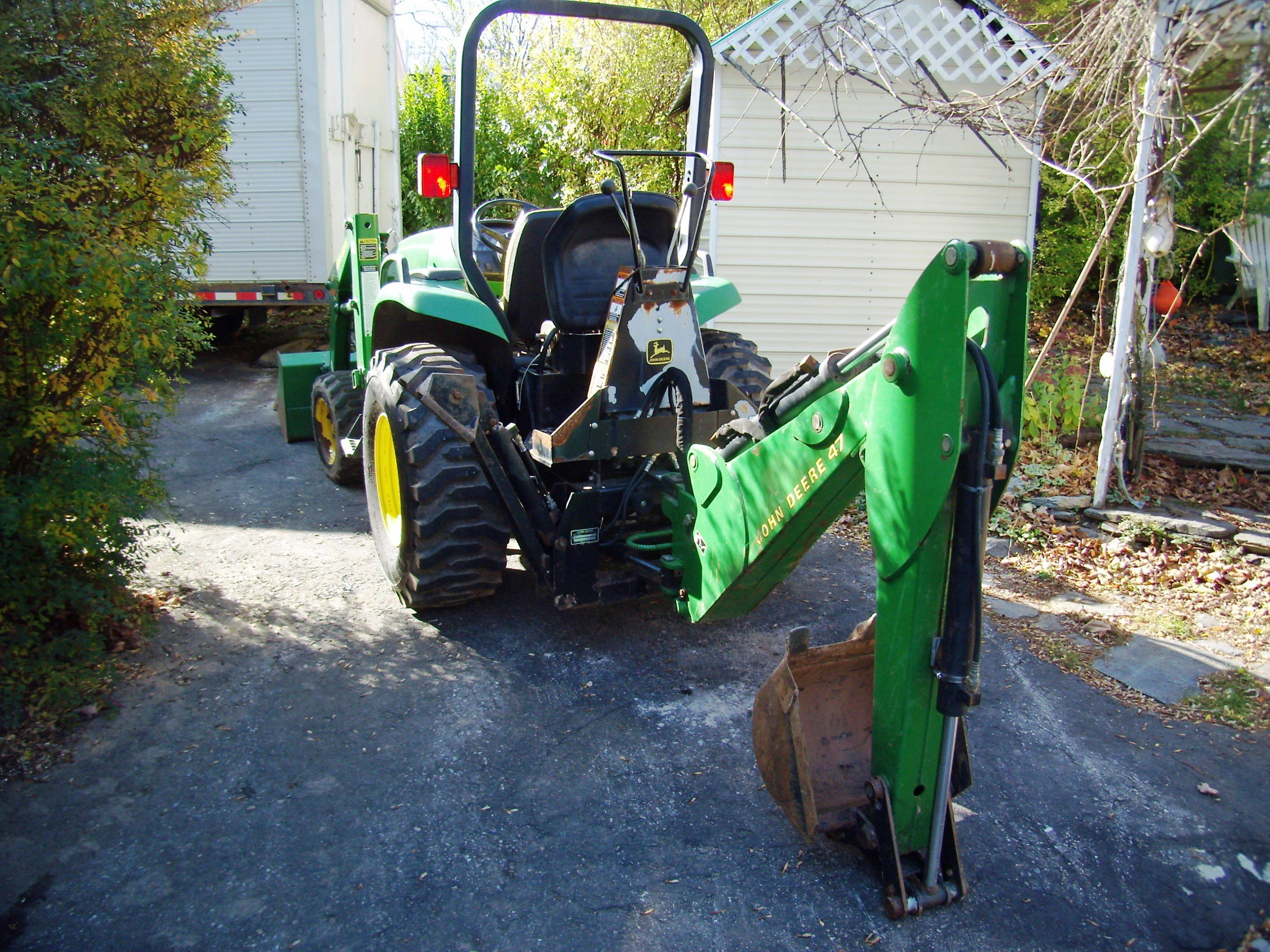

I found a 2001 4200 for sale locally. It has a loader and a backhoe on it. ~1200 hours. Hysdrostatic trans. Industrial tires. They are asking ~13k.
Is this the "right" tractor for me? What should I look for if I go check it out?

This might be a stupid question, but I just got off the phone with the seller and I asked if the 3-point hitch arms came with the tractor. He said he wasn't sure because as long as he has had it the backhoe was on. Could the arms be there, or do they have to be removed to install the frame mounted backhoe?

99.9% sure the lower arms as well as the top-link are removed when the backhoe is mounted. Other than that, it does sound like a good deal.
What loader is on it-the 420 or 430?
The BH should be a #47 I think...
/ Considering a 4200
Loader is 420, Backhoe is 47. Are those good?

The 420 & 47 aren't heavy duty but they are adequate for your requirements. The seller should provide the 3-point setup since that's pretty much standard equipment that should come with all tractors. If he doesn't have the top-link and arms, I wouldn't buy the tractor or I would find out from a JD dealer how much new ones would cost then ask the seller to reduce his price by that amount.

I am assuming since the hitch arms aren't there, this is a subframe 'hoe
/ Considering a 4200 #12
The arms are removed to mount the Backhoe.:thumbsup:
The backhoe is a subframe backhoe. Which from my limited research seems like a good thing.

you will want a subframe hoe. A 3PH one one that size tractor will get you into trouble. The hoe comes off in a couple of minutes, but I have never been able to get it back on in less than 10-15.
Once you have it off, the 3PH arms will take another 10-15 to re-install.
Unless the owner made his own subframe or adapted the 48 subframe, the 47 had no subframe available from Deere.

Interesting. It is definitely a 47 backhoe on a 4200. The seller said it was subframe mounted. He said "it isn't some weak POS 3 point mount, this is subframe, the real deal."

Oh wow! Thanks for that picture!!!!! I've been searching the internet for weeks looking for that exact shot! [Wanted to compare an 8B with my subframe to the stock 47.]
And back to your tractor.... the 47 is mounted with what they call Rockshaft Assist Mounting Plates. Its an in-between mounting setup. Stronger than a 3pt mount, weaker than a true subframe. Whether it should concern you is up to you.... do a search and see what you think for yourself. Lots of people have had zero troubles. A handful have the opposite experience.
