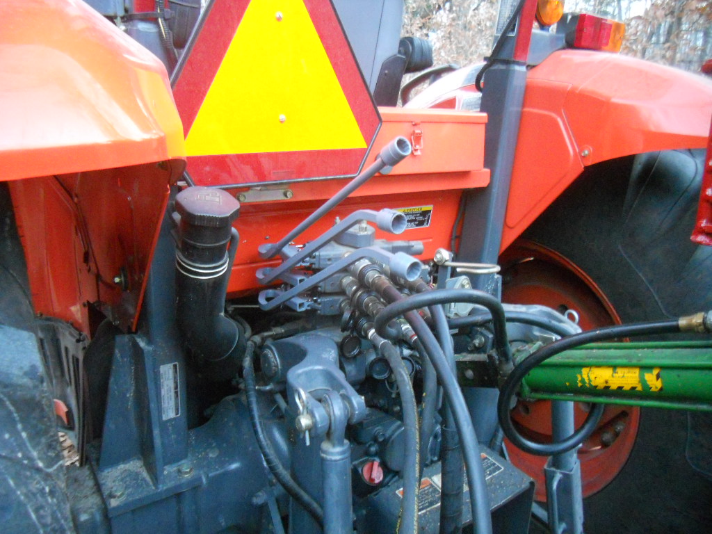

If being in relief so much is a problem, you could add a second remote with the valve mounted on the back of the tractor where it's handy when using the winch. It'd be plumbed serially after or before the current remote.
I'd bite the bullet ($$$) and add the extra remote. I made rear valve controls that work with the cab controls for my remotes, real handy. Just piggybacked off the mechanical linkage.

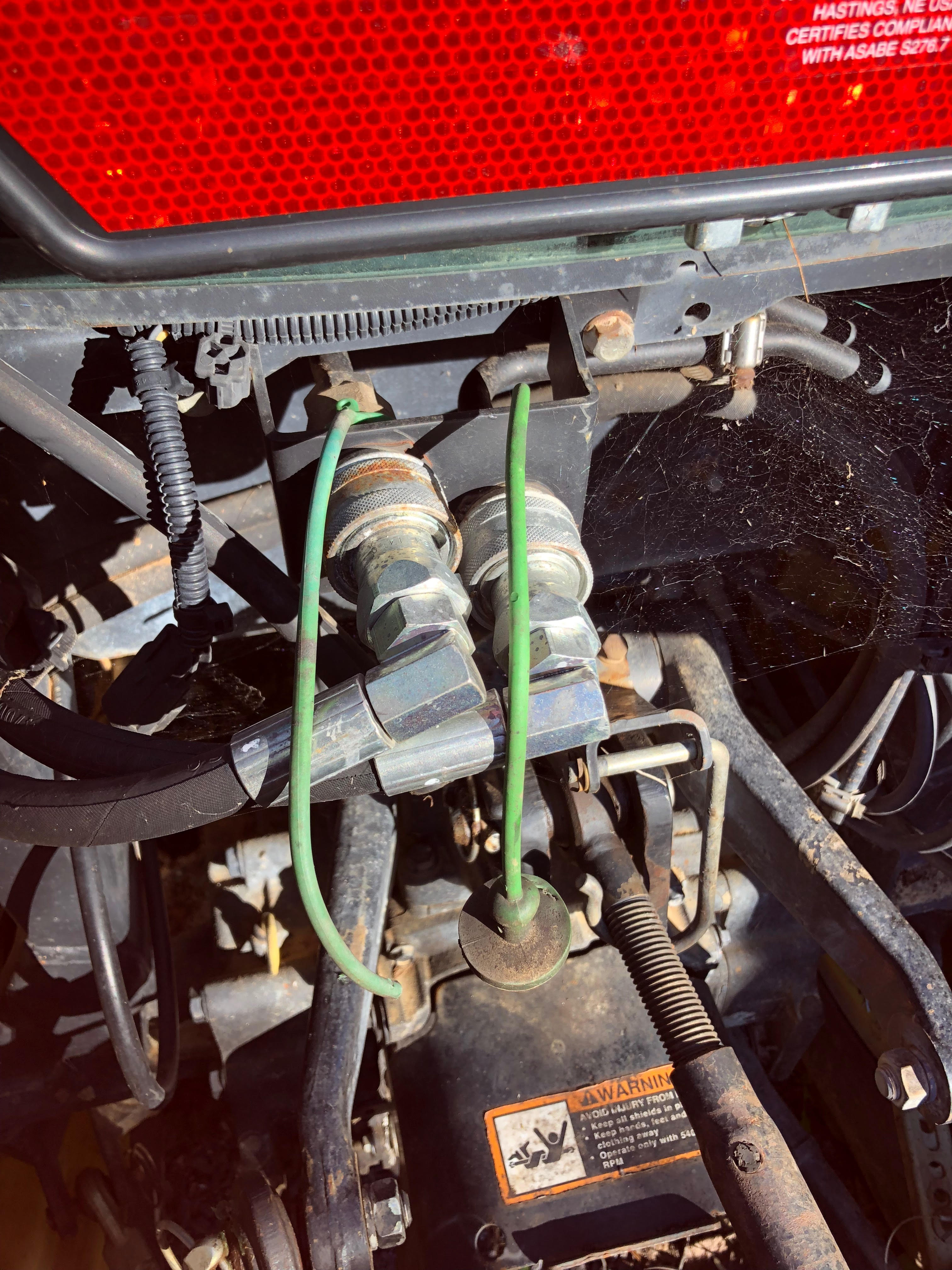

/ Connections for Hydraulic winch
Here are the connections I have now for the 4:1, I could not attach to original from mobile website.Remote.jpg

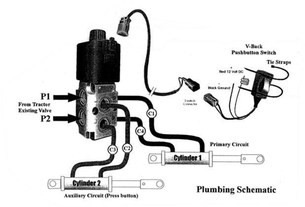

/ Connections for Hydraulic winch #8
To relate the diagram below to the OP's query...replace the dialog as follows:
P1 and P2 get connected to the existing remotes
C1 and C4 get connected to the 4:1
C2 and C3 get connected to the winch
The push button gets wired and run to the existing lever/joystick...
In normal operation when the lever/joystick is activated it operates the 4:1
When the push button switch is engaged and the lever/joystick is activated it operates the winch...
With this setup the push button switch would need to be held in a closed (engaged) position when the lever is in the detent position to keep the winch working... reversing the C1/C4 and C2/C3 working lines would solve this issue but the push button switch would need to be pushed when using the 4:1
