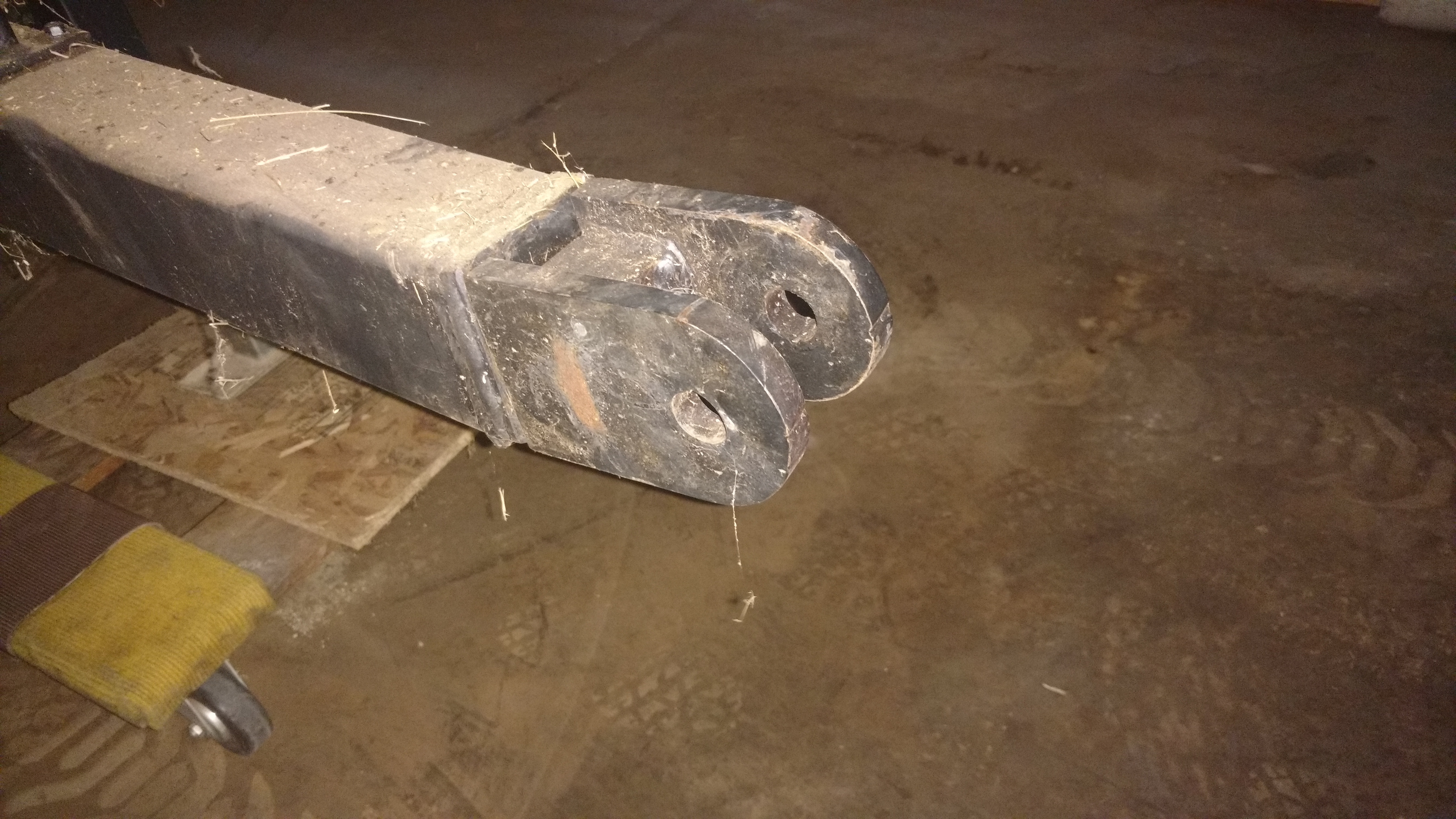

I bought a Berkelman off road dump trailer a while back. I am just now wanting to put it into service for some firewood work.
I went to connect it to the tractor and ... whoa ... I'm not sure how to do it? Here is a pix of the front tongue of the trailer. The end section that will take a pin will spin 360 degrees?
How would you connect it up?

Must be so if the trailer flips it won't flip the ATV?
On edit: Sorry I didn't know you have never used your draw bar before, I thought you were asking why it spins 360..
   / Connecting non-standard hitch to my tractor #3
That's a standard draw bar setup. Just slip the drawbar in between the forks and slip a pin through it.

Thanks! I've attached implements but never used a drawbar. Now to see if I have one ....

If you don't have one of these sticking out from beneath the rear axle, you can purchase one of these and attach it to the 3 pt.

Thanks! I know I have the second bar that is pictured. I'll connect it up tomorrow and see how it fastens up!
   / Connecting non-standard hitch to my tractor #7
If you use the 3 point drawbar with a trailer, you need to chain the 3 point arms down or you can get in a situation where the trailer lifts the arms along with the bar. A belly bar is the best way to go with it.

You'll be more stable over rough/uneven ground if you go with a draw bar.

UPDATE: I found my (cab) tractor has a belly bar. (Did not check the SCUT yet.) It was pushed all the way forward, invisible unless you crawl under the tractor. I extended it backward and it will be the perfect matchup for the trailer. Thank you all again.
