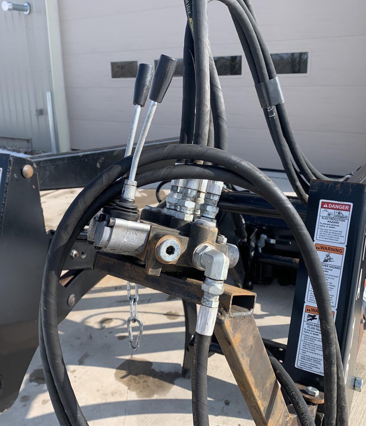

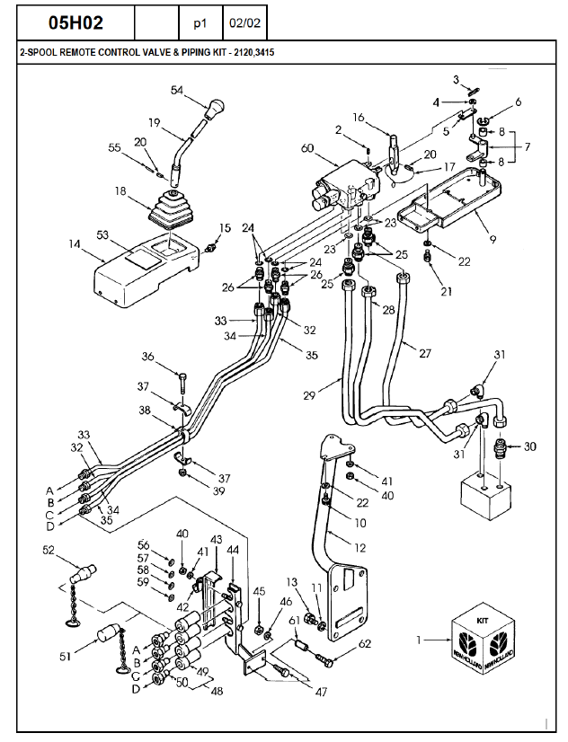

Just purchased a used Westendorf loader to mount on my NH2120. The NH has an existing 2 spool remote control assembly on it (diagram attached). 3 lines run in to the valve assembly and 4 lines run out to the implement. The Westendorf has an 2 lever control mounted to the loader with 2 hydraulic hoses to be connected to the hydraulic system (see pics). Is it safe to assume that one of these hoses is a return to the reservoir and the other to power the hydraulic cylinders? My question - how do I connect these to the tractor's hydraulic system (given that there were 3 lines running into the NH 2 spool valve assembly and only 2 lines running into the Westendorf valve assembly)? Thanks in advance!

You say your NH has an existing 2 spool remote,
does this go to rear remote quick connects?
or is this a loader ready valve with a joystick?
   / Connecting hydraulics for a Westendorf loader on a NH2120

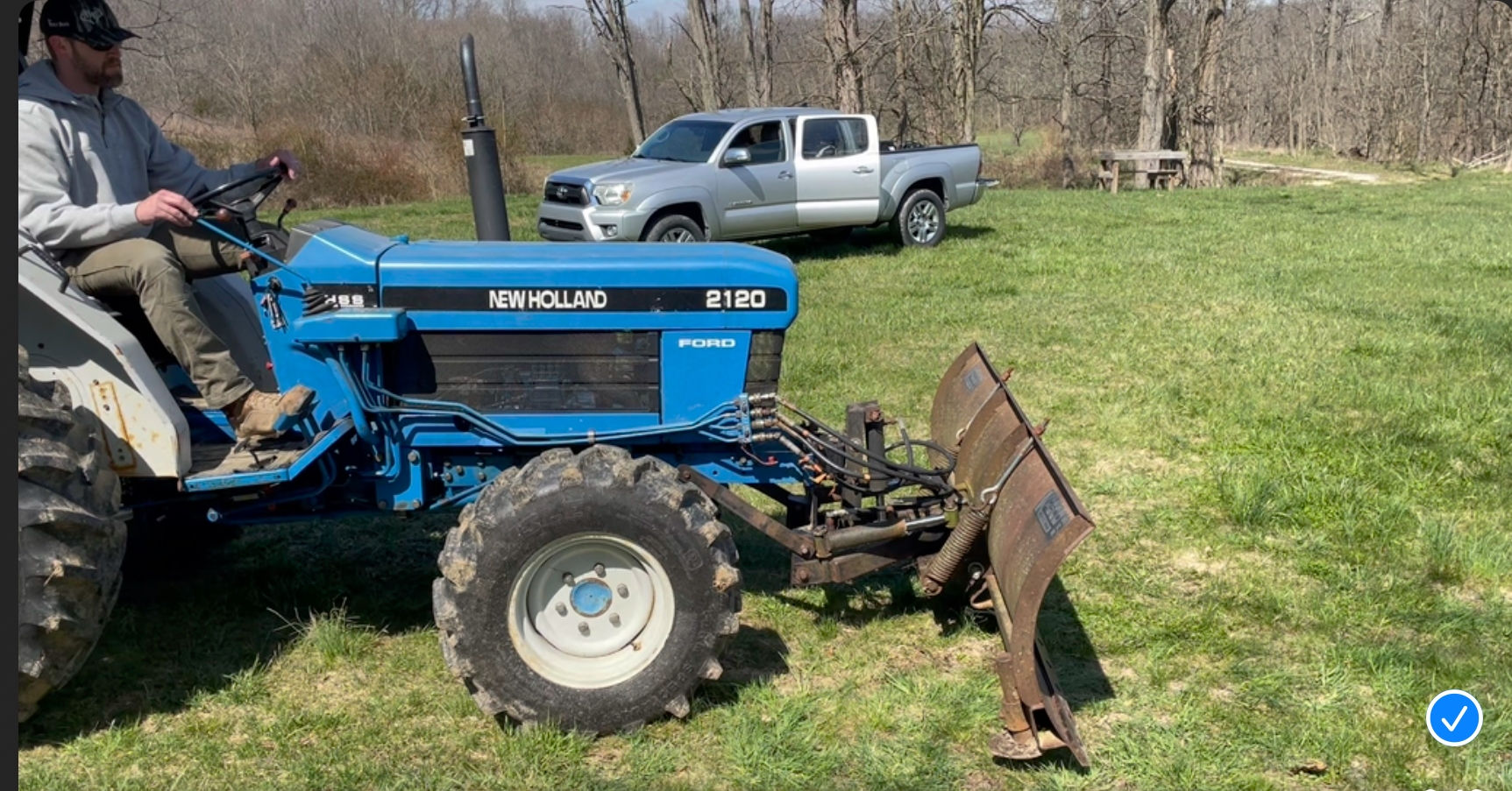

It is a loader ready valve with a joystick. The tractor previously had a snow plow blade on it. I'm replacing that with a loader.

The difference between the two valves is power beyond. The one on the tractor has and needs 3 hoses because the third hose feeds the remote valve or 3pt valve. In order to use the valve that came with the loader you would need to add a power beyond sleeve and a third hose.
Thank you K5lwq. And after looking up the Summit Hydraulics spool valve (that is installed on the loader) I see that there is a 3rd port for power beyond. Just have to decide if having the newer valve is worth the work to modify (the valve on the loader is 2 years old while the one on the tractor is 28 years old).
