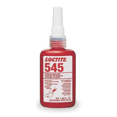

I replied to your original post with info about NPTF threads. Others posted with recommendations about different products for sealing. I mentioned that you might find galled threads after disassembling NPTF threads.
For sure teflon tape can gum up the works if applied incorrectly. I have found myself that Loctite paste and liquid thread sealing products are less likely to be applied incorrectly than teflon tape. It is a generic issue. I believe this is because it is so easy to get the tape too close to the end of the threads. People feel that they need to have that teflon tape applied right to the end of the thread. This tape then extrudes past the end of the threads when tightened and can then end up in the fluid. But when folks use some sort of paste or liquid thread sealant they seem to understand that it should not be applied so that it flows past the threads. Also, the paste and liquid sealants are not like pieces of tape that can clog stuff or prevent valves from sealing etc. because the tape is a solid.
My personal opinion is that whenever a tapered thread is used it should be used with either a thread with teflon tape or some sort of thread sealant. I like Loctite products the best but there others available that are just as good. And maybe better.
I use thread sealants and thread tape because it helps with preventing galling. This can affect sealing the first time the threaded components are assembled as well as any subsequent disassembling and reassembling. Galling is a serious issue and is a reason for many sealing failures of tapered threads.
The only drawback to anything that lubricates the threads is that the lubrication makes it easier to turn the threaded parts and can result in parts being over torqued.
