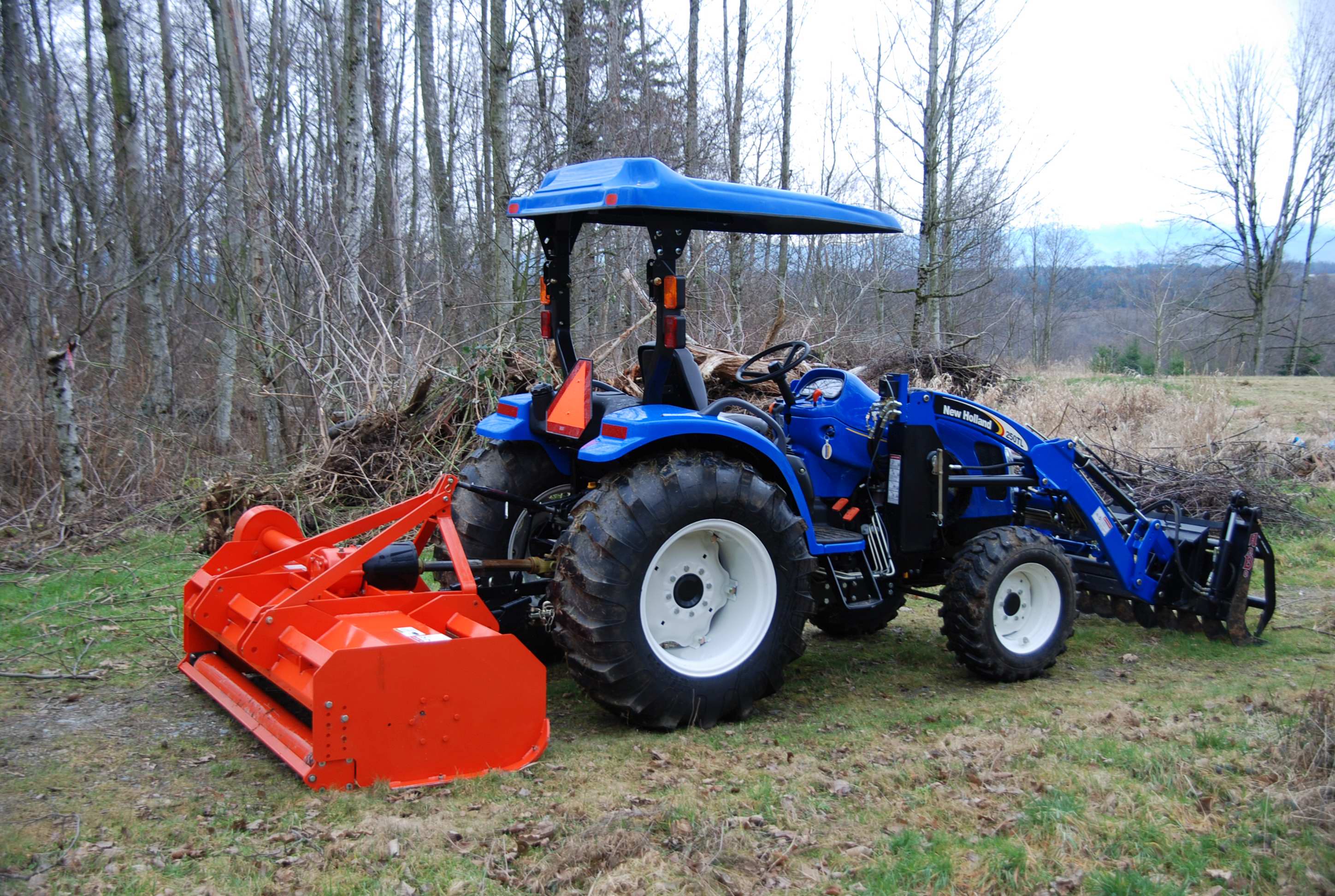

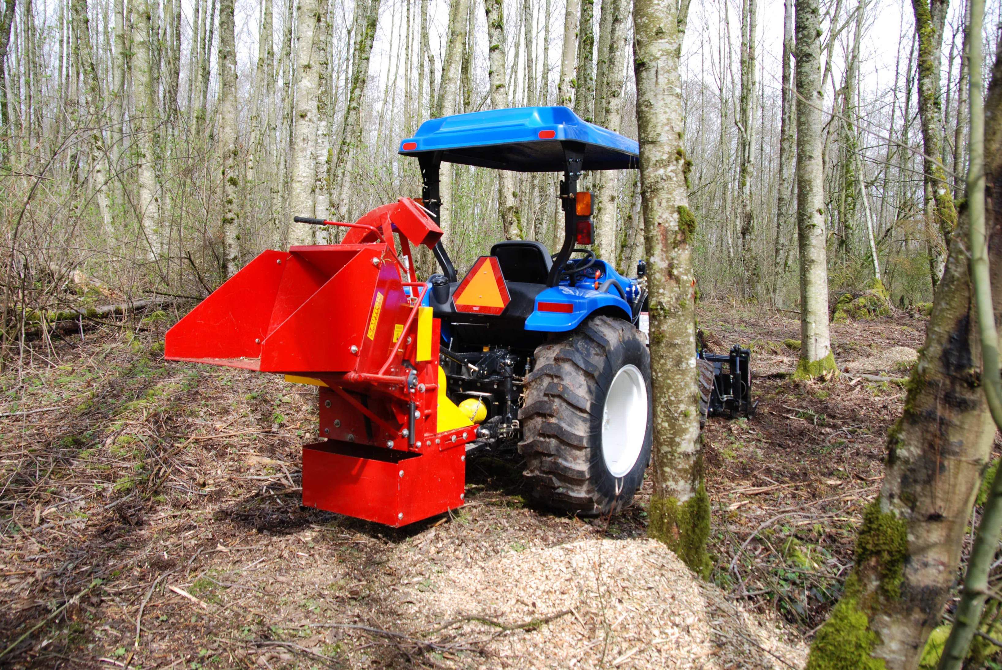

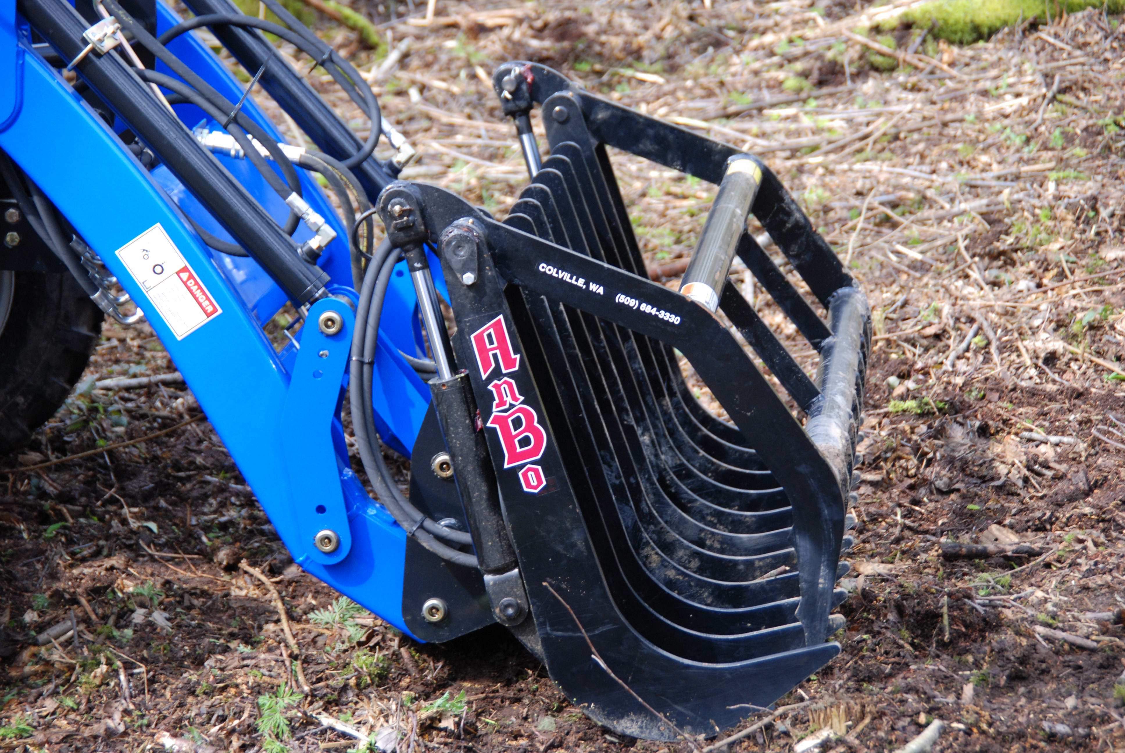

What Implements are you considering, or do you already have what you need? The grapple is one of my favorite implements and I use it all the time, mainly in the woods moving wood and removing brush. I had a canopy on my first tractor and really liked it, won't own another tractor without one. Chipper is great keeping the forest/brush cleaned up. If you have a field, you can find lot's of post on flail mowers, brush hogs and finish mowers. Flails are the most expensive, but depending on what you are using them for, can be a great choice.
You may want to think about adding them to the purchase, you can usually get a better price. It's just hard to have such a big bill all at once. When my wife said go get it, I wasn't sure when I would get back to that well :)
