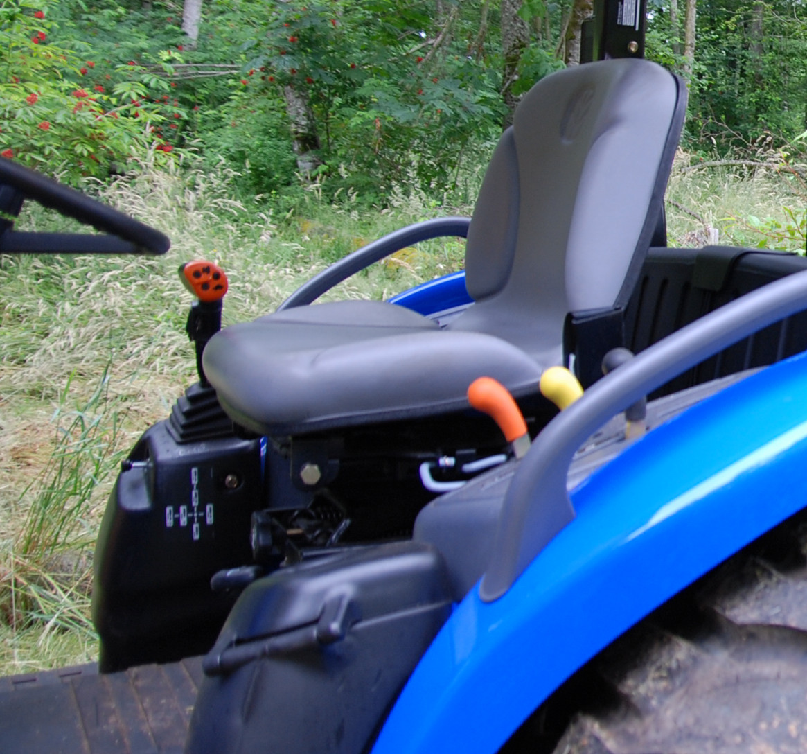

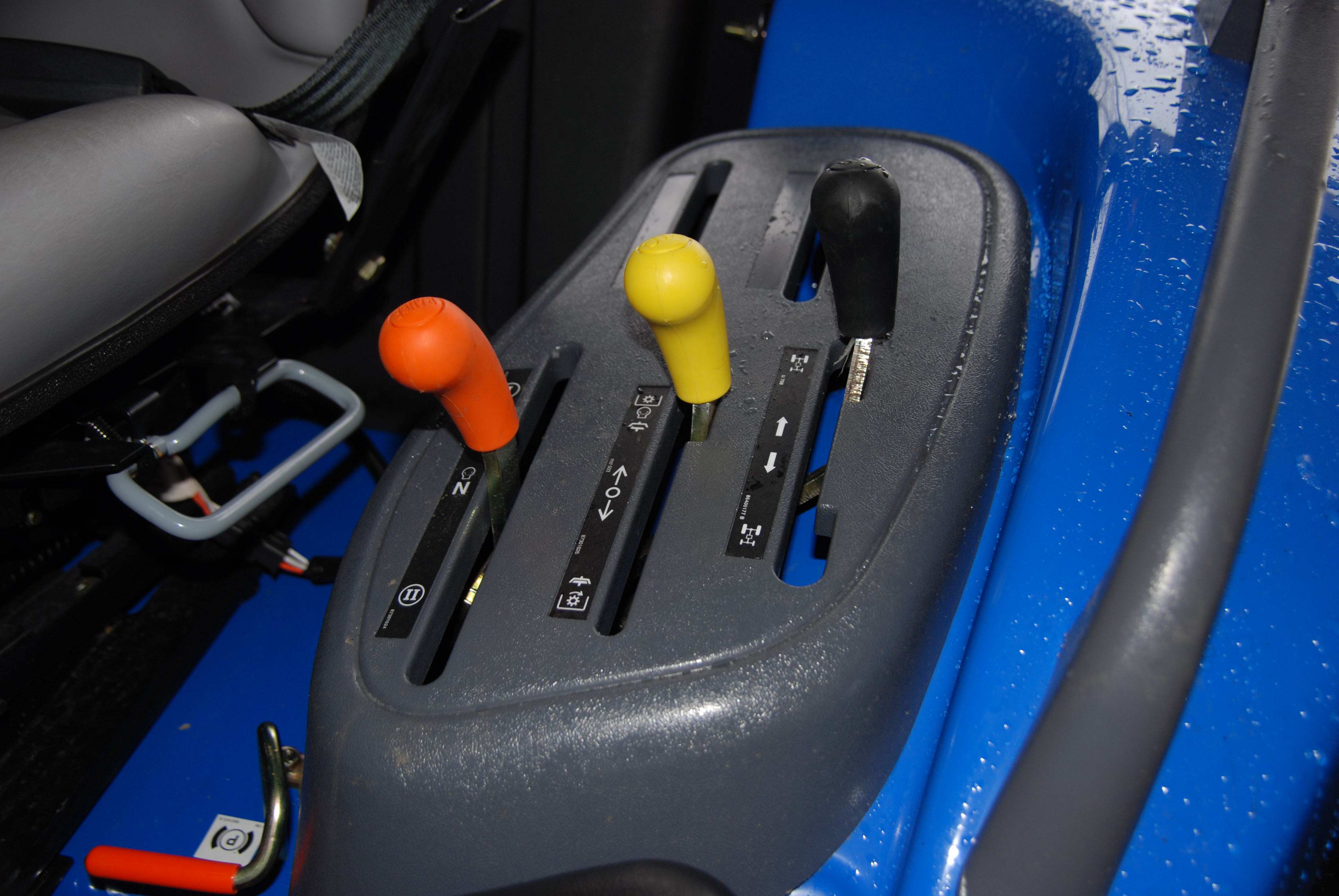

Here are a couple of pictures. The orange knob is the range selector. The Rabbit/Turtle switch is right behind the loader controller. I actually prefer the switch over the selector, because you can change easily when using the loader (going into a pile needing a slower speed), or when you get into a heavier load with an implement.

Dreamin Tractors if you purchased a loader ready tractor you should also have a rabbit turtle switch incorporated in the joystick which is my favorite feature of this tractor loader combo. Anything I do using the loader or looking forward and operating the tractor I use the joystick switch, looking back operating an implement I use the fender mounted switch.

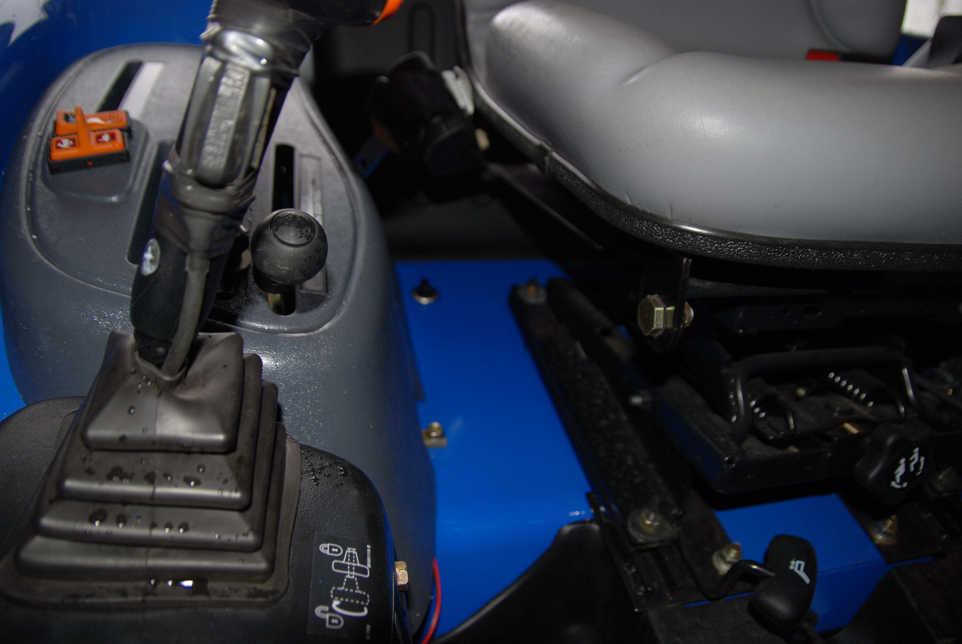

Correct, basically two speeds on each fender. I forgot about the rabbit/turtle buttons on the loader joystick :) I use my grapple and they plumbed the controller on the joystick for opening and closing the grapple. I mostly run mowers or a box-blade and I typically use the fender switch out of habit.
From the picture you can see 3 black holes, 1 is a screw and the other two are the rabbit/turtle buttons.
