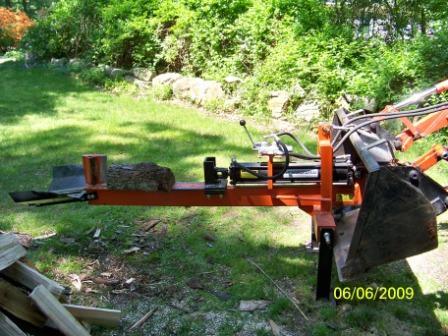

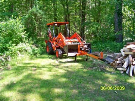

I run an adapted 3PT splitter on the front of my B21 from the BH connection and longer hoses. I bought the ramsplitter 25 ton and they put legs and a stand on it and can remove the stand and put the beam near the ground for the big logs.
I use the BH to lift and hold logs - cut about a half cord, then swap the hoses back to the splitter and start splitting.

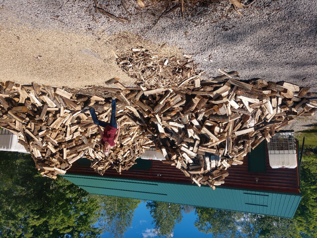

I agree SR!!!
Here is the smart way we process wood:
Took 12 cords of logs and turned them into firewood in 15 hours. Just the two of us.... 69 YO man and a little 56 YO lady. And we had never used a processor before so we will be faster next time. Cost of $450 for processor rental and 10 gallons of diesel. No chains to sharpen, no saw to maintain, no splitter, no trailer or wagon needed.
Not for everyone but a viable option when you can buy logs at a reasonable price. Those 12 cords of maple cost $600 delivered.
