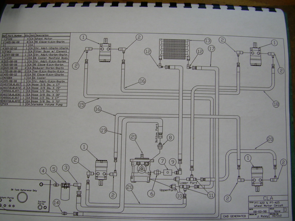

Several of us have been posting, for a couple of years now, about working the PT in hot weather and how when the oil gets hot it's less efficient and the tractor loses traction and power. And we have discussed better cooling methods and adding thermometers to the hydraulic tank.
Now I'm reading posts that the tram circuit is closed loop and the oil never gets back to the tank or through the cooler. If that's true it looks like we would need to add some kind of cooler just for the tram circuit. Maybe just fill the bottom of the tub up with ice cubes before we go mowing, lol.
Also , if the above is true, wouldn't the oil in the tank get overheated only by heavy pto use? To the contrary, I have made the tank to hot to touch by doing a lot of tramming. For instance, moving lots of brush long distances with the grapple bucket. What are some thoughts?

I can certainly understand your difficulty in understanding the system. I'm having similar problems...
For example, why do you need a 4gpm charge pump to "prime and feed" a 16gpm hydrostatic pump? At least that's the picture I get from the previous posts here... Certainly makes me wish I had a GOOD schematic handy.
I can understand the need for a charge pump if the wheel motors have case drains -- since you "lose" oil out of those case drains that must be replenished in the circuit. But, how do you lose oil out of the circuit if there are no case drains on the wheel motors? What goes in the front wheel motor must come out the rear wheel motor. Does that mean that the systems without case drains in the wheel motors (such as my PT-425) are really open circuits, flowing back to the tank?

Looking at my schematic, it looks like the excess from the charge pump feeds to the hydraulic cooler and back to the oil tank. Thats why you need 4 gallons of makeup. Basically 4 gallons per minute is fed through the cooler by the charge pump. I assume (the schematic does not show one) that there is some kind of restriction so that there is some pressure maintained in the charge pump discharge to feed the wheel motor pump, or perhaps the oil cooler and hoses are enought of a restriction.

Bob, my question is, do you see the oil in the wheel motor circuit being cooled at all?
/ Conflict in my brain. #5
It is cooled because the charge pump is bringing several gallons a minute from the oil tank into the wheel motor circuit at the wheel motor pump inlet and then sending some of that backout through the cooler. When the oil is in the charge pump outlet some of it goes to the wheel motor circuit and some to the oil cooler. So basically there is a mixing of oil form the oil tank with that in the wheel motor circuit at the charge pump outlet. The wheel motor return also goes to the charge pump outlet which is the same section as the wheel motor pump inlet. I hope this is clearer.

That pressure in the charge pump is around 325 psi. I believe that what ever oil is being pumped and not used by the wheel motors is dumped into the case drain, and then to the cooler. I have seen a number somewhere that equates to how many gal of fluid is pumped by the charge pump. It is based on the gpm of the main pump. It just be that some of that hot wheel motor fluid is bleed off into the case drain, in order for the charge pump to supply fresh filtered fluid, and not using recirculated fluid all the time. That would give us a logical answer why the hydraulic fluid get hot just by working the wheel motors.
J_J, no doubt the case drains would recirculate oil back to the tank. However my machine does not have case drains. Looking at the attached schematic there is an outlet from the variable volume pump (#21) which goes to the hydraulic oil cooler (#13). The outlet of the cooler goes back to the tank. Mointed on oil cooler manifold (#7) is the temperature switch (not shown hear, but in the vehicle). Because of this I believe that the outlet of the recharge pump is fed to the oil cooler. I doubt that it is the high pressure side of the pump since then the oil cooler would have to run at very high pressure and the oil would flow through the cooler instead of the wheel motors. I don't think it is the recharge pump inlet since then you would be pulling unfiltered oil from the oil tank back through the oil cooler and bypass the filter. That leaves the recharge pump outlet. Of course since you have wheel motor case drains, then your schematics may be different. However the wheel motor case drains flow rate would be very variable, depending on the wear on the motors and would not be something that you could depend on. Again, I am not an expert in hydraulics, but this analysis seems logical to me. PT is taking advantage of the low pressure charge pump output to cool some of the hydraulic fluid. It seems very efficient to me.

As I suggested to Kent in the " Bleeding the closed loop system". Not to worry about his schematic being in Tennessee, it could be all wrong anyway.
I also have a 422 Bob, with the same schematic in the "Manual" as you are showing, there were many things had me puzzled with all of the schematics.
I gave one to JJ like the one you printed, I have apologized to him since then and all being well I will send you the schematic which is correct for my 422.
It's a tough job for a sr. sr. on his own but it was well worth the trouble.
As you will see there is no cooler shown, it is not connected into this circuit, also you will notice there is the addition of the treadle valve.
The Variable Volume Pump Part 2 is responsible for the operation of the wheel circuit, any excess oil is directed back into V V part one from where it is sent to a return port on the tank. Any excess in the circuit per se is exited to another return port on the tank from the treadle valve.
In a way it changes the whole perspective of what happens when. Very simple really we are using oil at our choice of pressure and letting any excess return to the tank.
Anyway so that you can all chew the fat some more, here is my wheel circuit on my 422 checked very carefully hose by hose. Have Fun.

Bill, I suspect that PT has several versions of the hydraulics, but maybe only give out one version of the schematic. I traced my hydraulic cooler lines (but not the other lines) and it is as shown. Where is your cooler connected? I think that will help answer the question.
By the way my machine was built in year 2000 and the schematic was dated in 1998.
Edit - My PT422 has the hydroback and cable. I bet the other version has the valve at the treadle. Which is yours?

Mr. Bill, Your wheel motor flow schematic for the 422 looks very close to the layout for my johnny home owner 180. ( the 180 has no oil cooler) so I am a little confused with your diagram showing the flow route on your wheel motors.:confused: . How is your cooler plumbed in??? What's it hooked up to???> Your diagram is not showing the oil cooler.

I bought my unit Mar 2004, The schematic was drawn Aug '98 and was revised May 2000.
As you can see I do have a treadle, I can only guess when they ran out of hydrovac parts, is when the treadle cxame into being.
The cooler line (1/4 inch) comes from the lower left port of the Sauer Danfuss valve, and leaves the cooler into the No 2 port on the tank.

You don't see the cooler in the wheel scematic, because on my PT it isn't.
For those of you who don't mind looking carefully at schematics, as I mentioned earlier the cooler line comes from the lift-tilt-aux pto valve bank, and from the cooler goes to No 2 return port of the tank.
Remember this is my PT, I'm positive there are many more variations of the hose layouts, even on the same designated models, mine is a PT 422.
