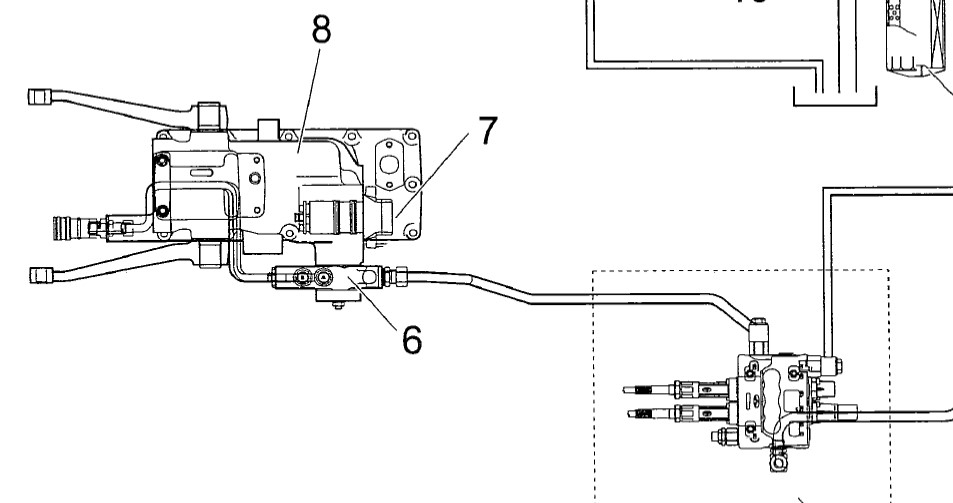

/ Confirm I'm doing it right. Adding 3 spool for remotes
Here's a drawing - shows the loader valve and the hard line that goes back to the remote valve. #6 is the remote valve
So as I see it the only way I could really do this would be to cut that hard line, then connect a line to it go to the new valve, then out that valve and connect to the other half of the hard line. I'd be tempted to try that if I got a second hard line to mess with. Plus then I'd have a stock hard line to use if needed.
In then meantime I think I'll do what I was originally considering - hooking the new 3 spool up to the quick connects from the rear remote. Yes it means I have 3 remotes not 4 but it's a quick setup. (and I'm getting this ready so I can control my snowblower so that needs to be going sooner than later!)
And then I can in my leisure figure out how to set it up as suggested between the loader and the remote valve.
E.

Leejohn - Great diagram. That makes me realise if/when I do set up the new 3 spool between the loader valve and the remote valve I need to use the power beyond option and will have one line then going from that to the existing remote valve and another line I'll have to T into a return line somewhere. (There's the one coming off the loader valve.)
LouNY - Thanks - yes I think it's as you describe given when I hook the backhoe up to the existing remotes I have no issues and hooking the new 3 spool to the rear remotes should function exactly like the valve in the backhoe and have no issues. That was my main concern that I was missing something and that this wouldn't work.
Ideally it would be nice to set up the new 3 spool between the loader valve and the remote valve. As I said in my earlier post I think I'll do it the quick and easy way for now and then take my time to figure out how to plumb it between the existing valves later.
I have made my own brake lines and then headed to the racetrack but I'd hesitate to cut a 3000 psi hydraulic line and assemble an end on it. You can get hydraulic rated adaptors for just about any fitting. If I were doing it I'd buy lines and use adaptors to match the fittings on the loader valve and stock remote.

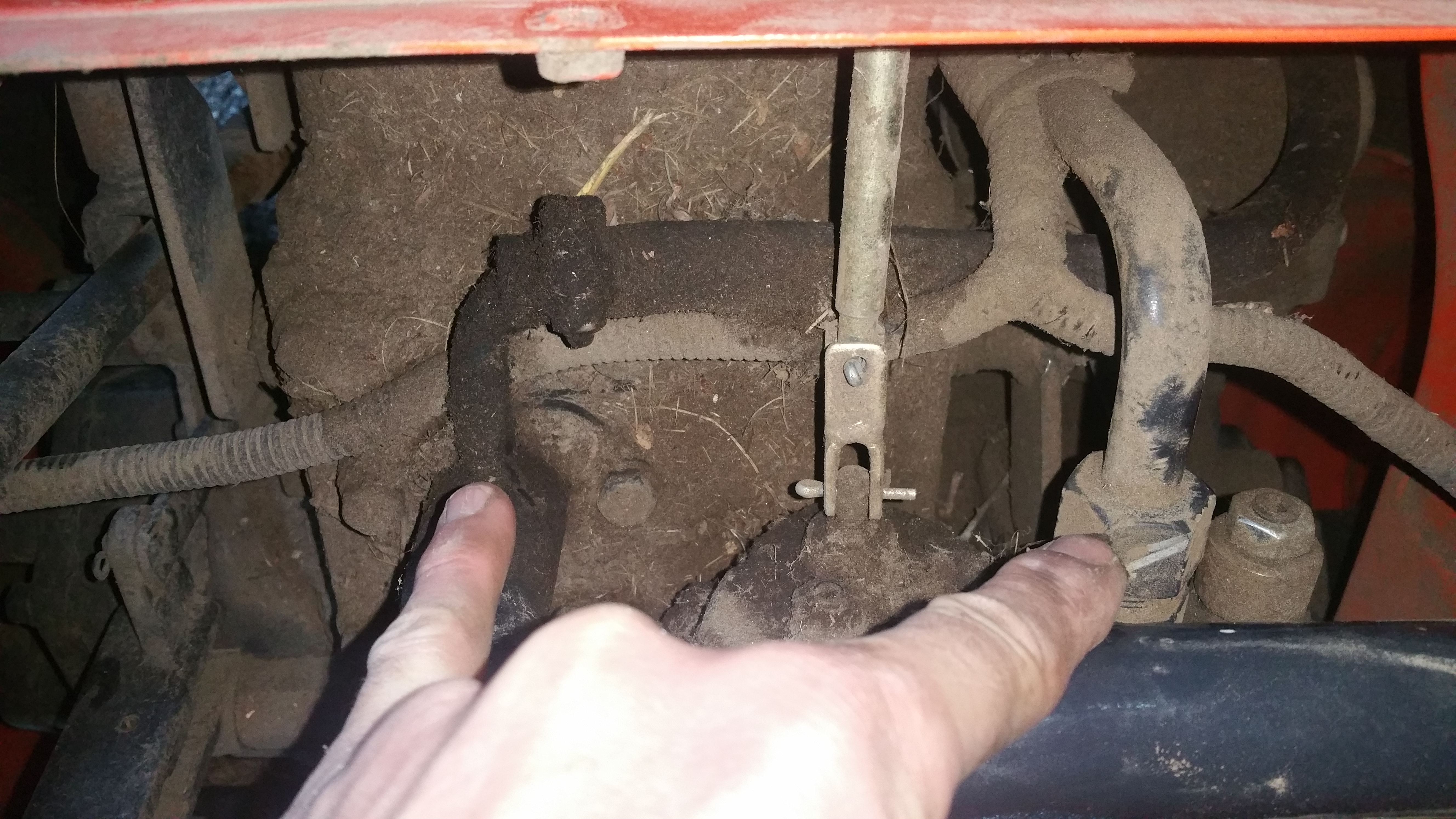

Thanks N2DFire! Great write-up. For some reason I didn't get notified that you'd posted up so I'm only seeing this now.
I pulled my seat up as I couldn't remember accurately how things looked there since it's been years since I added the rear remote. The one interesting thing I noted (see picture below) is that at the base of the hydraulic filler tube there's a line that T's into it, following that line back it's off the valve for the power steering. (Tank dump) I'm not sure why Kioti did that given there's a large diameter hardline return that feeds to the one side of the hydraulic filter that everything else that has a dump to tank feeds into. But that raises a question from me - Can I T into this return line for my dump to tank from my new valve? It sure would make my life easy if that's the case! In the pic below my finger on the left side is pointing to said return line.
My thought regarding how to hook the new valve up would be to disconnect the hardline going to the 3pt (see above pic, my finger on the right side of the pic.) given the distance that hardline is traveling I'm hoping I can convince it to move over a tiny bit, connect a line from it to the new valve and then connect a line from the PB on the new valve back to where the hardline connected to the 3pt. Doing it this way saves me some of the hassles N2Dfire experienced trying to connect up to the output on the loader valve. My tractor has even less space to play with than his has!
The only big question is are my connections the same size as a Kioti CK35.... Hmmm!

Between the dirt and the finger, I can't be 100% sure :D but the one on the right looks like the banjo style fittings.
Our tractor is on "the farm" at my parents place and I'm 95% sure I wrapped the hard line up and stashed it out in the barn someplace but if I get a chance this weekend I'll try to go dig it up and take a picture or two for reference.
If it is that style - finding something to go back into the rear end housing should be pretty easy but getting something to connect up to the hard line might be . . . interesting.
If I think about it (and it's not raining & wet everywhere) I'll try to get better shots of the fitting on the loader valve and stick a ruler in there for scale. It's definitely tight but getting rid of that NPT swivel fitting & adapter and going to JIC made a HUGE difference.
As for the Tank line - if it's like I'm picturing it in my head, you probably can T into that return line - I'll try and look at ours and see if it's the same also.
