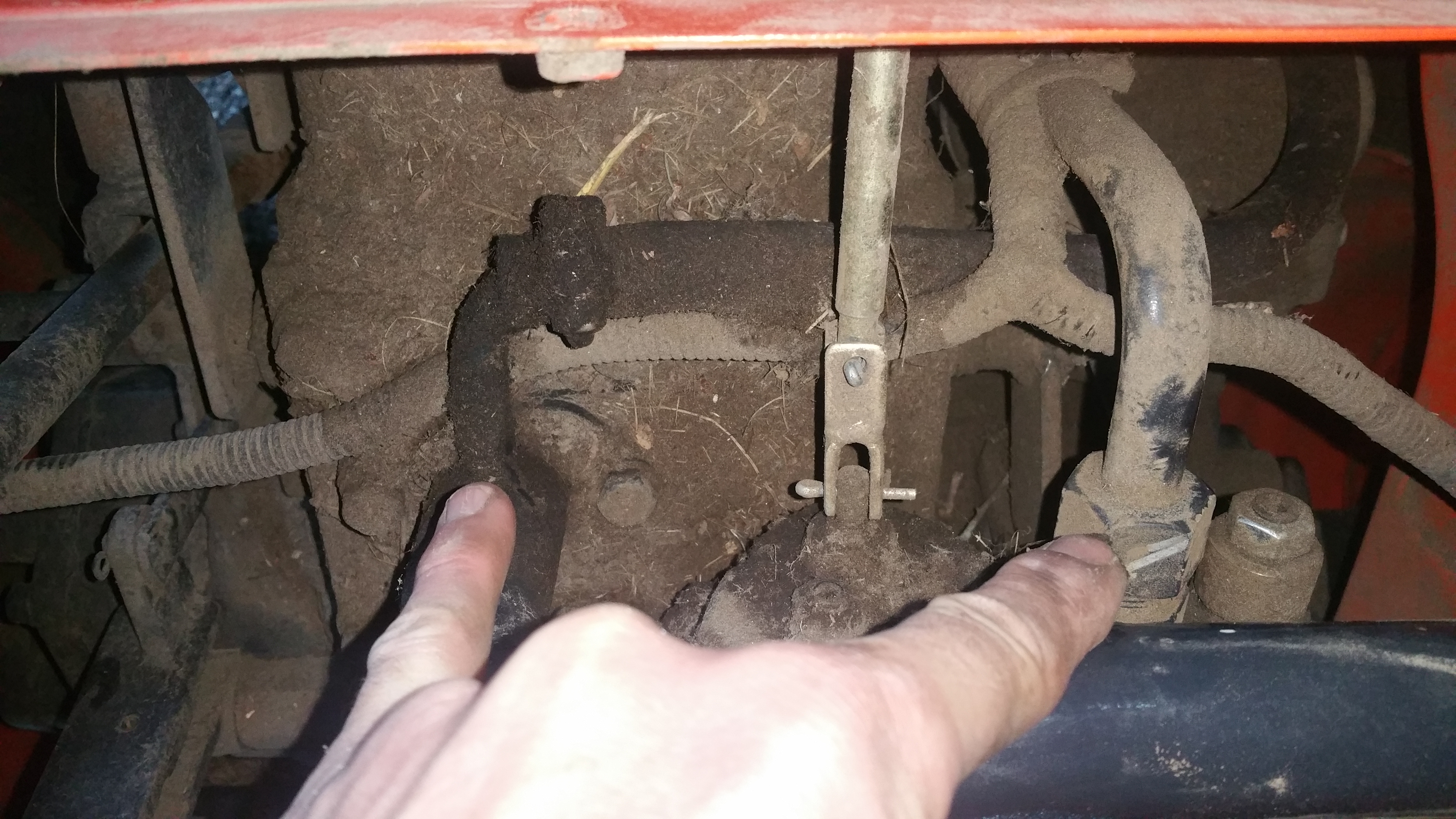

I pulled my seat up as I couldn't remember accurately how things looked there since it's been years since I added the rear remote. The one interesting thing I noted (see picture below) is that at the base of the hydraulic filler tube there's a line that T's into it, following that line back it's off the valve for the power steering. (Tank dump) I'm not sure why Kioti did that given there's a large diameter hardline return that feeds to the one side of the hydraulic filter that everything else that has a dump to tank feeds into. But that raises a question from me - Can I T into this return line for my dump to tank from my new valve? It sure would make my life easy if that's the case! In the pic below my finger on the left side is pointing to said return line.
My thought regarding how to hook the new valve up would be to disconnect the hardline going to the 3pt (see above pic, my finger on the right side of the pic.) given the distance that hardline is traveling I'm hoping I can convince it to move over a tiny bit, connect a line from it to the new valve and then connect a line from the PB on the new valve back to where the hardline connected to the 3pt. Doing it this way saves me some of the hassles N2Dfire experienced trying to connect up to the output on the loader valve. My tractor has even less space to play with than his has!
The only big question is are my connections the same size as a Kioti CK35.... Hmmm!

   / Confirm I'm doing it right. Adding 3 spool for remotes #19
Thanks N2DFire! Great write-up. For some reason I didn't get notified that you'd posted up so I'm only seeing this now.
E.
Between the dirt and the finger, I can't be 100% sure :D but the one on the right looks like the banjo style fittings.
Our tractor is on "the farm" at my parents place and I'm 95% sure I wrapped the hard line up and stashed it out in the barn someplace but if I get a chance this weekend I'll try to go dig it up and take a picture or two for reference.
If it is that style - finding something to go back into the rear end housing should be pretty easy but getting something to connect up to the hard line might be . . . interesting.
If I think about it (and it's not raining & wet everywhere) I'll try to get better shots of the fitting on the loader valve and stick a ruler in there for scale. It's definitely tight but getting rid of that NPT swivel fitting & adapter and going to JIC made a HUGE difference.
As for the Tank line - if it's like I'm picturing it in my head, you probably can T into that return line - I'll try and look at ours and see if it's the same also.
