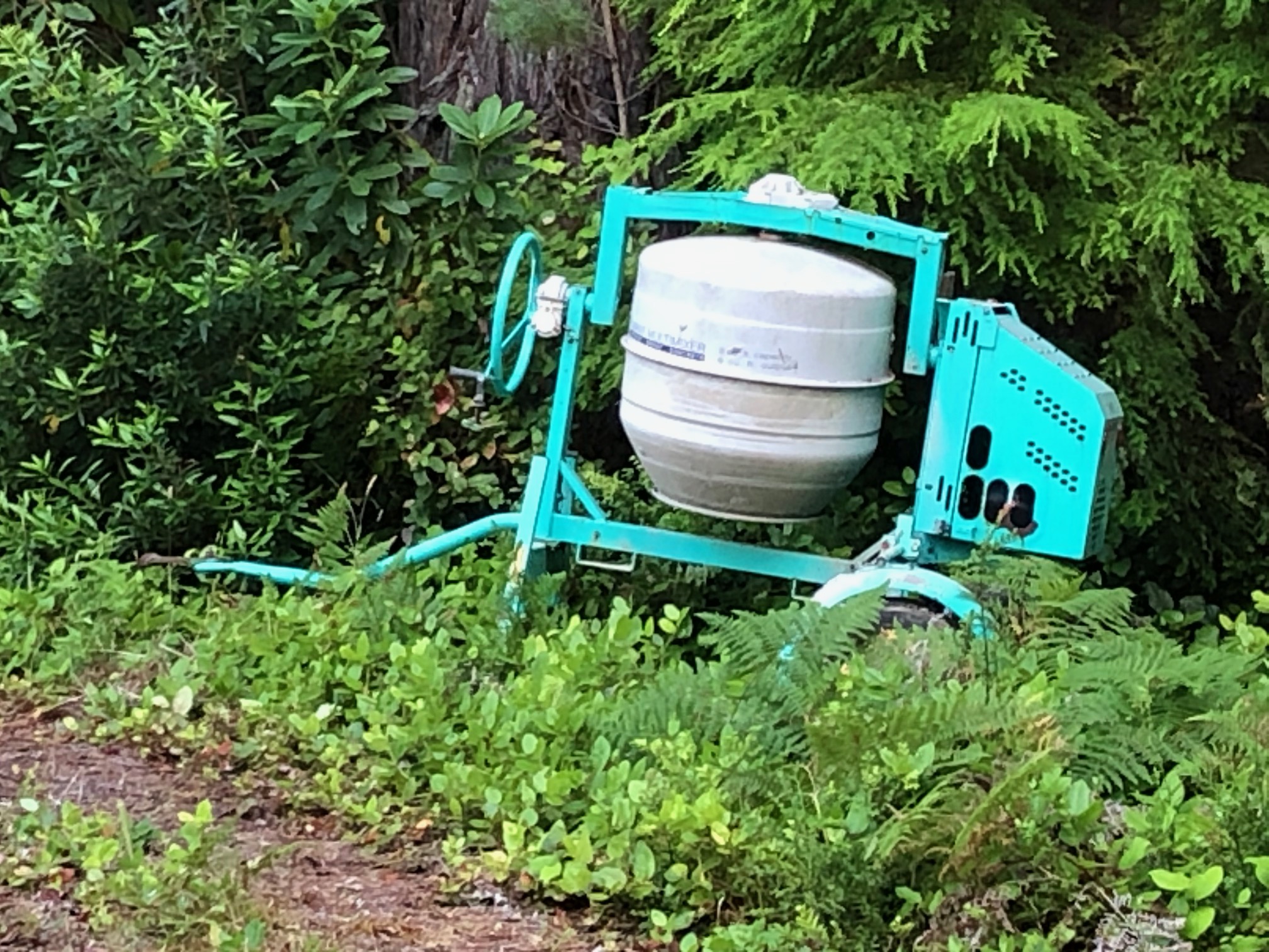

Years ago I did a foundation up a narrow driveway that was not safe for concrete trucks. So I got this 6 cu ft Imer mixer. It was small for that job but a good size for many other jobs. I still use it once or twice a year. Just stick it out of the way in the bushes. Makes concrete work almost easy.
