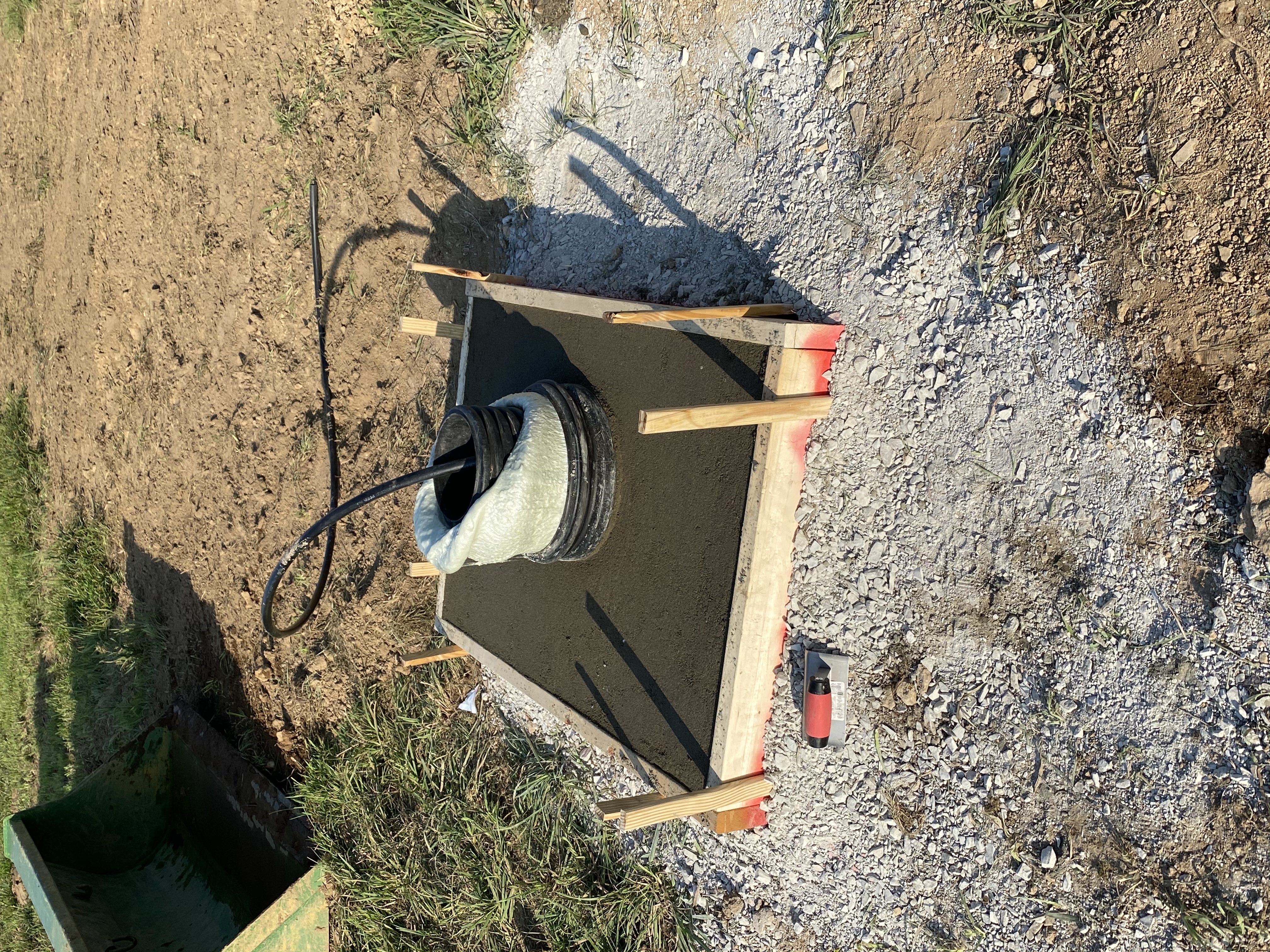

I ended up using 6 bags of “Crack resistant” fiber reinforced Quikrete. I actually made the slab size a little smaller but still large enough to have a 4” ledge around the waterer.
All 6 bags were mixed in one of those ‘concrete tubs’ 3 qts of water to a bag. I purchased some Super-plasticizer off Amazon, which was really amazing. The guy that was helping me said “We need more water.” I told him to watch this, and sprinkled a little dust (SP) over the moist concrete. Kept mixing and watched it get more and more wet... all without any more water.
Cut the edges a little early I think, but I was tired of dealing with this by then. Put wet straw over the slab, covered it all with a tarp, and I’ll let it set until Friday.
All in all, I’d rather have a mixer, but this was certainly doable. I’m going to look for a FEL style for my tractor, although a PTO version might also work.

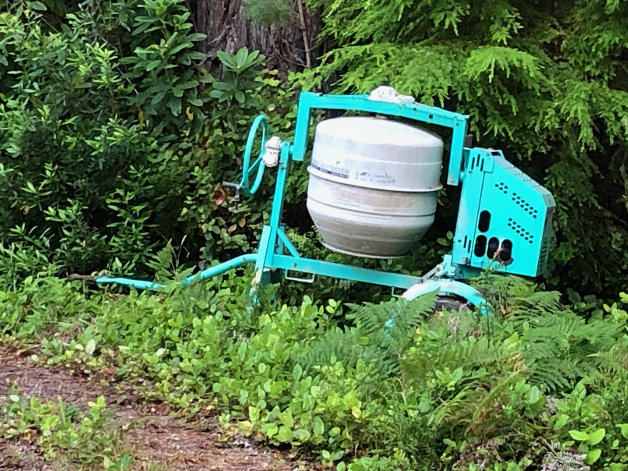

Years ago I did a foundation up a narrow driveway that was not safe for concrete trucks. So I got this 6 cu ft Imer mixer. It was small for that job but a good size for many other jobs. I still use it once or twice a year. Just stick it out of the way in the bushes. Makes concrete work almost easy.

I知 putting in a Mirafount waterer for horses. Everything is installed up tp forms which I値l be doing today.
I致e never worked with concrete. I致e read about it relatively well and understand the basics I壇 guess.
6 slab around a 12 vertical pipe for water access. Slab is 51 x 40 x 6 with the tube coming up flush to slab surface grade. Calculates to just over 7sqft of concrete I believe.
I知 not close to electricity, although I have an inverter for my truck which �ight run a small electric rental mixer. (Never used a mixer of any sort, but they are available locally. Or I have a barn about 1/8M away and could mix there, then transport somehow.
I would like to make this reasonably easy. It痴 a simple job, but I壇 like it to go well.
What are your recommendations for tools etc, for this job? To purchase.
What tips will make this better and go more smoothly?
What concrete would you use? Again, easy and good quality is far more important than saving a few $.
Any and all tips, thoughts, etc are requested. I壇 rather pay a little more for an easier and better outcome than 僧ake do but struggle.
