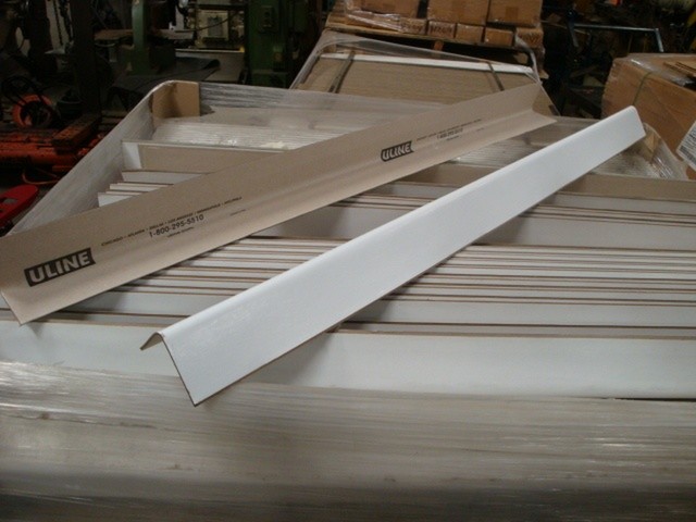

Or cardboard corner protectors.

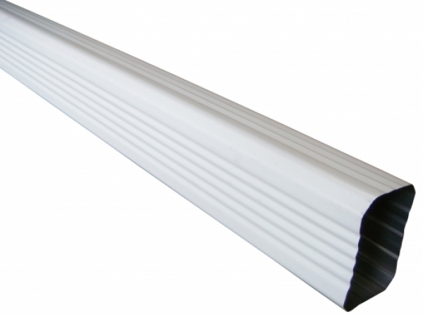

Or half of a plastic rectangular downspout.

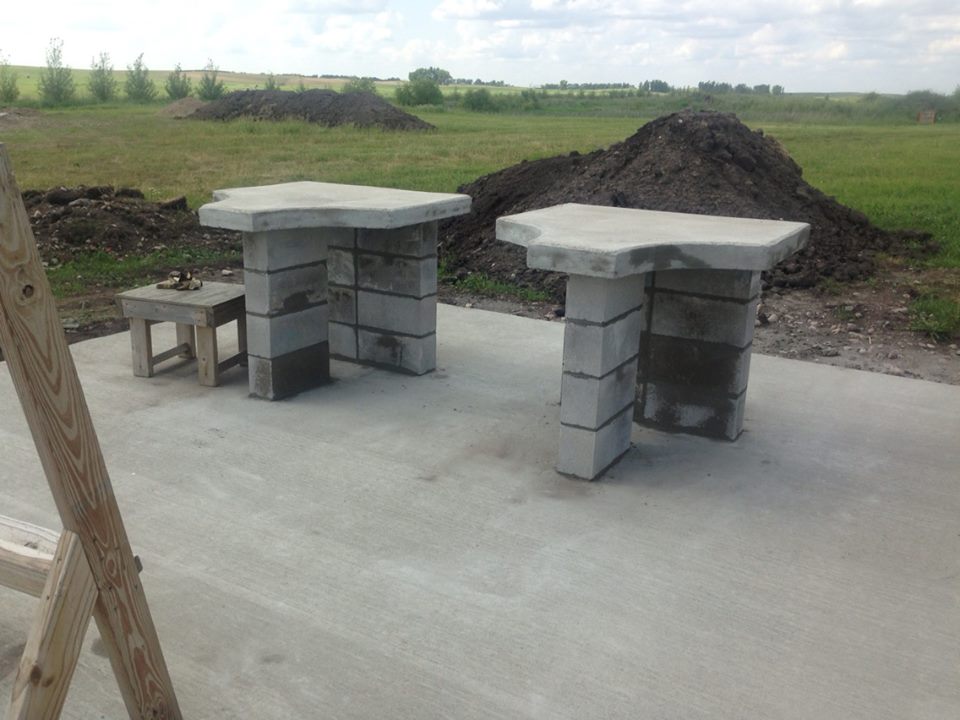

And it's done!
Actually, I still need to pull the pad forms (I'll wait until the ground isn't so soggy and muddy) and dress the pad edges a bit plus clean the pad off.
I'll let that sit today and tomorrow (it's in the low to mid '40's today), cut the piece of carpet tomorrow (using the tabletop form as a guide), then it's time to do some shooting!
Thanks for all the help, I appreciate it!!!

It looks great to me. So how will you get the deer to walk onto your range? :D

Shouldn't be a problem: there's a pretty nice deer scrape right up on my pole barn field which is in the background above the range backstop. There's also one on the trail/track above and to right of the backstop area. Deer are pretty much like rats around here.
