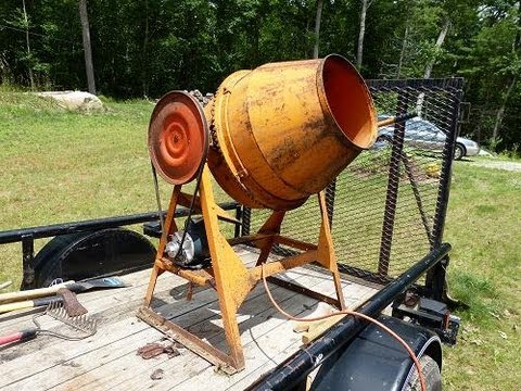

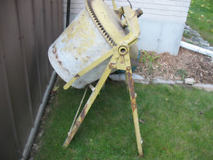

Rarely use pre mix bags , I always get sand / gravel mix from a local rock place and mix it 4 shovel fulls of that with 1 cement shovel . Add water accordingly . Most of the time I mix 16 to 4 , which when dumped into a double tire wheelbarrow is about all you want to push around . Last slab I did was 14' x 8' x 5.5" . Wife helped scree it off but the mixing , dumping was all me . That shed still stands this day without a crack any were .
For that amount , I think you will be fine . Don't mix to wet or to dry . The way you talk about dumping it into your bucket will work since you will have some settling of the mix . but no water loss . So before you dump into your form , just use a garden hoe to stir it a little before dumping .
Images below are similar to the type mixer I have
Fred H.
View attachment 400776View attachment 400777
I had/have the same mixer as your white one... did a good job until I loaned it out and it came back with a cracked yoke... did not notice it until I started to use it... thankfully, a neighbor had a Harbor Frieght he was long done with and it's been a trouper as long as I mix no more than 2 60# sacks at a time.
