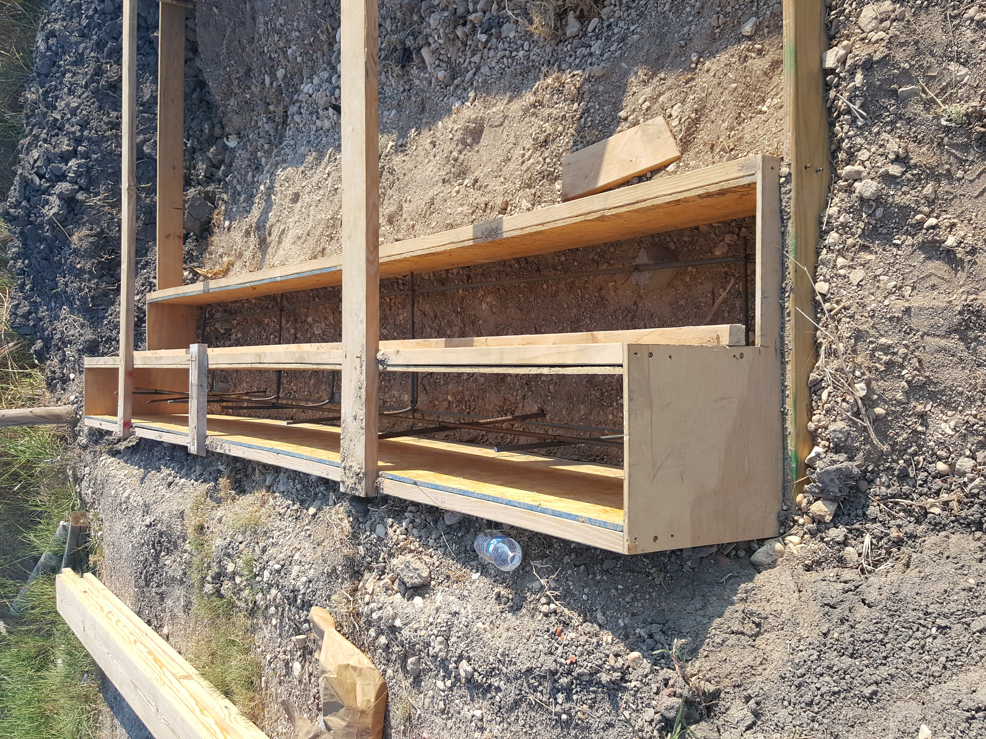

For this application, it probably doesn't matter much whether the re-bar is in the ground or not. However, it is bad practice to have steel not covered by concrete. If the concrete is in contact with the steel, it "passivates" the steel and completely stops corrosion. I've seen a thick steel plate rust through completely from the back side because a piece of wood got into the pour and prevented concrete contact. It looked perfect from the outside until it fell apart. I try to make sure reinforcement is completely within the concrete.
/ Concrete footing question #22
I can add another horizontal rebar easily.
Do i need to rent vibrator?
Vibrators will give you a better finish where the forms are, but for what you are doing, it's not going to do much. Use a piece of rebar, or a stick, and work the concrete along the edges, hit the forms with a hammer to get rid of air pockets, and you'll be fine. If you are really ****, you can always fill in any issues once the forms come off, but it wont really change anything either way.

Not perfect but will do the job i think. I learned a lot about concrete, including 3 yards is a lot of work by yourself when its 102F

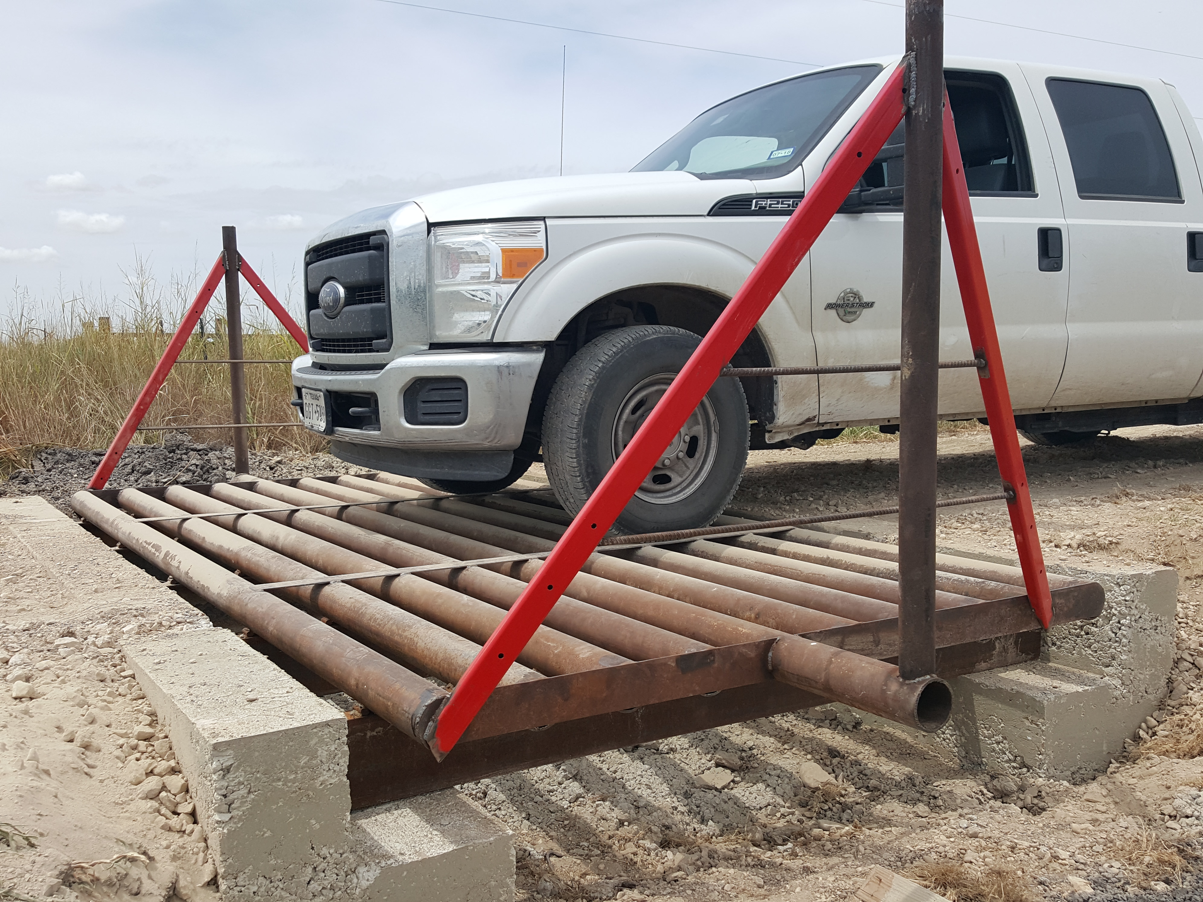

Hi guys, I'm doing a few projects outside and need some advice about repairing a bent cattle grid. I have a tubular cattle grid, split in half with 7 tubes on each side. What happened is - the Calor Gas driver drove his lorry over the center of the grid. This caused the pipes to bend down by about an inch, as they have no support there. One side of the grid is now a good inch off the concrete. He only went halfway so only the first section is bent. This looks and sounds terrible each time you drive over it.
I want to straighten the tubes out again. My idea was to put the grid upside down, put some weight on it and hit each tube with a sledgehammer. I'm not convinced this will work tbh so does anyone have any other suggestions?
/ Concrete footing question #40
How much did that lorry weigh? You're going to have to turn the grid over and apply that much pressure (if not more) to reverse the bend, so, no a sledge hammer isn't going to work. Unless you have some heavy duty gear that can apply several tons of force, you'll have to replace it if you want it straight.
