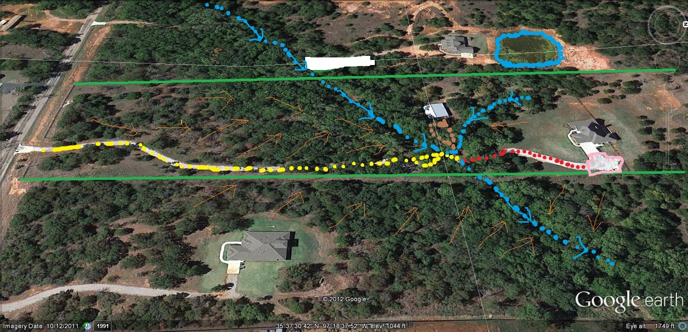

Do you thing a giant vibratory roller would help compact, flatten, and smooth the base and top layers? I really wouldnt want them to tear up any base that has already settled and packed together. However, I do know there are areas that need to be graded beyond the capabilities of a boxblade. I think the drive needs a more definitive crown or have it shed water off to the downhill side.

We built a new house a couple of years ago. I put the gravel driveway in myself before we built. It's about as long as yours and includes three water crossings. I hired a guy with a big Cat to push down the tress and move most of the dirt. The specs for the new house included a large concrete parking pad which adjoins the house, shop, and garage. The pad added $10K to the house build. It was worth every penny.
I suggest, as others have, that you have a concrete parking pad poured next to the house.
As for the rest of the driveway, this is just my opinion, but I don't think a long concrete drive looks right in the country, unless it belongs to an "estate'' with manicured everything. Concrete winding by itself through what is otherwise a natural environment just doesn't look right, while gravel looks fine. There is no way we will ever concrete our drive.

My parents have been doing exactly what you propose for the past few years. The first, and IMO most important pour was the parking area. This made a HUGE difference as to the aesthetics of the driveway, as well as improving the ease of working on vehicles/plowing/etc. Every year they add a new section, with the rest of the driveway being recycled asphault. They really like the recycled asphault over gravel; it seems to pack better. The concrete has not cracked except at the joints, and it has been a rewarding and affordable project for them over time.

I checked at a mason & concrete supply store for reusable metal forms today and they said to just grease some boards up. He also said to just grade the drive and compact/roll it, then pour directly over the gravel. Would a plate compactor work at all? I would hate to keep renting a roller for each section.

Skipped through the thread...For concrete do it all at once or at least in front of the house and then the rest of the road later on. Don't got less than 5" 3500psi 3/4" double wwm.
For a budget and not to throw a ton of money at it. Get it regraded and bring in Recycled Asphalt. Shop around, though some places (Quarries) have better quality than others. Spread it down, I'd got with 4"+, a little water and use a roller/plate compactor (preferably a roller for your large area) to compact it down. It's the cheapest semi permanent pavement you can get. Water wont do damage to 95% of it.
I can get it around me for $6-9 per ton. Another option is Recycled concrete which is dirty cheap to. When you wet it and compact it, it's super super hard.

Here is a side shot of our property showing the overall project area. The view is looking west. At the end of the drive, the pink area just off the garage parking pad would be area #1, about 1700sqft. The red area would be the next area of focus, about 350ft in distance, down to the creek crossing. That area would be its own area of focus, again about 1500sqft in area. Then the final stretch back to the road, would be entirely uphill, and about 6-700sqft in length. The orange arrows denote the flow of water, which you can tell, wants to run across and down the long hill of the drive.
