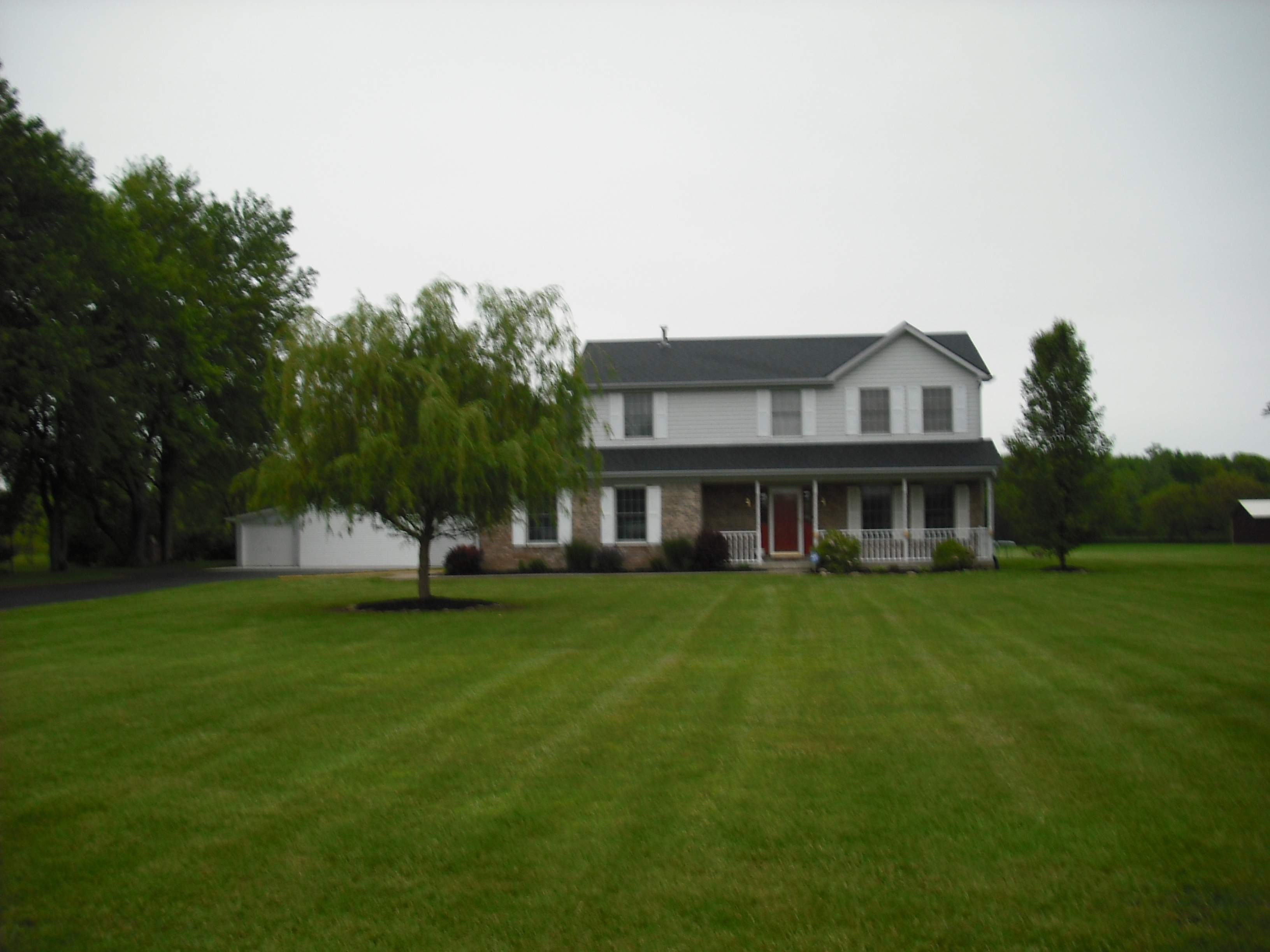

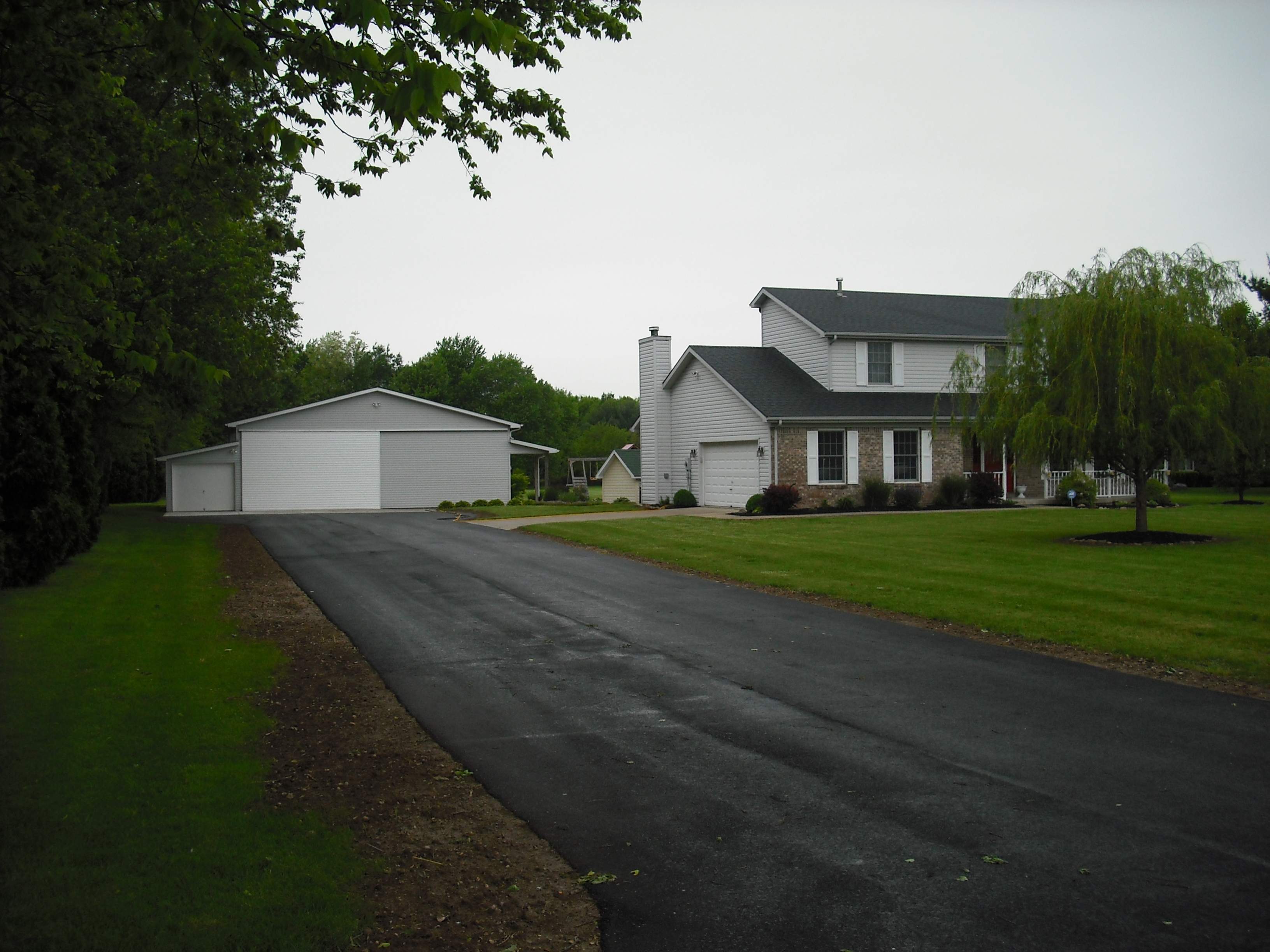

/ Concrete drive #28
I just had my drive done in April. I have 4600 sq ft of drive and I was looking at 5.5" of 4000 psi for my needs. Commonly tow trailers at 25,000# over it. Anyway it was right at $5.25 per SQ FT in my area for the concrete and labor. We were looking about 85 to 90 yards of concrete at $106 per yard with fiber in my area. I also wanted wire and it comes in rolls that are 100'x5' here for about $75 each or another $7000. Long story short it was just a tad over $30,000. Too rich for my blood.
What I ended up doing was I had a 40x20 slab poured in the front of my pole barn. We used 4000 psi with mesh and wire. I think it was $1600 for the materials and I dug it out using my tractor, my neighbors dump truck, and my brothers Case BH. I paid some finishers $.70 per SQ FT to pour it and finish it or $560. So I had about $2200 in this 800 SQ ft slab by doing some of the work myself.
I had the rest of the drive paved by a local company. They did 4200 sq ft 3" thick for $7500. So all in all the whole drive was done for less than $10,000.
Anyway, I think the price you got is right in the ball park. I would put wire in it though or even rebarb.
Chris

Nice place you have Chris.
Tractorshopper:
If you're going to spend $4,700 for asphalt, spend another $300 and get concrete.
No brainer isn't it:thumbsup:? Haven't talked to any other asphalt guys to check that price, but couldn't believe it was that close.
