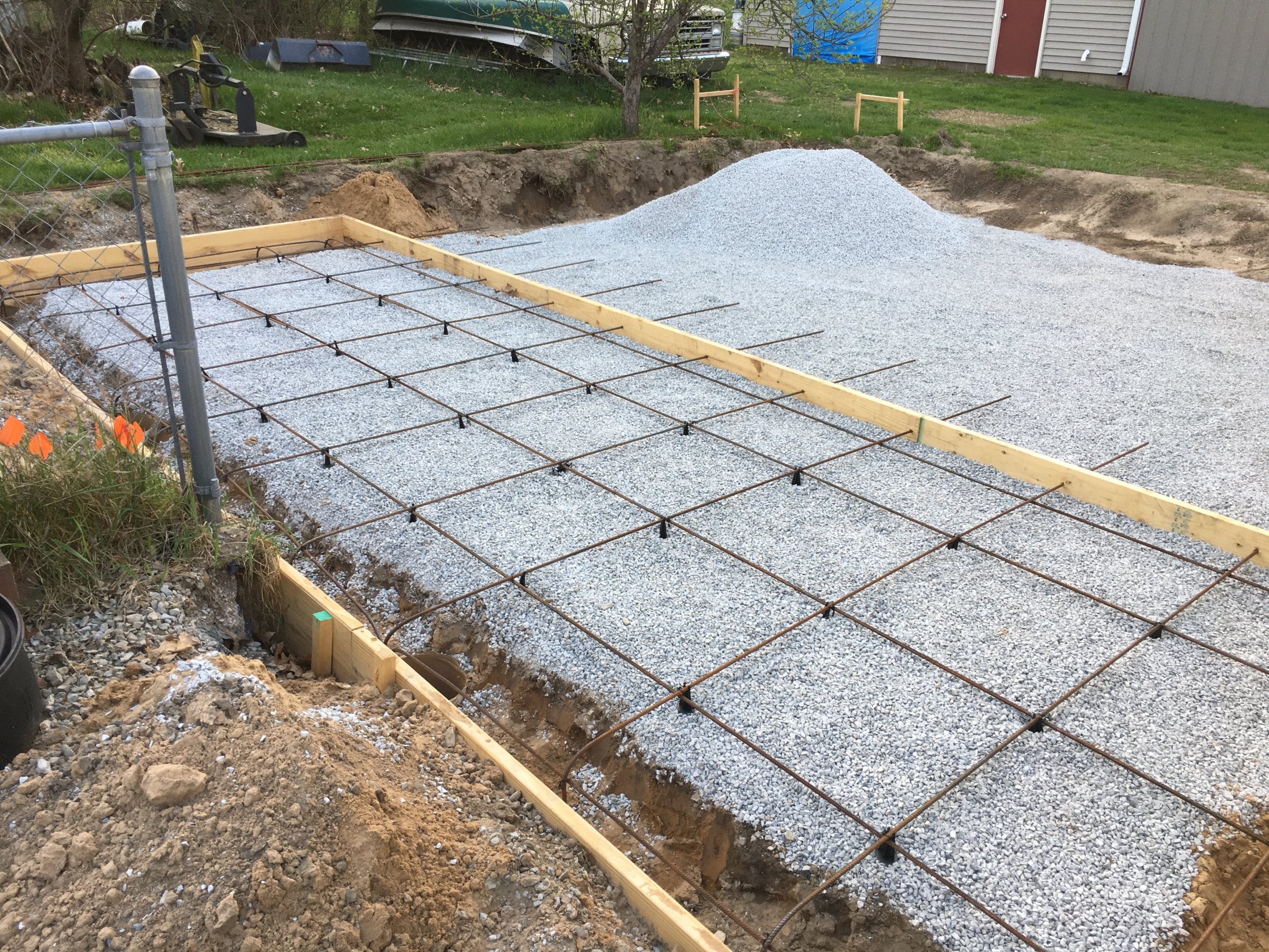

When I did my garage addition in 2020, I used these little plastic chairs. Pretty easy addition, cheap, and I know the rebar isn't laying on the bottom or 1/4" from the top. They are currently .29 each. Not sure what they were 4 years ago.
EDIT: They were .17 each in 2020.
Nice thing about Menards... they keep your receipts on-line for quite a while. :)
(click to enlarge).
Regarding how deep... these chairs are 2.25" tall. I used 2X6 for depth, so real number is 5.5" thick slab. So they are 0.4" shy of being in the bottom 1/3 of the slab. 🙃
