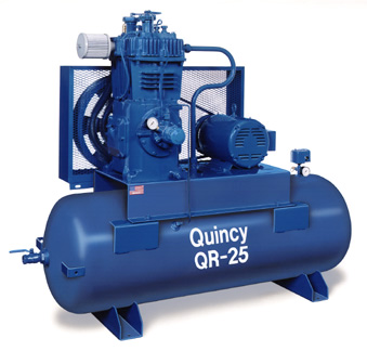

Decided to go to the garage and look..... mine is a pressure lubricated unit with an oil filter, rather than the splash lubed ones that they are now making. I believe that even Quincy has entered the field of cheaper air compressors to be able to compete for the lucrative homeowner market. I will post two pictures..... this is a side view....

Wow! That looks huge- is it really a 5hp, or a 25 hp as illustrated in the 1st picture?

Mine is a true 5 HP electric motor..... not one that is about 2 HP, but some engineer has some fancy way of figuring out how to call it a 5 HP by doing some fancy footwork. I looked up the motor number once to get a price for the motor for another compressor that I was considering. It was like mine, but had two compressor heads mounted with 2 3 phase motors. I figured that I would just replace the motors and then sell mine. The motor alone, with the best discount that I could find was just a hair over $400 buying 2 of them. I gave up on the though of buying that compressor since the motor cost put it out of practical range. It was the only one like it that I had ever seen and it was a factory built unit. I doubt that you could have run that unit out of air no matter how hard you tried. The way it worked, is that one motor / compressor would come on and if that one didn't bring the tank up to specifications soon enough, then the other one would kick on and give it assistance. Would have been great for doing sand blasting...
