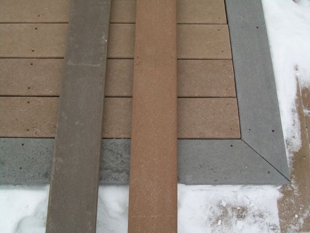

Here is a photo of the saddle (brown) and grey trex somewhat new and installed about 8 years ago. The "new" are a couple pieces I had left over and are in my barn. It does fade, but there still quite a bit of color.

Thanks FF
Looks good I dont mind the fade its uniform

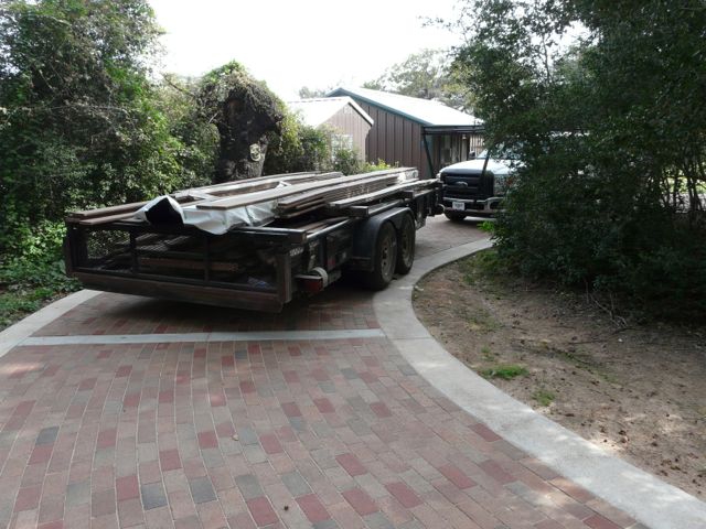

Do not take shortcuts and make sure you do everything exactly to specification. The inspector that came to my house spent nearly four hours and took hundreds of photos. most included a measuring tape and level. He never smiled and would not tell me anything just left and said I would be notified. That is an eerie feeling. I'm glad this one time I read and followed the installation instructions to the letter.
I was ready to replace it myself after all the complaints on the internet from the people who were denied coverage because they were off on their measurements by just a little.
You can imagine my joy when this and a crew showed up one day - almost 6 months after I filed a claim. It took 4 guys 3 days to just replace the top decking. All my understructure was solid and spaced right with appropriate sized lumber. It does matter.
This was also a weight test for my newly laid paver drive and it also passed - no movement whatsoever!!!!!!
