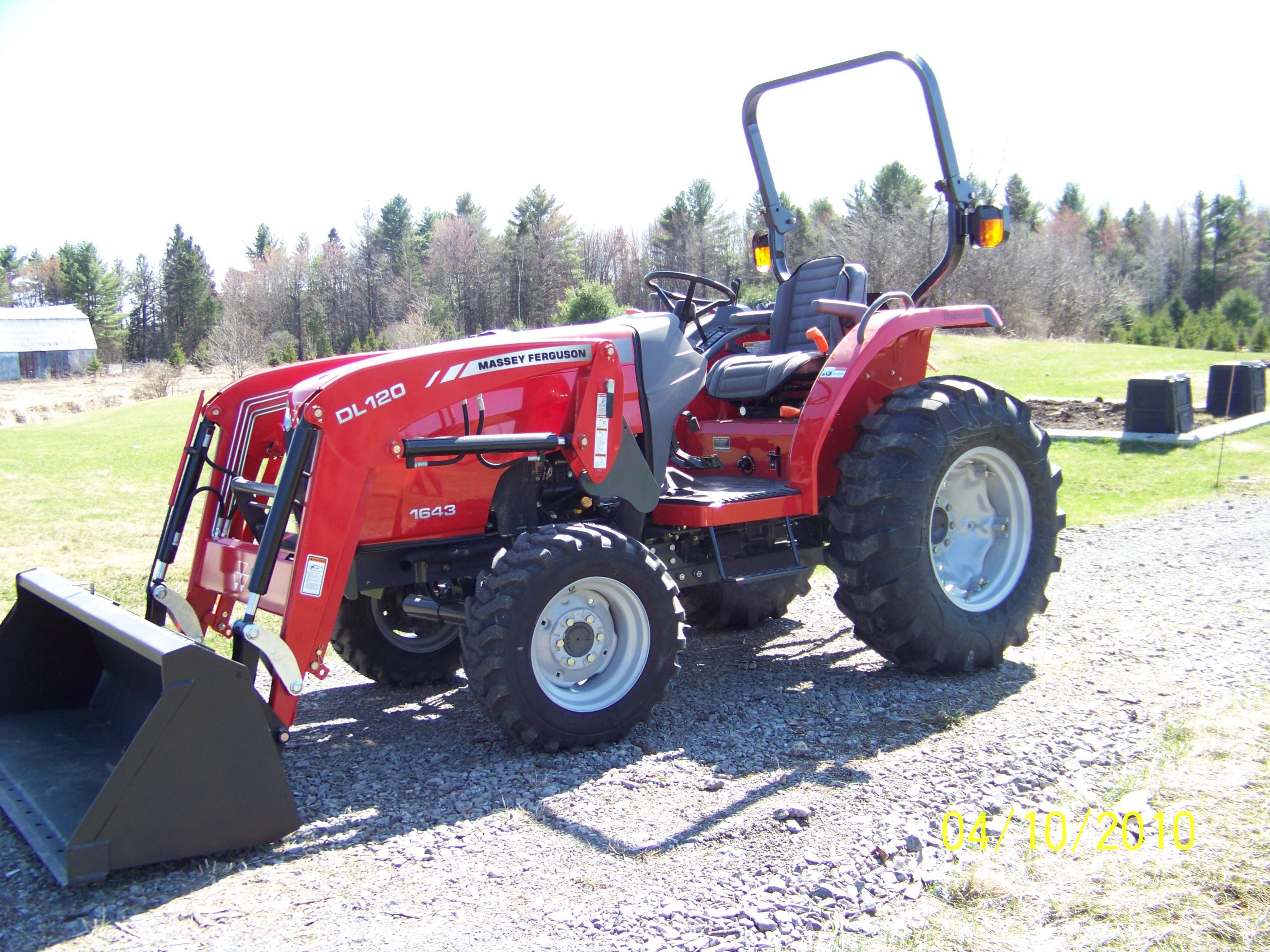

Here is a photo of my MF 1643, enjoy.
In the 50 to 60 Hp they have 3 models so a lot of choice . Check the hydraulic flow, and all the feature, you might go from blue to red but the choice is yours and all big names are thrusty. ( blue, red. orange green and some others). Good luck. Roger
