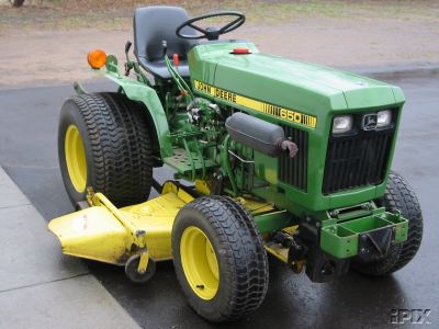

Good answer from Nick.
In the beginning the 850 was the only model that did not offer 4wd. But it had it by the time they ended production. I know that a power steering kit was available for the 650 and 750.
Here is a pic of my old 650.

Mrwurm,
What type and size implements did you use with your old 650?
I'm wanting to pull a bushhog, box blade, and finishing mower.
Thanks Men for all the info,
DC
/ Compact Utility Series #12
I ran a 60in mid mower. It had plenty of power for it.
I also ran a front dozer blade for snow removal.
Used a 6ft rake on the back to grade and level an acre or so. This implement really put a burdon on the engine. I had to run in low range to keep from overheating. I think 5ft implements should be the max.
