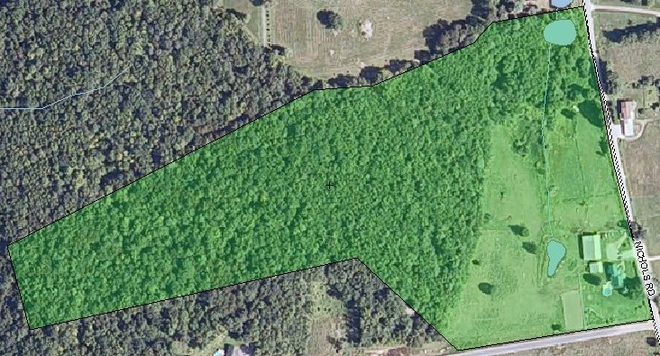

Sorry to do this to you guys and gals, it must get old. But, closing on the 26 acres - 21 woods, 5 pasture/barns/house/lawn (1/2ish acre) Tuesday. Land slopes down a bit from the house to the pond then up the hill to the west (left). Pretty gradual, easy walking without huffing and puffing.
Time to get ready for farm work starting with snow blowing. Future uses:
- In the woods to clean up and pull fire wood out - 1 tree at a time is fine with me, I'm not a forester.
- Potentially clear some of the woods just west of the south pasture for a fruit tree orchard if the land is good for that. Saw the backhoe "Ripper" threads, looks like a good way to go.
- Manage the pastures, possibly do some crop planting.
- Lawn mowing and mowing the orchard
- Fencing
Only stop so far was Massey. I kind of figured I was looking for something in the 35 HP range after reading and getting advice on TBN. After talking to the sales guy, he is going to work up a price for a 1533. Loader, front snow blower, rear discharge finish mower, backhoe.
I suspect the price will stop my heart, right before SWMBO sticks a knife in it if I try to buy new. So I hit Craig's list and found a number of tractors. Perhaps you can offer suggestions. No arguments for a rear blower please - already decided against that. I know a well maintained tractor can last decades. I understand the part about having to check out the equipment (will need a knowledgeable person for that!). All are HST 4WD, none have lots of hours for their age. Listed in order of increasing HP. And GEEZ I wish these guys would put unimportant things like tractor year, tire type, etc on the posts:

Another potential use for the hoe would be rock removal. The high res ANR photos don't show a lot on my property, but a lot on the property to the north. Could be I'll have a bunch just at the surface or not big enough to show on the sat images and I'd rather not mow rocks in the fields. Obviously not going to remove 20 ton chunks of ledge, but if there are 'reasonable' sized chunks in the fields or where I *think* I can put in the orchard, I think the hoe would be the only way shy of hiring a big rig at how much an hour? I kind of envision a little something here a little something there as time and need permits. That's why having the implements to do the job makes sense to me.
