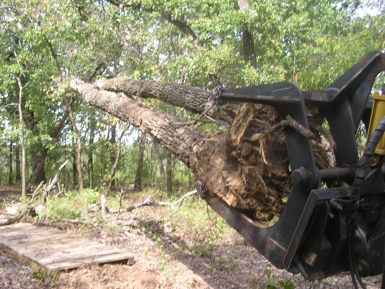

Hook the chain to the grapple and back out while looking it the 7 inch monitor with the rear camera on.
This is when 4 wheel steering really helps.
Or I'm I asking too much of this magical machine?

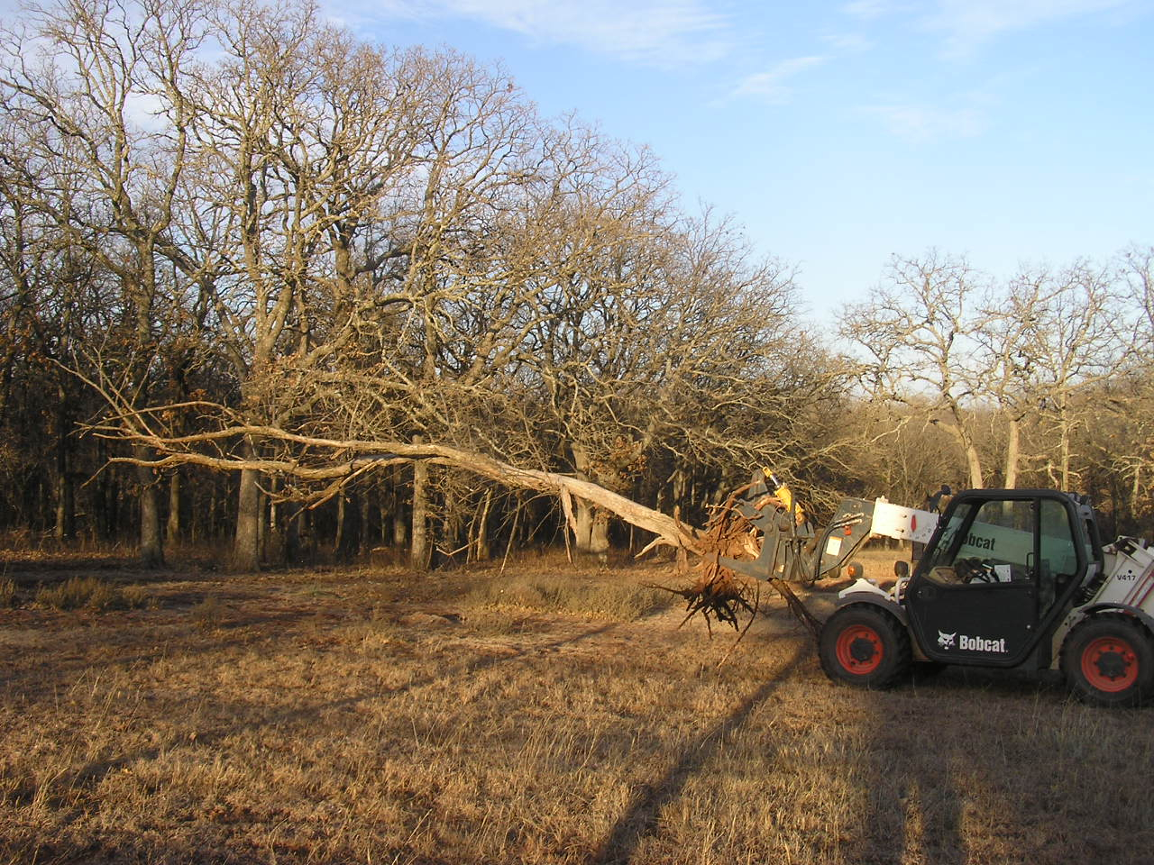

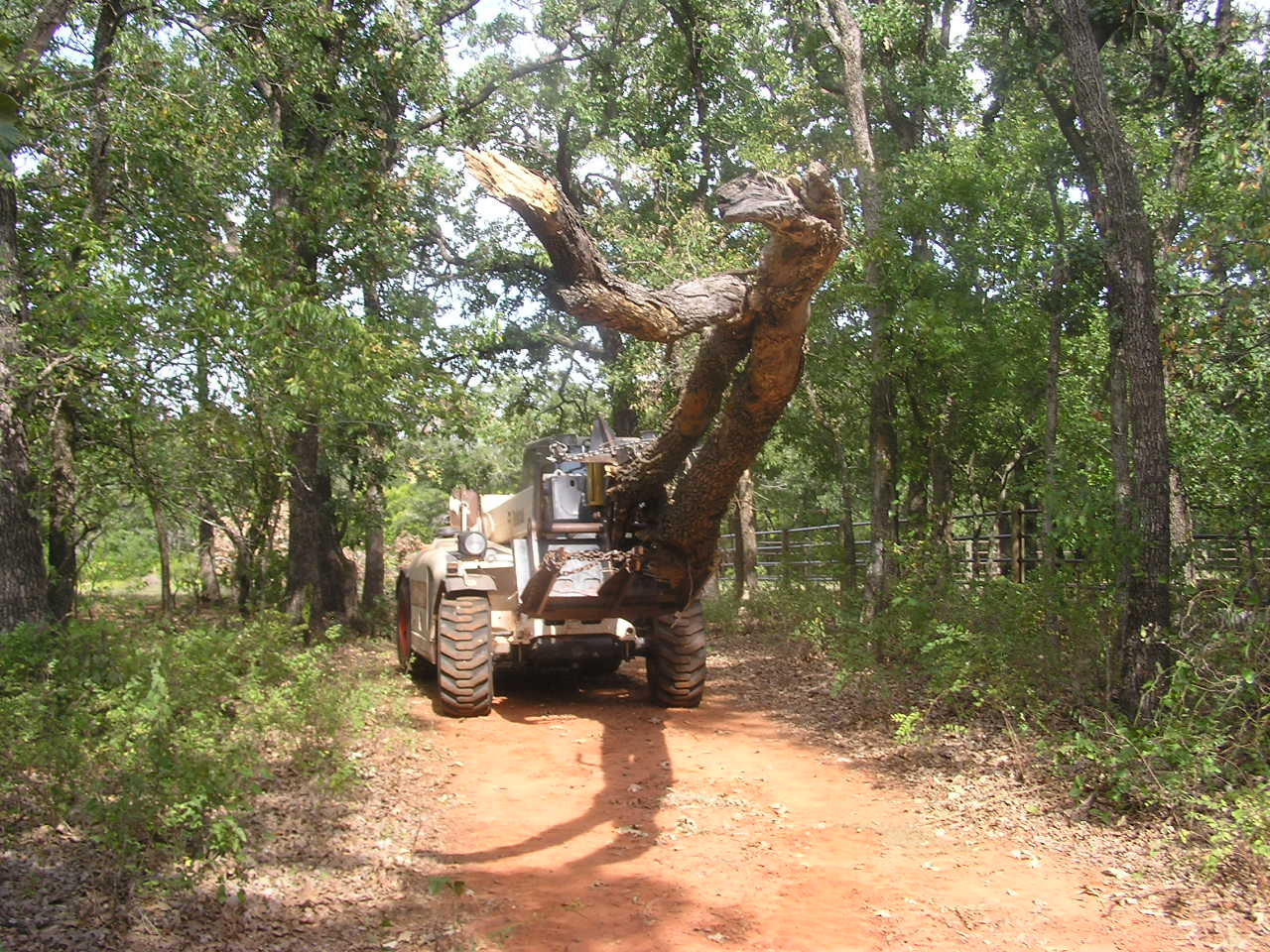

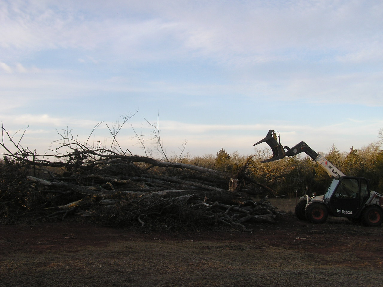

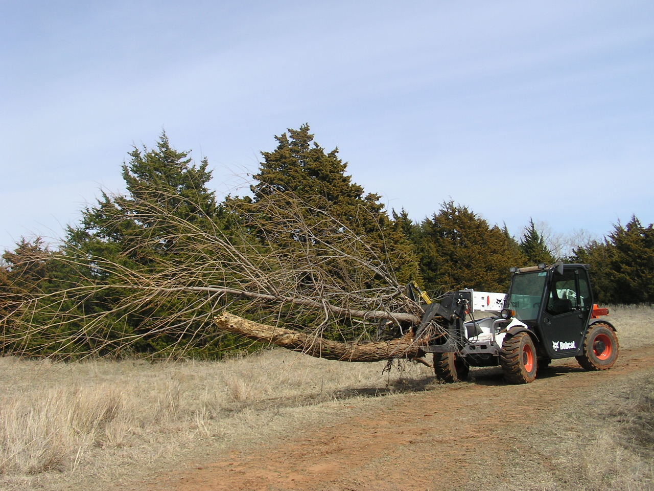

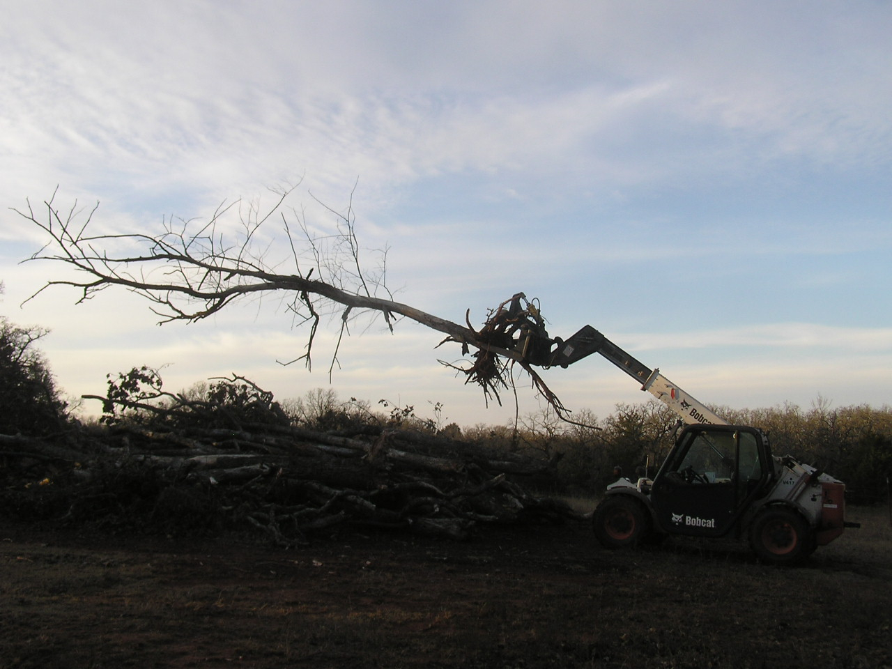

Here is one way that I have removed dead tree trunks from the woods:
And a willow tree and a dead trunk:
   / Compact telehandler #303

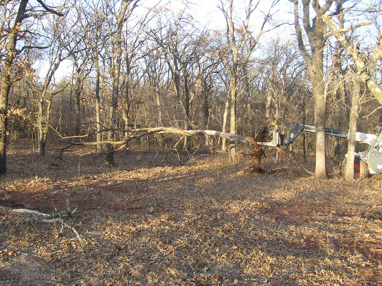

Found some pictures of moving a tree by the root ball:

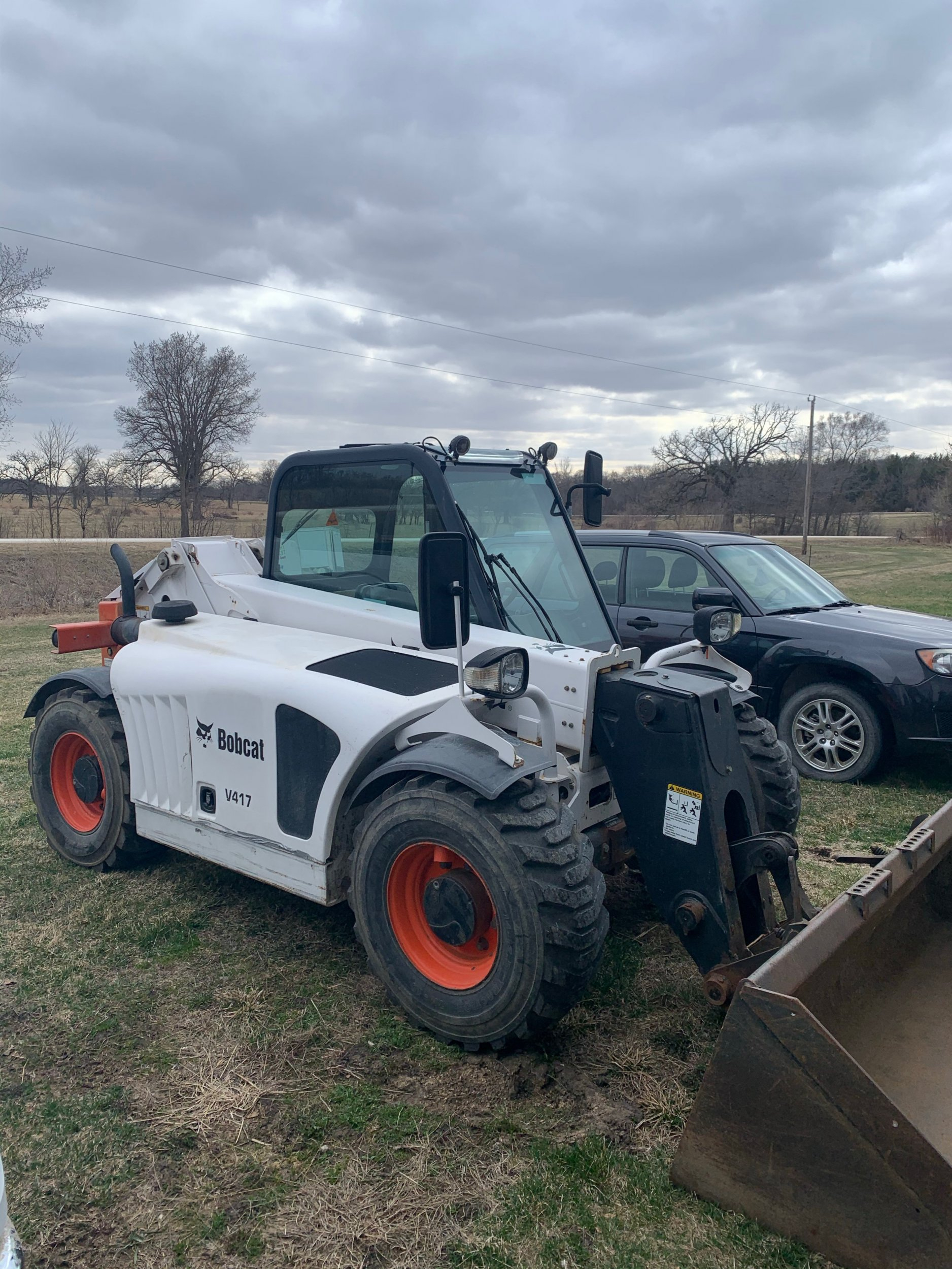

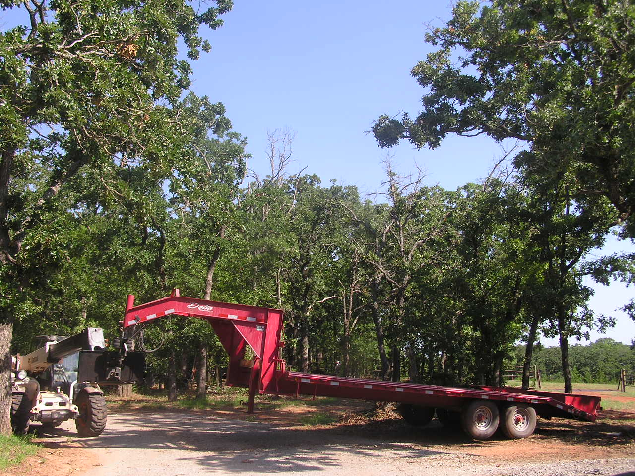

No action shots yet but here is a quick photo of the new to me V417 after unloading it from the trailer. Thanks for all your help Xfaxman you are a wealth of information!!!
   / Compact telehandler #310
You're welcome, glad to help.

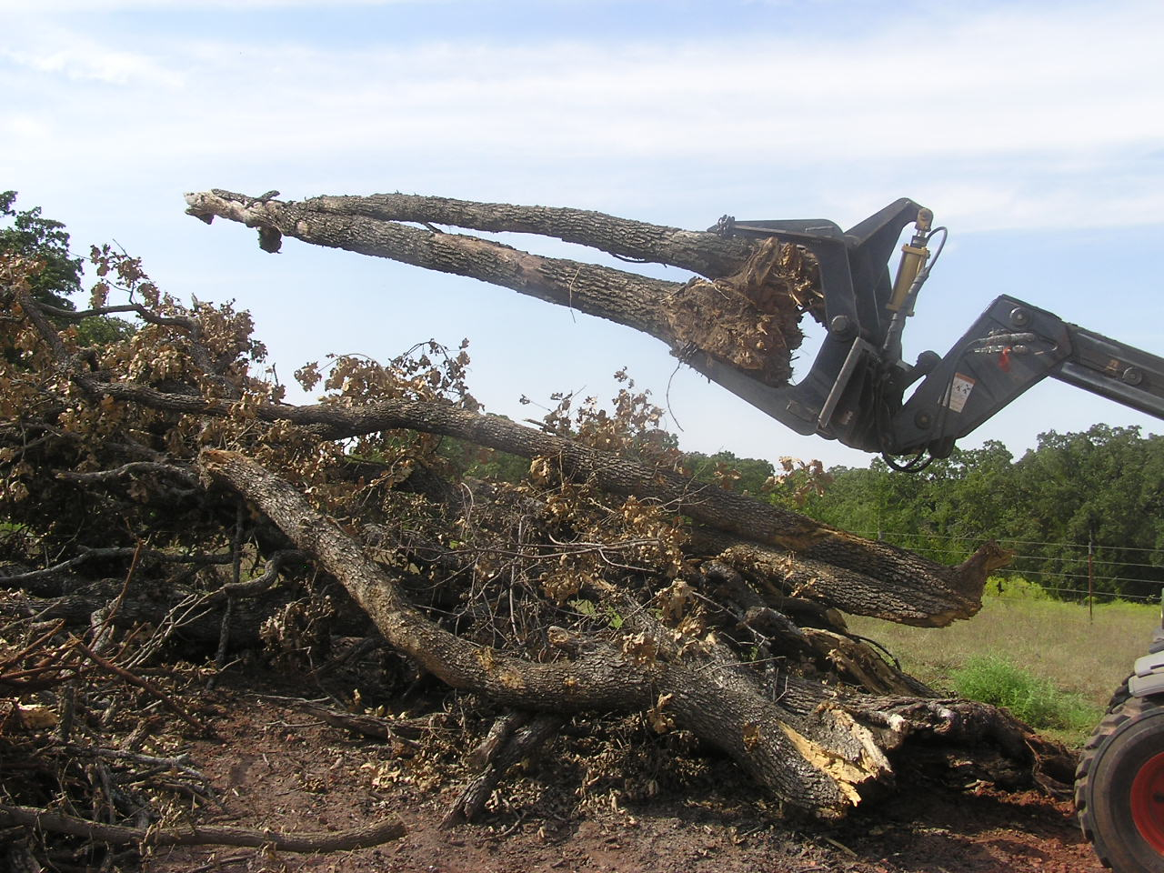

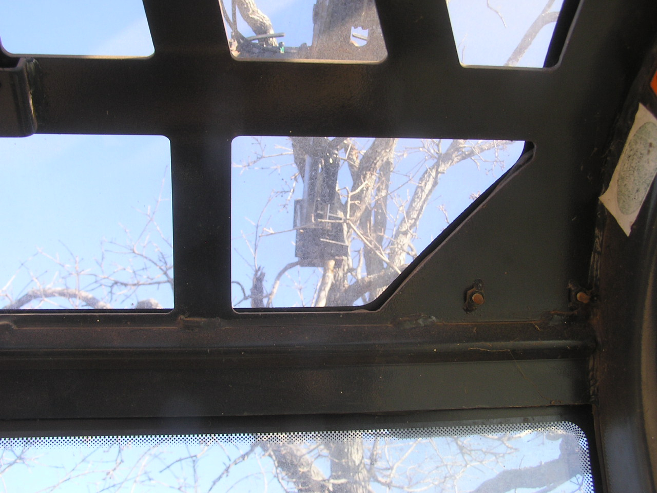

And this is the view of the tree puller through the FOPS roof. The glass is on top of the metal:
