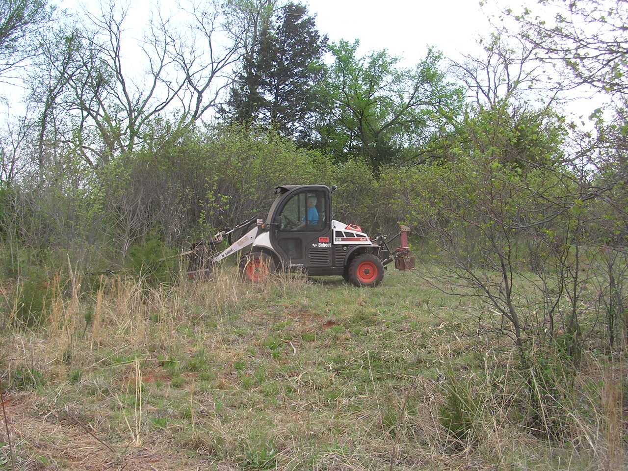

I guess my first concern was ground clearance.
How would one go about lifting and walking a hitch of stems out of the woods with such a conveyance?
Or I'm I asking too much of this magical machine?
Either you would pick them up and carry them on the forks on the front, back out pulling them from the forks on the front or get one with a three-point hitch and use the same setup as you would use on a tractor.
Aaron Z
/ Compact telehandler #302
Ground clearance has never stopped it. The bottom is steel and smooth. Driving over a big log, it slides with the front wheels in the air until the rears spin. Then extend the boom, it will teeter totter on the log, the back wheels will go up, the front wheels will come down and pull it off the log. I have done it many times.
Hook the chain to the grapple and back out while looking it the 7 inch monitor with the rear camera on.
This is when 4 wheel steering really helps.

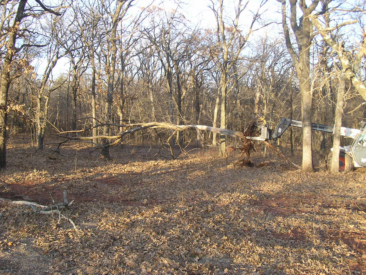

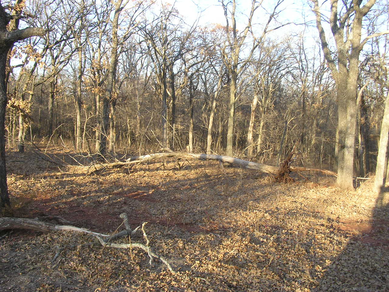

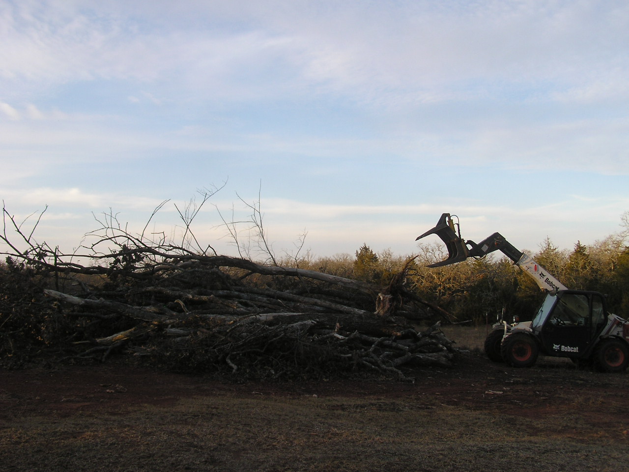

Here is one way that I have removed dead tree trunks from the woods:
And a willow tree and a dead trunk:

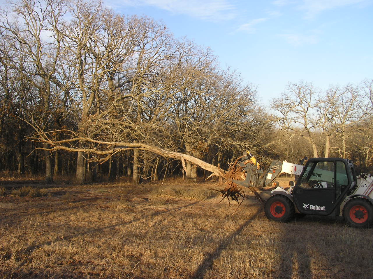

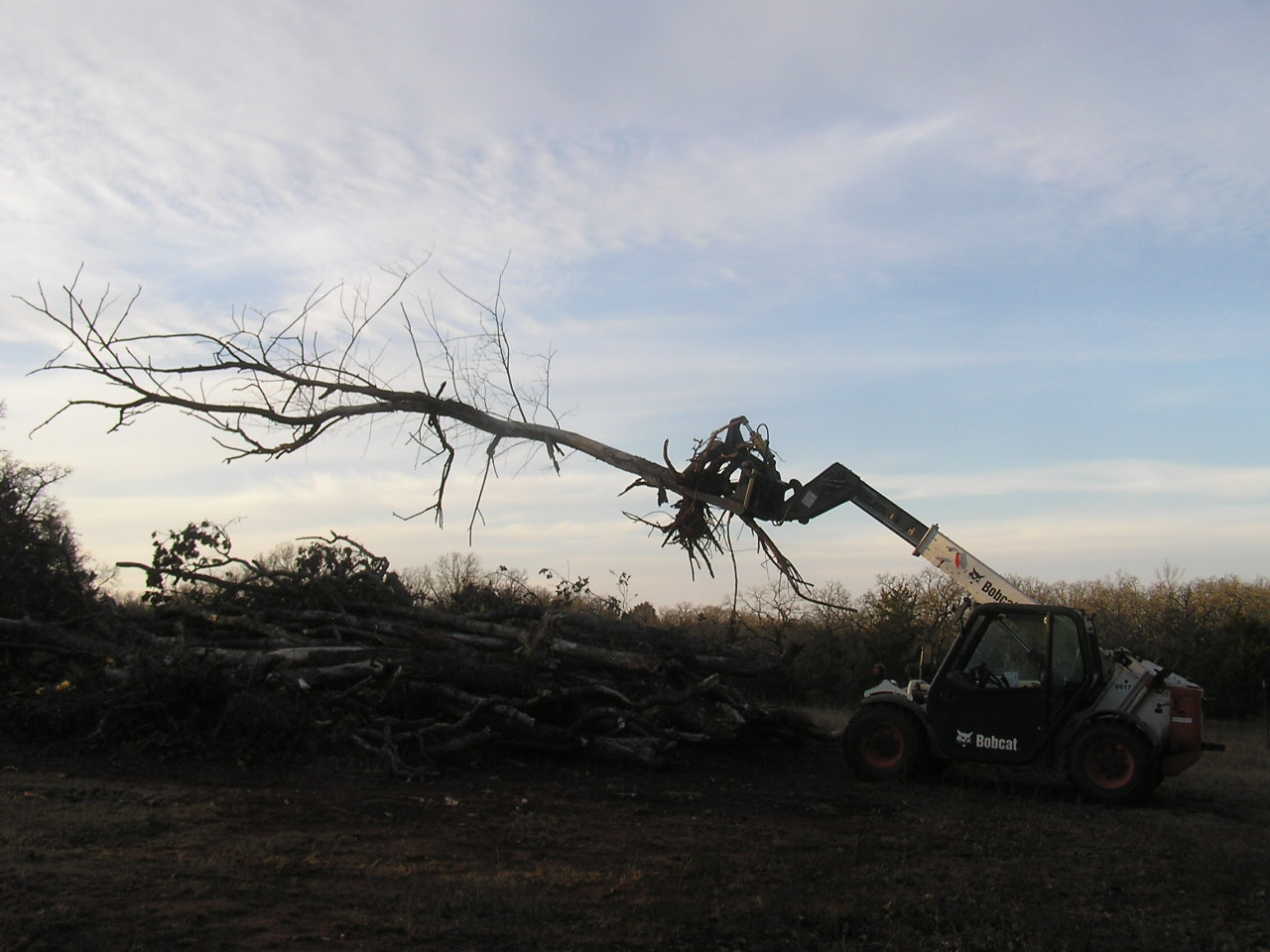

Found some pictures of moving a tree by the root ball:

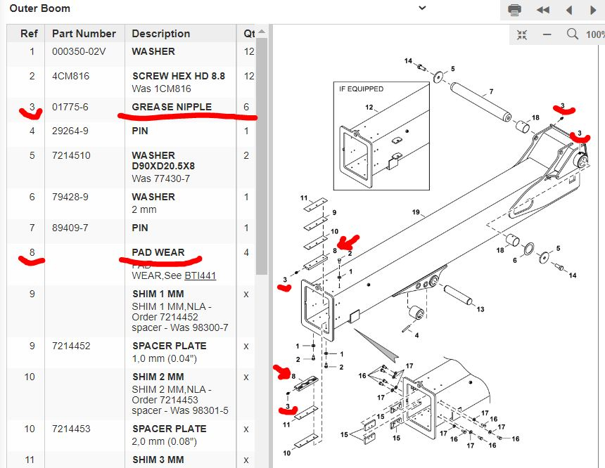

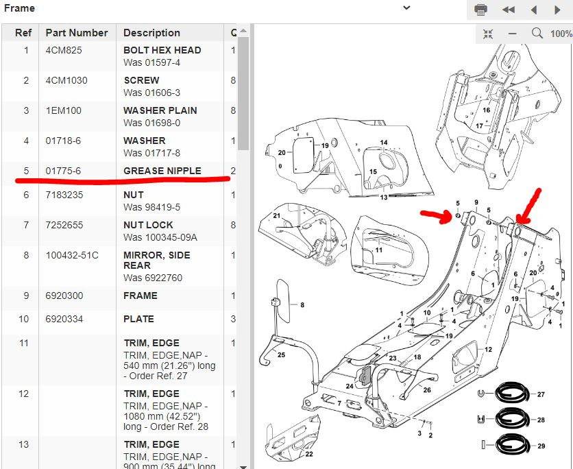

Can someone tell me/show me where the zerk is for greasing the boom? Its my first time hitting the zerks and i left paperwork/manual at home 4 hrs away-mowing and moving stones for stone wall in am-thanks!
/ Compact telehandler #313
No zerk. Extend the boom all the way. Put grease on the the slide areas top, bottom and both sides.
/ Compact telehandler #314
As Xfaxman said, no zerk for the boom slide itself. There is a zirk on the pivot at the base of the boom though. You have to lift the boom all the way up and look at the base of it to see it. You really should put the brace on before crawling in there to access it...

Your V519 is a little different, but don't see the zerk you referred to:
The new V417 IPB shows zerks on the wear pads that mine does not have zerks on.

Your V519 is a little different, but don't see the zerk you referred to. The new V417 IPB shows zerks on the wear pads that mine does not have zerks on
It would be the drawing that shows the hydraulic ram, I bet. It's on the pin / pivot the hydraulic ram braces against under the boom, and I think there's one on the pin that the ram pushes against too, but can't remember for sure. Greasing the boom it self is just as you describe. Run it out, put some on each of the areas where the pads run, then run it back. I usually do the back part and let is squish it out to the end rather than the whole lenght, otherwise too much swept off. If I'm feeling really industrious, I'll pull the boom in while the bucket is pushing against the ground once, rather than just with the bucket floating in the air, because that sepparates some of the pads from the boom on the bottom side.
/ Compact telehandler #317
Thanks! My 417 does not have pad zerks either. Not knowing, and in a hurry, i just greased the boom by hand, but thinking “this cant be right”. I just turned 50 of my hrs on it-and boom was getting dry. Generally how often are yall greasing your boom?-just eyeballing it? just got home and couldnt find anything as i scanned the manual i use
