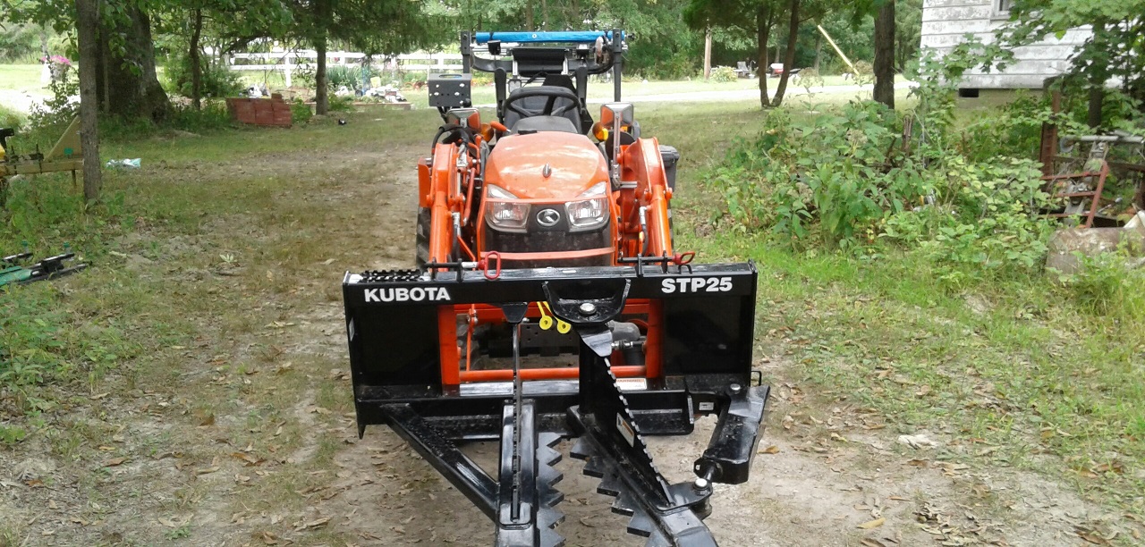

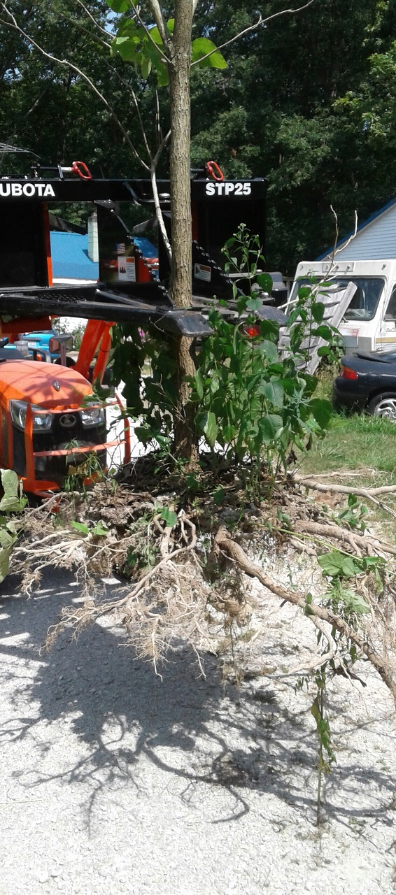

I'm using my grapple (54" EA single lid wicked root grapple) on a DK4510HS to pull out invasive Asian Bush Honeysuckle from an overgrown forest. I've got my technique down so most of the plants come out pretty easily, but occasionally I come across an older one with roots underneath boulders in the soil. I don't have much option on these but grabbing from above and lifting. Those roots have enough strength to lift my fluid filled rear wheels if I pull straight up with the FEL.
Unfortunately, my flail mower is wider than my tractor, and can't be maneuvered in the forest. So, I can't use it as a counterweight. What's an inexpensive option to get some weight behind my rear tires? I have a couple preferences, in decreasing importance order
1. I don't want another project. Setup shouldn't be complicated.
2. It needs to work well.
3. It needs to be compact and durable. The honeysuckle is surrounded by trees, rock walls, and random boulders.
4. It needs to be relatively inexpensive.
5. Ideally, it would be multipurpose, and be useful for something other than being heavy.
Any suggestions? I've been considering a boulder (I have plenty) chained to a 1000lb TSC carry-all, but I fear that it will fall goals 1 and 2.
Thanks!

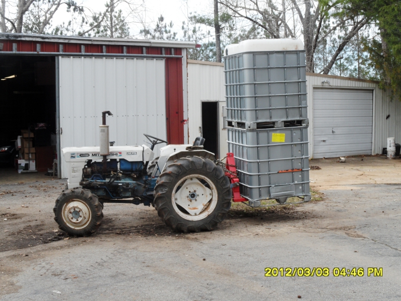

How about a 3 pt hitch pallet fork with a 250-300 gal plastic IBC tote on the forks?
Then fill the tote with water to your desired ballast weight and go have at it.
:thumbsup::thumbsup::thumbsup:
Or pour dry sand in it till you find the right balance

/ Compact durable FEL counterweight #10
