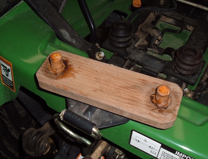

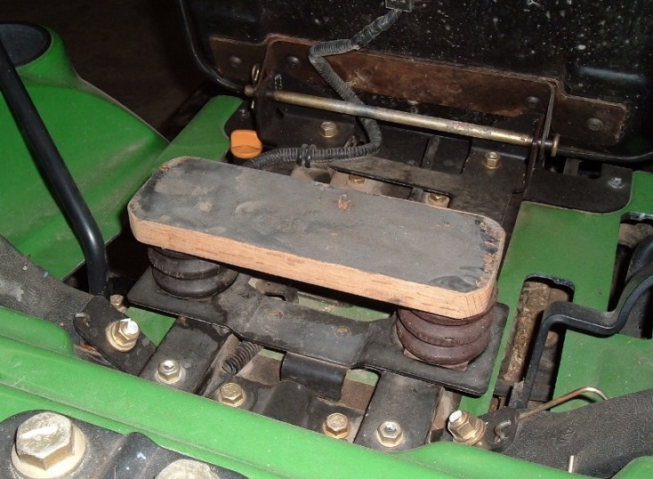

Fdmars, I agree for the seat. Would you have some pics of your set-up?
   / Coming clean #17
Henri88, at this time very simple set up, a (danger all measurements are from memory) 13" long 4" wide 1/2 thick peice of wood just sitting on the 2 rubber seat mounts under the seat. will at some point try and affix better, but to date has not moved around or caused any issues.
Fred
   / Coming clean #18
Fred
OK, so if I understand this right,it would lift the rear seat by 1/2 inch giving a more strait angle to the back rest. Very simple, going to try it. Tx.
   / Coming clean #19
This makes the angle much more comfortable for me. I used to have foam glued on top for a little smoother ride while pasture mowing. I now lower the tire pressure way down and it works much better.
   / Coming clean #20
Davkir, very nice, that is the set up I was looking for to keep my peice of wood in place. Thanks for the idea.
