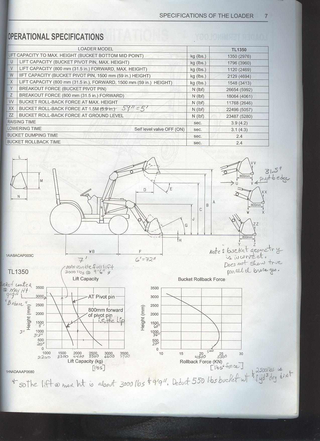

Being a little bit scientific can save a lot of time. I'm know I'm just following along here, but if you are going to compare max system pressure, it will help to know how system pressure relates to the load in the bucket.
In your workshop manual there will be a table of loader lift versus height that will give you a feel for that relationship. It varies with lifter geometry; I'll copy one such below. By solving triangles and roughly approximating the cylinder surface area you can solve for pressure required to do that lift, and the graphed numbers can be used to check your figures.
I think what you will find is that working stationary pressures are not only lower than max, but often far lower. And you can see immediately that geometery has a huge effect. When the loader arms and cylinders are closer to parallel it takes a lot of hydraulic pressure to raise the arms at all.

thanks for the extra info. it is much appreciate. my chart is actually in the loader manual and I just pulled it out this week to see if I could lift my pallets of stone. my lift capacity at ground level is around 3300 lbs which i'm assuming is at max system pressure but I understand what you are saying. is the TL1350 the M59 loader. Close to 50% more capacity than my LA854
those charts are max capacities at max system pressure. but I agree most of the time we are not maxing out the system. I have my tee actually installed in the system and capped. I just need to find the time to hook a gauge to it and measure system pressure with an empty bucket and with a loaded bucket.
