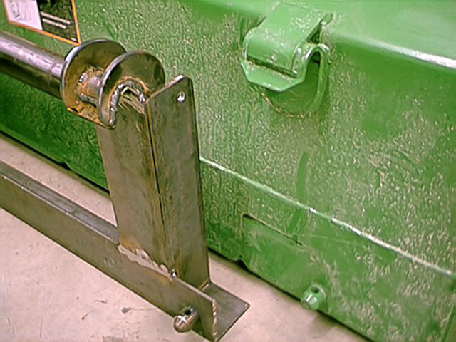

   / Combo Base frame / material handle tine attachment #23
Yes, I would like a picture of where the quick tach connects with the base of the fork or the back of the loader bucket. I'm interested in how it attaches so I would have an idea of how to contruct one. For instance, does the base part of the implement go into a 'cup' or something like it and the top of the base gets a pin through some hole to lock it into place? I would like tocontruct something that is easy to connect/detach yet stong enough not to come undone.

Here is a photo showing some of the details you may be looking for Jason. Another photo will follow. It may be necessary to go to a JD dealer to get the whole idea. Ask if questions...

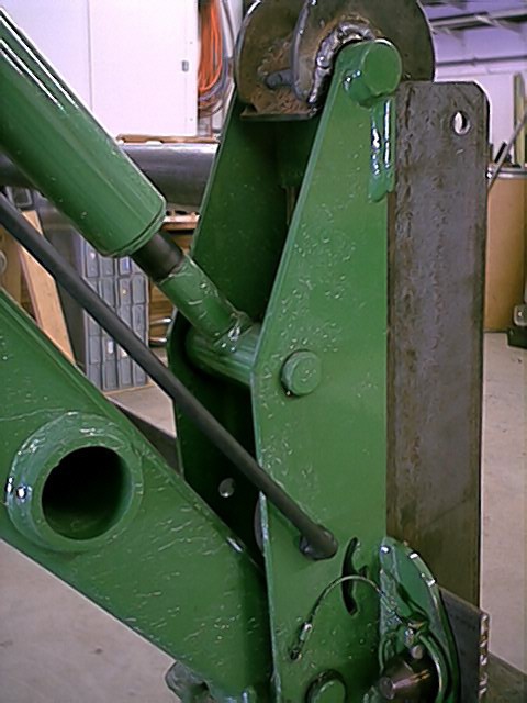

Here's another shot. This shows it attached to the loader boom. Notice the Lynch pins at the bottom, dropped through the machined stub shaft pcs.
I made the upper curved receiver fittings by starting with some 1" pipe sections. and once the shape was obtained, I added the huge gussets you see, on each side of the pipe sections. Those gussets go down inside the front of the vertical channels, are welded vertically to the channels. Hopefully you can see how my solution is probably overkill compared to the JD stock bucket fittings. They used a couple of pcs of formed flat iron. Sometimes I get carried away, all in fun.

I disagree, the stock JD piece is not heavy enough. Your soultion looks much better !!!! Thanks for taking the time to get the pictures to me. I have saved them and will be using them when I make up a quick hitch later this summer. Please keep us informed of your progress on each new project. I have a Lincoln Arc welder in the basement and will hopefully put it to good use this summer. Thanks again for the effort, great job /w3tcompact/icons/smile.gif

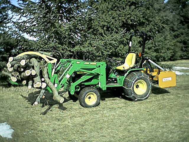

#30
Action shot. This was a live Oak tree. This stuff was heavy. the pcs shown in the grapple are about 7 feet long each. There were three small loose piles, I scooped up the first, dumped it onto the second, etc, until I had them all. One fell out, but otherwise what you see was one load. Made short fun work of the tree trimming cleanup.
