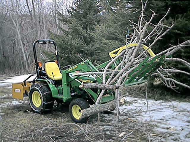

#30
Action shot. This was a live Oak tree. This stuff was heavy. the pcs shown in the grapple are about 7 feet long each. There were three small loose piles, I scooped up the first, dumped it onto the second, etc, until I had them all. One fell out, but otherwise what you see was one load. Made short fun work of the tree trimming cleanup.

/ Combo Base frame / material handle tine attachment #33
Great pics. I love action shots.
That grapple is impressive. I didn't expect to see it holding so much. Good job!
