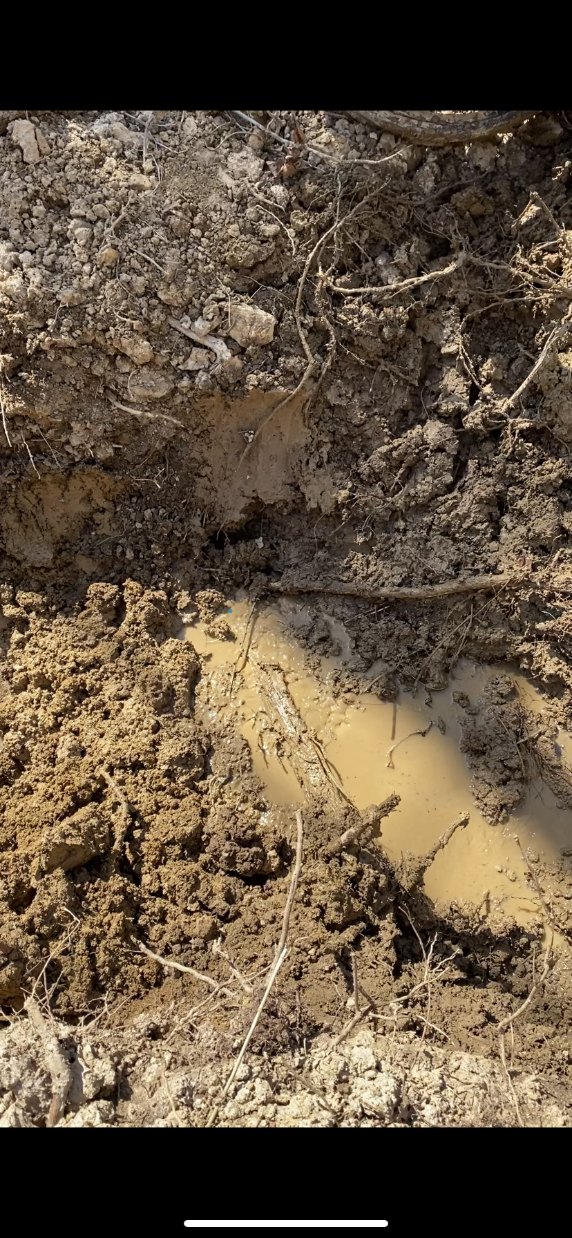

I’ve got a huge washout about 6 feet wide and 6 feet deep due to a culvert that was crushed years ago. I managed to use my tractor backhoe to fill it in and dig the culvert out but somehow the water is just leaking through the ground where I placed the dirt and running through into my field. I’m not sure what to do at this point. My dirt has a lot of big rocks in it which I thought was good but maybe I should’ve just gotten solid dirt. I also took out smaller trees/limbs/roots and added them to the dirt pile I was making which could be an issue. You would think this much dirt though would be under a ton of weight on itself and pack down good.
what do I do from here?
this creek is supposed to stay in the woods and run straight not turn 90 degrees and wash into my field. Thanks

I used to work for a irrigation district. When back filling culverts you were only allowed to use nice clean fill. No rocks or organic matter. Clay was best, not to wet and not to dry. Back-fill in 6" lifts or less and thoroughly compact every lift. If the ground was too muddy we could put a dry plug on each end and mix up a batch of mud in the middle and pack it around the culvert. That would also seal but you couldn't drive any equipment over the culvert till it had dried out a bit.

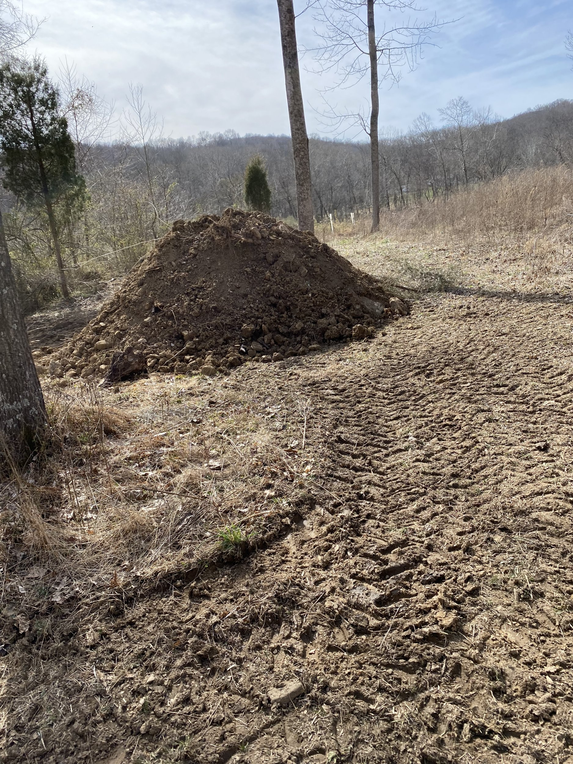

I’ve got another big pile of dirt. Would it be a good idea to dig out half of what I placed in it and smash/compact it down with the back hoe bucket and then place this on top smashing it down as I go?

The culvert is probably leaking underneath. There are only 2 ways that I know of to fix that. The best way would be to completely remove the culvert and start over. Make sure you place the culvert on a totally level surface with maybe an inch of soft crumbly dirt to lay the culvert on. Rent a jumping jack and pound down 6" lifts of dirt. The first lift is the most important. You need to make sure that the dirt under the curve of the culvert get's compacted. Make sure you use a spade and completely fill the void under the curve of the culvert. Make sure you compact under the curve thoroughly.
The second way is to put a good solid plug on each end. Two reasons. One you don't want the culvert to move and you need a basin the mix the mud in. I would mix some mud on one side and use the backhoe bucket to push it through underneath to the other side. It's slow going and a PIA but you need to get mud completely around the culvert. There are no short cuts to a guaranteed job. The more rock free the mud the easier to is to get a good seal.
Bentonite work to a certain extent but I'm thinking you already have a channel for the water to flow under the culvert. Bentonite seals seepage, not a channel.

The culvert itself will never settle. There's most likely a channel for the water to flow under the culvert itself.
You can use a tractor to pack the dirt around the culvert but it does not pack the dirt the extent that a jumping jack does. There are no short cuts to doing a proper job when it comes to water. Under pressure it will always find the path of least resistance to leak through.

Sorry for lack of pictures and maybe I’m bad at explaining myself. “Digging it” got it right.
The water was forced to turn a “unnatural” 90 degree turn when loggers broke the culvert. It busted. The creek is only 1 to 2 feet deep but the 90 degree turn washed 6 feet deep into the field past 18 years.
I drove my tractor on the “dam” removing some dirt with backhoe and then smashing it down inch by inch all the way across. This helped a ton I think. Still a good steady stream is coming out of the ground on the backside. I have another pile of dirt ready to go to make it another 4 feet wide or so and can plant grass seed on the backside?
Could be the creek is sitting 2 feet deep and the washout is sitting 5 feet deep just a few feet out?

Your spot on. I thought about throwing down some concrete mix but I just want to make sure the water will flow down stream before I do this or it would cause bigger problems.
It is flowing better after I smashed everything down with the backhoe. In summer time this creek dries completely which could make easier work if I concrete or clay it.
Could be the fact water hasn’t flowed that way in years and everything down stream is plugged up and the water is just sitting there too long. Maybe a good heavy rain will get it flowing faster with less time to sit?
