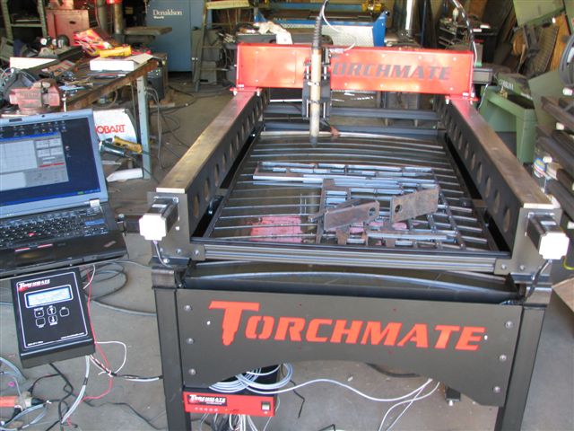

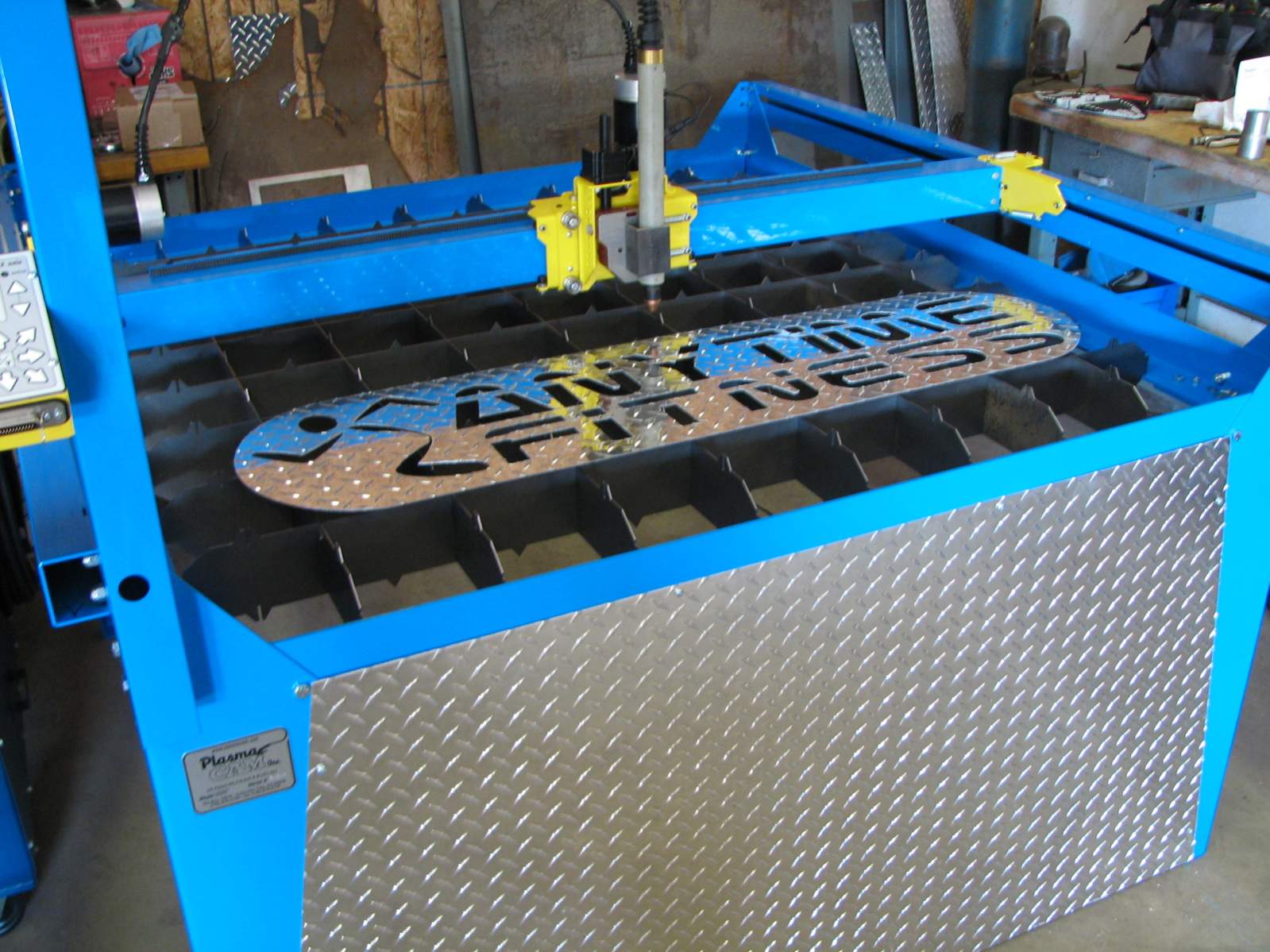

I own both a PlasmaCam 4 x 4 table (equipped with Powermax85 plasma) and a Torchmate 2 x 4 with AVHC (height control and Powermax45 plasma). I have owned the PlasmaCam (model DHC2) for over 10 years (had their earlier model 98Z first), and have had the Tochmate for about 1 year.
They are both great machines....here are some comments about each:

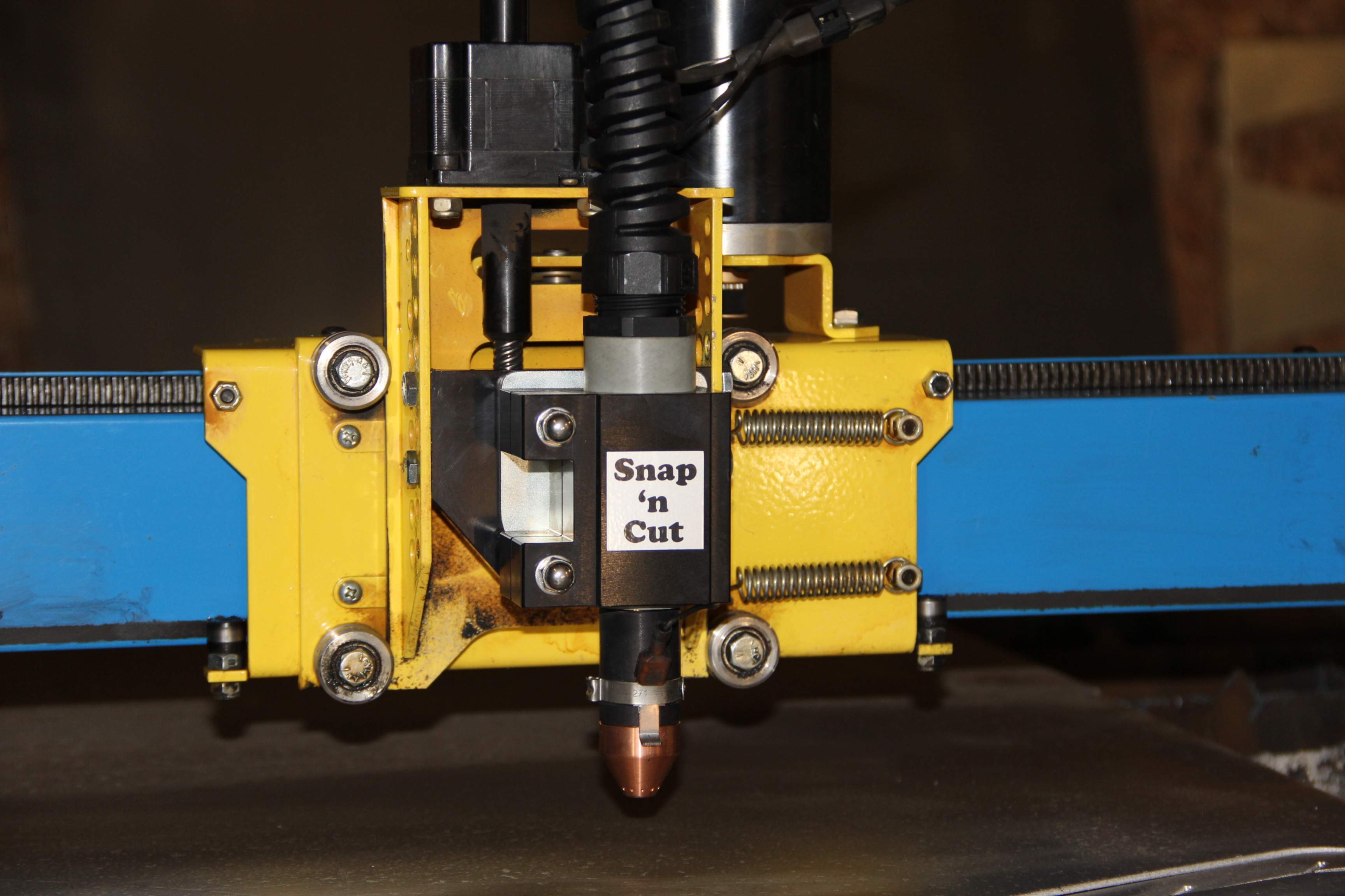

PlasmaCam DHC2. This is a 4 x 4 machine that comes standard with a really nice automatic torch height control system. Thes machines start at about $6800 now....but I suggest you upgrade the software to the point where it has full height control and plate sensing functionality. I paid $9900 for mine......now they are cheaper, but to get the same level of height control you have to get the right version of their "Design Edge" software. The software is extremely easy to learn and easy to use....even for someone that has never done CAD drawing. The machine comes with slats and an open bottom.....so no fume control. You must close in the bottom with sheet metal and duct it to at least a 3000 cfm blower or fan to move the smoke outside. With my Hypertherm Powermax85 I cut from thin gauge (26 gauge) to 3/4" with no issues.....I can cut thicker with an edge start just have not had the need. Cut quality is excellent. On thin gauge materials this machine has the ability to cut with good quality up to about 280 inches per minute....it uses servo drives which have a performance advantage over the stepper drives on the Torchmate.
Torchmate 2 x4 . I bought this machine with the Torchmate water table. It comes without slats.....so I fabricated slats from 14 gauge steel. The water tray allows water up to the bottom of the steel and controls fumes quite well. The water does splash on the torch , machine and materials being cut....and the slats have gotten fairly rusty. I use an electric stock tank heater in the water tray in winter (N.H.) in my shop as it is not heated when I am not there. I find that the software included with Torchmate has the ability to draw about anything.....although I found it much more difficult to learn....and I spend much more time at the machine setting up cut parameters and getting the torch and materials in the correct location for best material optimization....the PlasmaCam sems easier from this respect. Cut quality is nice on thicker materials, although the water creates a rougher cut edge.....lower the water and the edge gets smoother, but there is more smoke. This machine with the water table and AVHC was about $7800. The AVHC is necessary for best cut quality and long torch consumable life. Top speed of the machine is about 140-150 inches per minute....whih does not allow for best cut edge quality on materials thinner than 10 gauge.
I think if I had bought the Torchmate before the PlasmaCam....I would be reversing my story about the ease of use of the software! I find the PlasmaCam easier probably because I went through the learning curve first....and I am more familiar. Personally I like downdraft fume control better from a cut quality perspective.....but it does require over 3000 cubic feet per minute of air flow....and must be blown outside your shop. Water tables do affect cut quality...but likely are cheaper to build and operate. No reason why you could not build a water table for a Plasmacam or a downdraft for the Torchmate.
I use machine torches on both....not hand torches. Much easier to square to the plate, easier to change consumables, and easier to electrically interface.
Have had no issues with either machine....both companies have excellent tech support from my perspective. I am biased on the Hypertherm as I work for them! I am building a homebuilt cnc machine using a kit from www.CandCNC.com this winter for comparison.

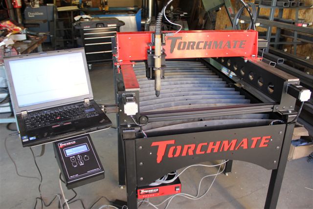

I also have the Torchmate 2 x 4 with AVHC (Automatic Voltage & height control) and a Hypertherm Powermax45 plasma with machine torch. I use the torchmate cad lite software (I am still learning it).
I did not buy the water table from them, I built my own.
I have cut 26ga accurately with it. You have to reduce the pierce delay.
I am in to it for about $10k (CNC table, water table, software, and plasma)
I am very happy with the setup. It works very well. I had it up and running within a couple hours and I was using it to help build the water table.
There software it very configurable. and there support is top notch.
If you have any specific question let me know.

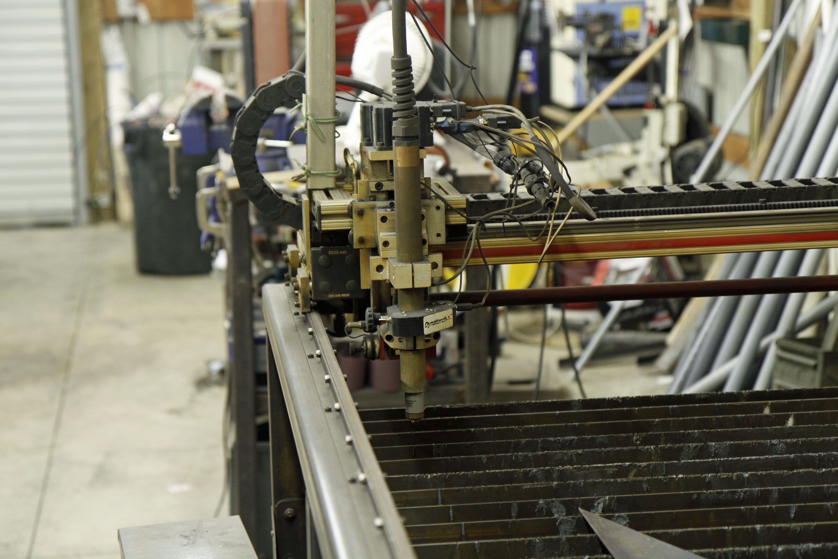

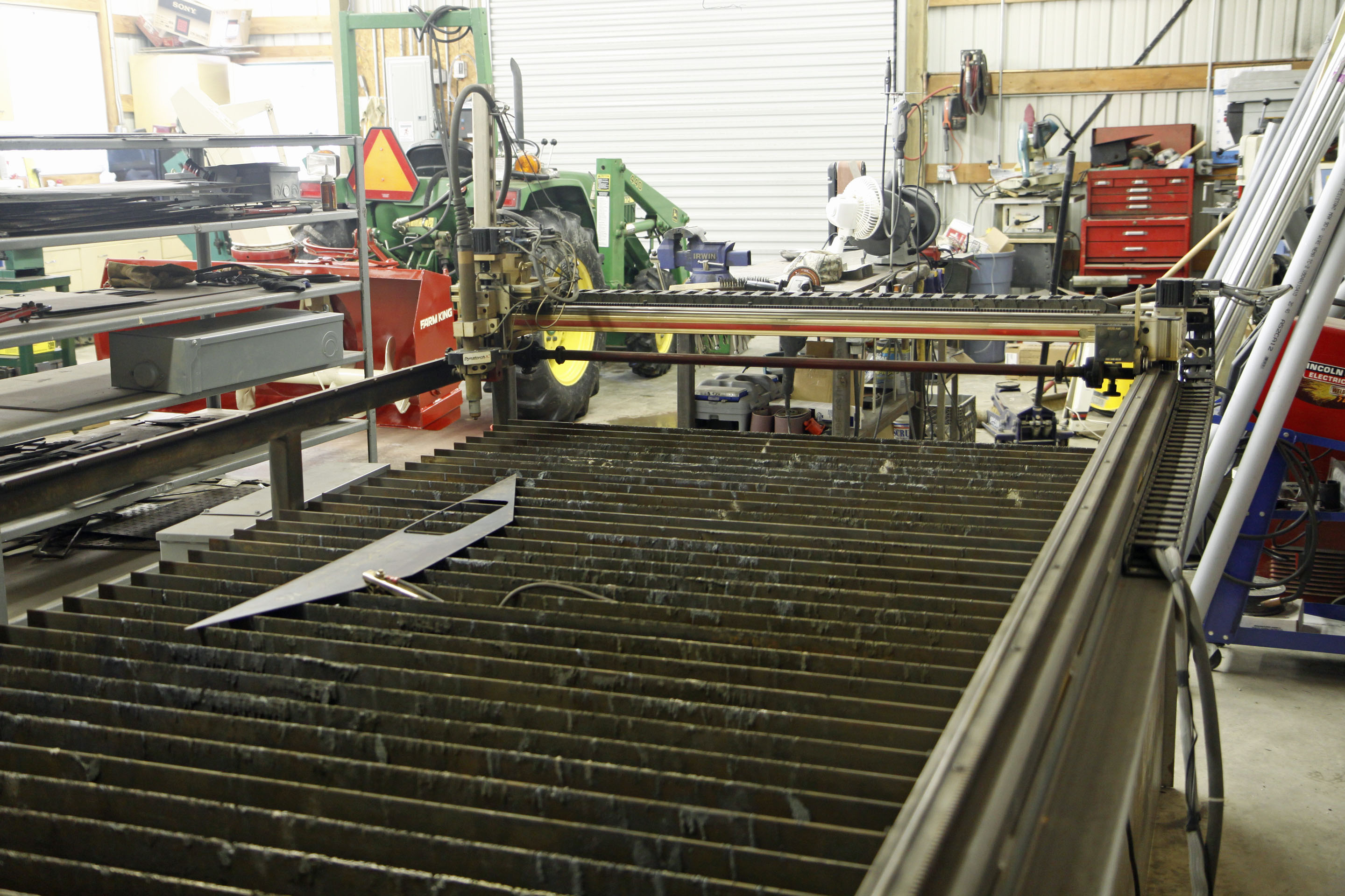

I have a 2005 era Dynatorch machine. Its not really a hobbyist machine and was in the $11,000 range (not counting plasma cutter machine).
Since then i have upgraded it with their DASH system (a laser guided material locator that allows cutting without the cutting head ever touching the stock), a powered laser locator (for viewing where the cut will actually take place on the metal) and a collision avoidance device to protect the head.
I believe their equipment will only run with a machine head on the plasma cutter (at least mine is that way).
The learning curve for me was a little long, as i had no previous experience with the machine. But i really do like working with it.
The tech support at Dynatorch are FANTASTIC. There's a guy named Leon that will spend whatever time you need on the phone to assist you...even 6 years after the purchase.
Their software is continually being updated, but you have to pay for a yearly subscription update if you want it. I use it because everytime i upgrade it, i get alot more choices and control over my machine.
They offer alot of different software packages. When i started i was using CoralDraw for my artwork (I have Autocad but it takes too long for th stuff i do). Since i didn't buy their software, all i have to do is convert my coraldraw art to a BMP (very easy) then import it to a program called Vextractor to create an image of the outline (as you cut the outline of your design). This creats a DXF file.
I import this DXF file into a program called Enroute. This program automatically cleans up the image and sets the start and exit parameters for the cut. After i save this, i send it to my plasma table to cut.
I know it sounds complicated, but after a little practice, it becomes really east.
Say i want to create a plate with 9 different sides, all lengths known. I draw it in Coral, i convert it to a BMP (5 seconds) and import this to vextractor. Vextractor takes about 15 seconds to convert.
I then import it into Enroute and this program also only takes 10-15 seconds. The great thing about Enroute, lets say i need 20 of these weird brackets made, i can tell it i need 20 and the program will automatically arrange the cuts to waste the LEAST amount of metal. It can flop the cuts thru all planes.
Im sure some of the software that Dynatorch offers nowdays would be easier to use, but back in 2005 this is all they had. Enroute cost me $1,300 so im in no hurry to change it out. Heck it works fine and is fast.
