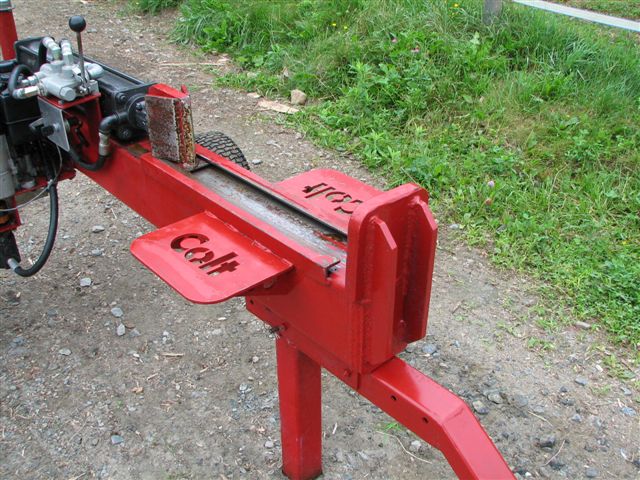

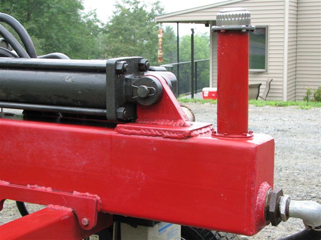

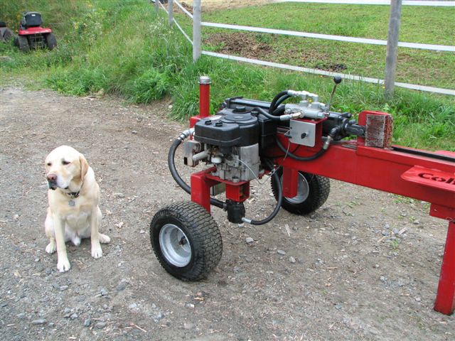

Attached are a few pictures of a log splitter....all parts cut in my shop with either the Torchmate or the PlasmaCam....
Jim Colt
Log rest plates with my name cut....ensures when it is borrowed that it comes back home....the cyclinder trunnions, the motor mount....the ram and the wedge are all cut on my machine.

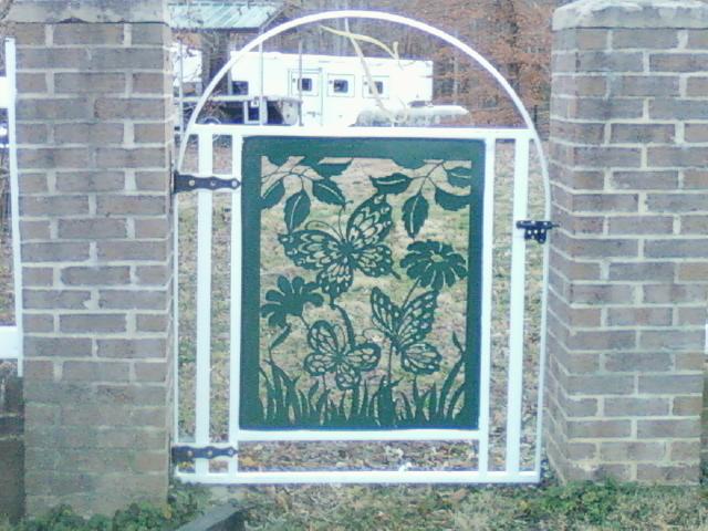

This has been on my to-do list for awhile, my yard, always last. This pic. isn't final look.
