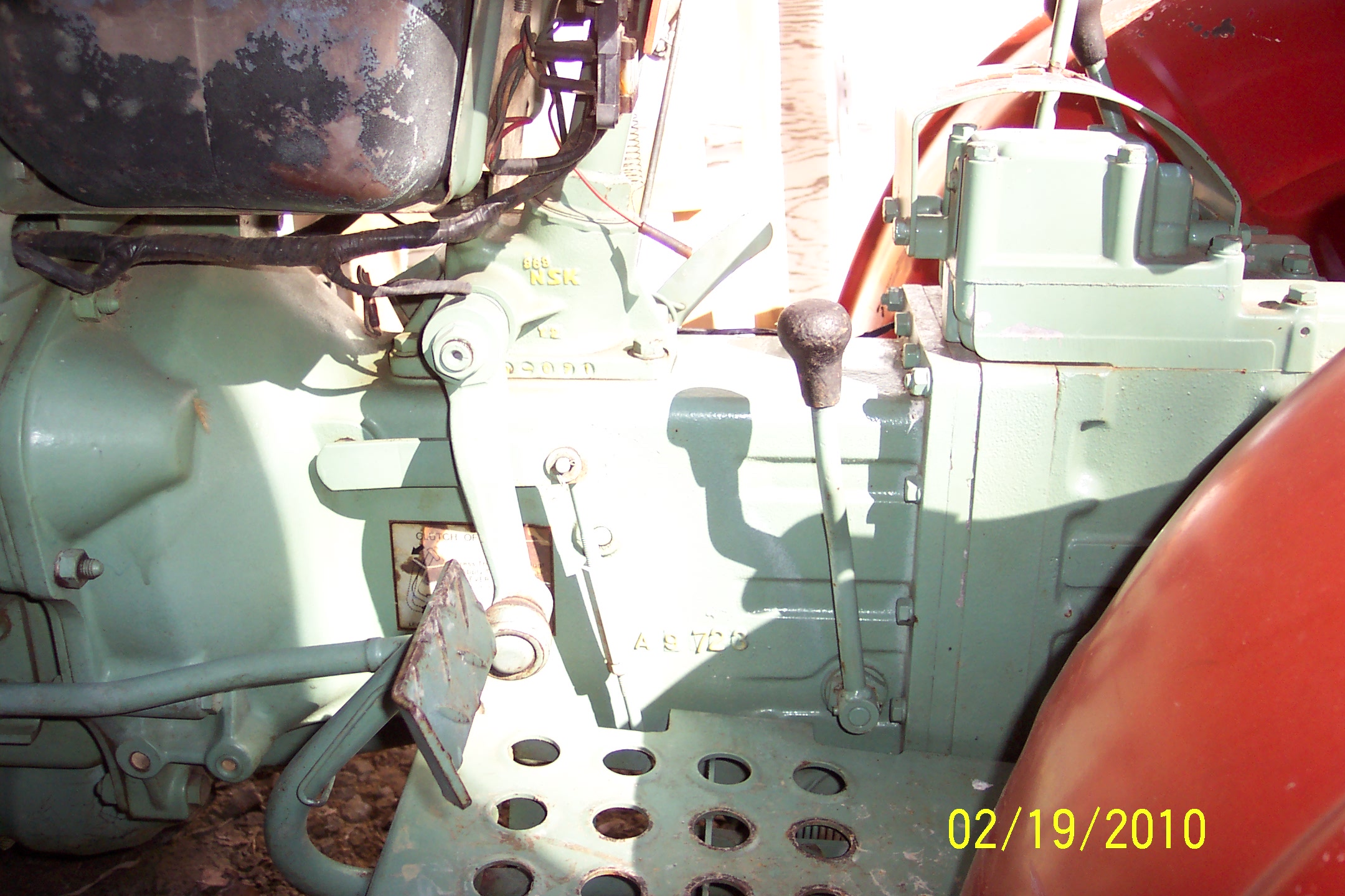

Does anyone have a Pic. of the latch would you? the reason I ask is my eng Ser.# is the same as the 2000BD 2TR20A but I do have a -A after it also. On my Trans Ser# 15000 I have nothing that even looks like there is or was a latch. The Eng. may have been replaced or possible may have been be a VN recon at one time? Could be no ROP's and just wondering if I should come up with a way to latch down the clutch pedal before I end up with the same problem if I let it sit ?

Carey, my YM240 has the same engine, 2TR20A-X. Here's a photo showing my latch. It is bolted to the transmission case about halfway down, behind the most-forward part of the clutch pedal assembly.
I have never used mine, and never had any trouble. I don't see why these clutches are any different than in say a Nissan which is probably the identical clutch. I expect Yanmar designed that for worst-case, ie running half submerged in the rice paddies then putting the tractor away wet and storing it for months until next season.
ps for anybody interested - the pic shows the loader's bracing to the rear axle which takes some stress off the bellhousing. And the 'old man step' I added. I posted that picture here originally to illustrate that step.
I never would have thought that over the years Yanmar used more than one setup for that latch.

Not there Cal. If I look hard I can see something in the casting for the screw hole to be drilled or knocked out possibly? I store it under a car port and the new to me has been long gone so if it's raining outside I'm not going to use it unless I have to ;)
