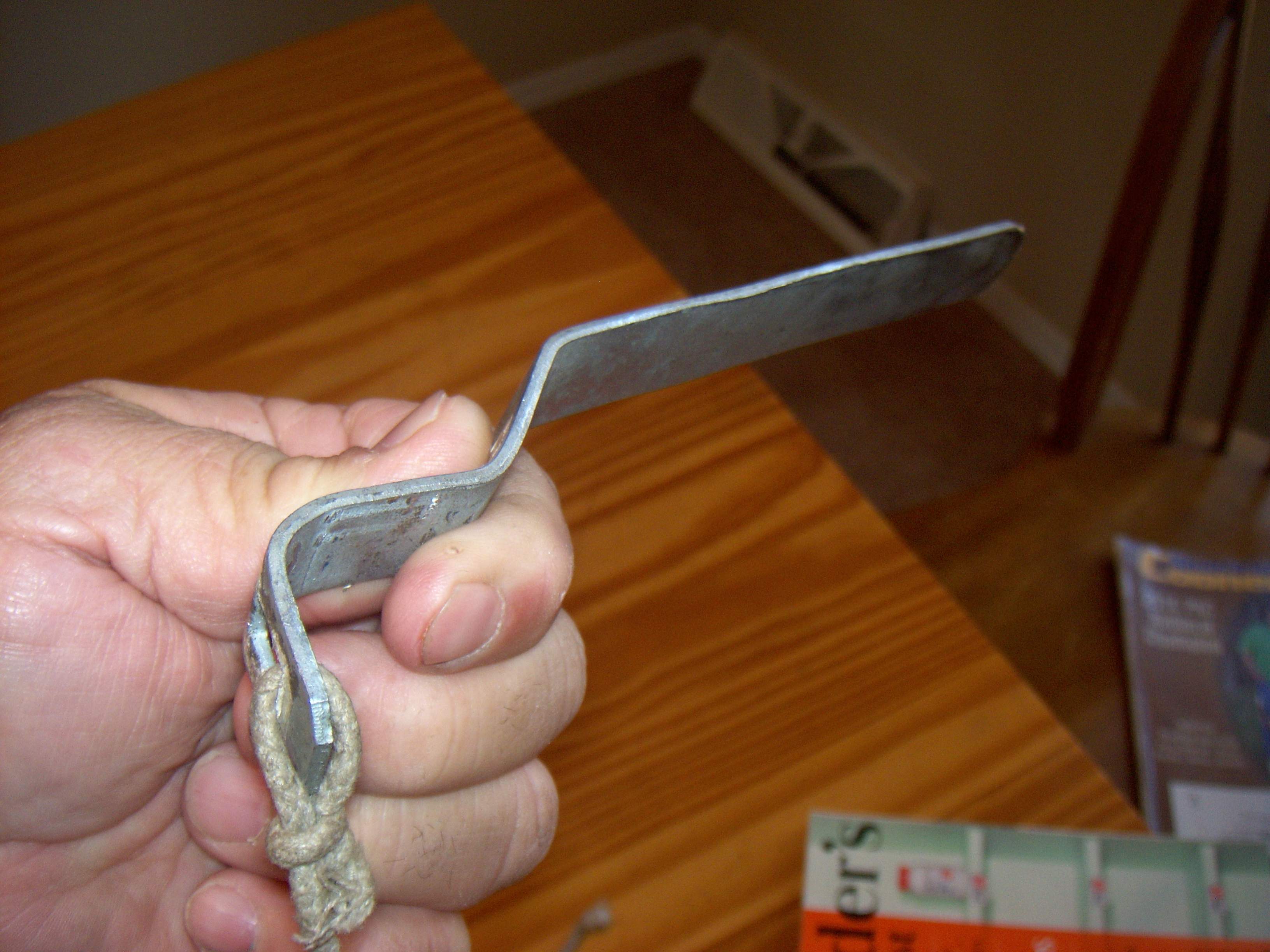

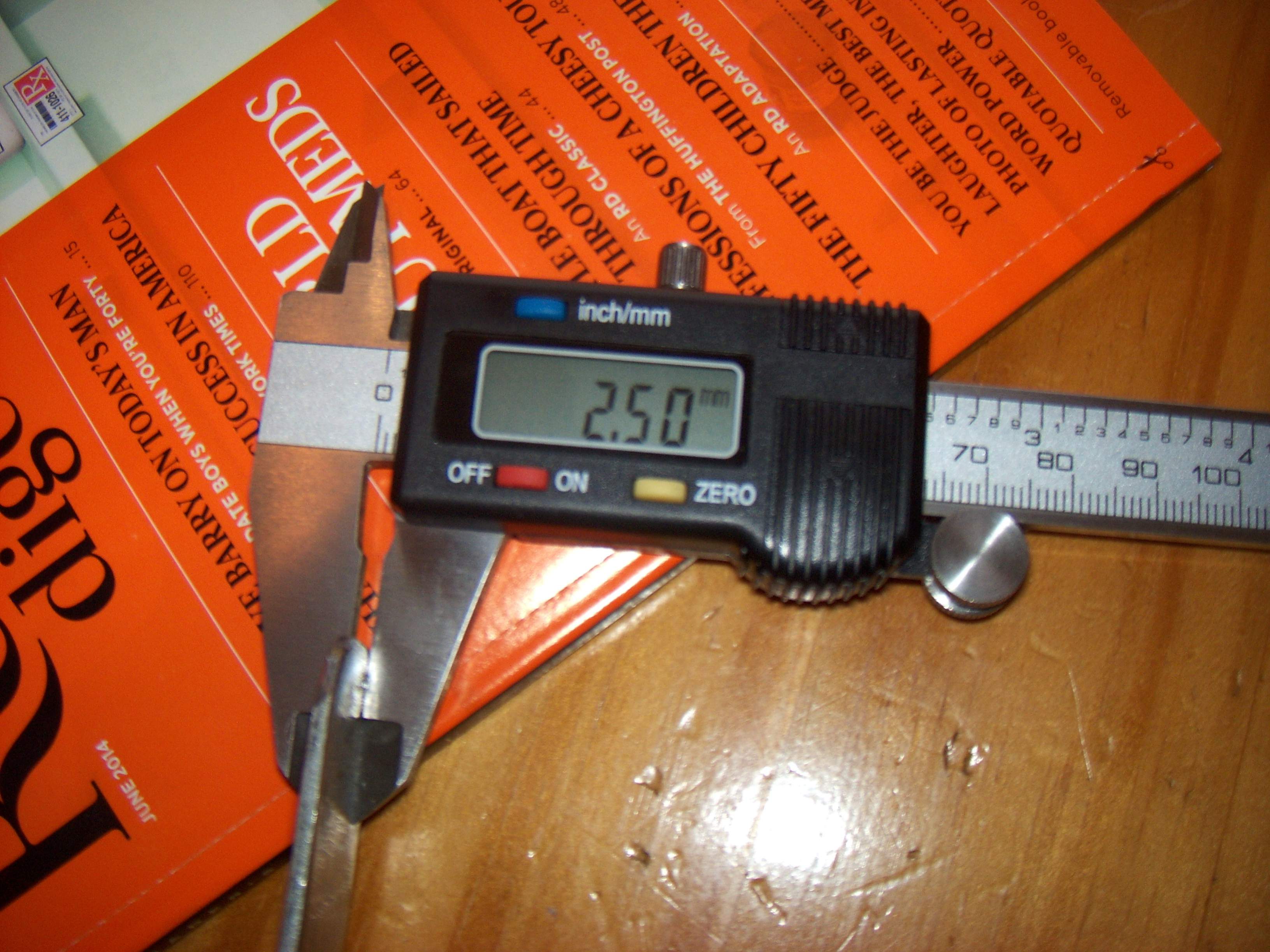

The 0.035 was for the big nut for PTO, I re-gauged them at 0.038 (Misplaced the 0.035 Feeler gauge)
Here is a pic of the gauge I made for the 3 clutch fingers gauge at 2.50 mm
I still think the rod/fork at the clutch arm need additional attention
