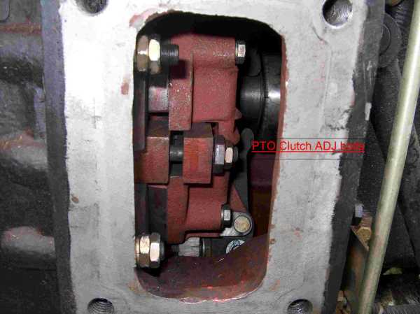

Problem: PTO Grind when using clutch, Drive clutch working, no slippage, pedal catches at top.
1st; I Adjust Stop Bolt & Clutch rod, very little relief of PTO grinding (Rod was bent a little)
2nd; Remove Plate to access clutch & adjust, starting with PTO
All 3 PTO nuts have 0.160 +/- gap & all 3 Clutch fingers have 0.200 +/- gap; Pic of PTO nuts before adjust
Is pressure plate gap right ?

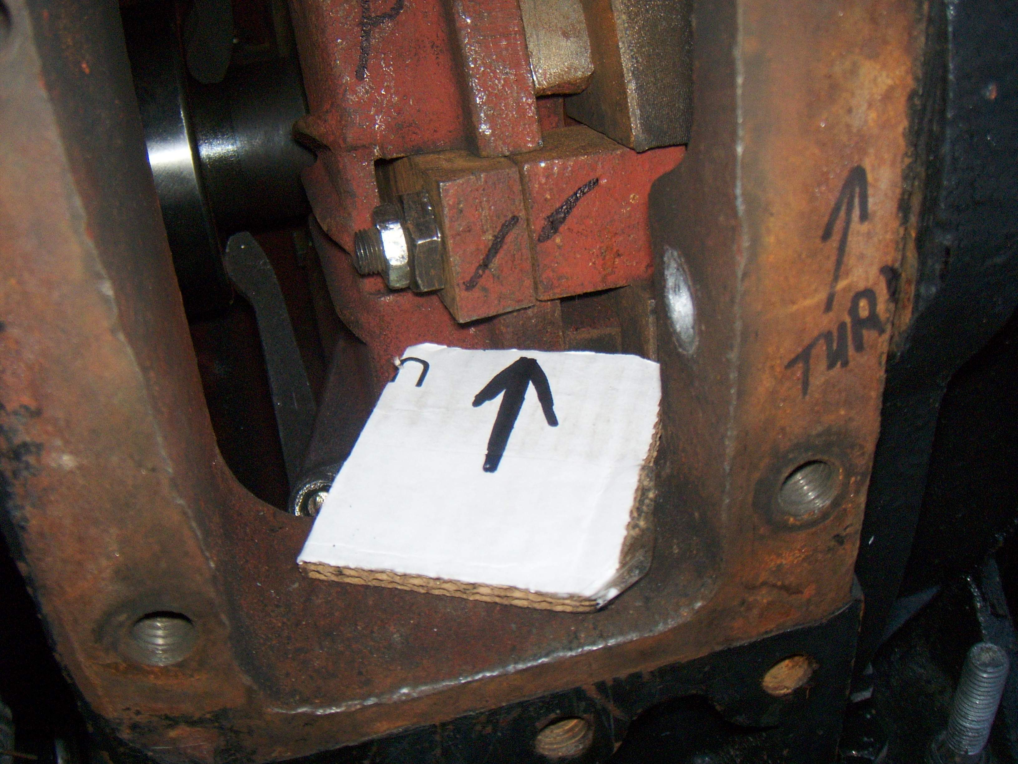

3rd; Adjust PTO nuts & lock at 0.035; Pic after adjust Notice arrow to pressure plate gap
Here is where failure hit's me in the keister,
After PTO adjust, fingers are now against throw out bearing & will not adjust; 2 Pics of finger adjust bolt before adjust
Notice the lock washer, That should not be there ?
The other 2 nuts were locked on pressure plate, they should have been on finger, right ?
Can not get fingers to adjust off bearing now
OK, help needed
Are inside adjustments done with clutch rod attached or not ?
All this was done with adjust rod off clutch arm
Is gap between plates right ? Pics in other threads look wider to me
Is 300 series Jinma same adjust specs as 200 series ?
I'm gonna loosen everything (PTO) back to see if I can get any finger adjustment
Looking at the adjust nuts condition & the gaps, I think someone butchered this adjustment,
I bought this tractor from a dealer in Ohio, & other than some minor snags, has been OK, in fact I was happy until now

Hi Tommy, No gauge was used between plates
Yes, 0.035 was placed under the big nut
I can't figure out why the plates are so close, only has 140 hours, so I don't suspect friction plate wear
The plates were close when I begin
The PTO nuts were very easy to turn & I could have tightened too much, but I have now loosened PTO nuts & starting over
Will activate clutch pedal to see if that plate gap remains the same

My first thoughts Tommy, I had forgot about the bevel spring until I looked at the parts diagram
Since last post, I have loosened the PTO nuts & re-gaped to .038 Then I had a little room/gap at the fingers, but did not adjust,
I hooked up the clutch arm & clutch works fine, except for a little "chatter" when taking off, PTO still grinds, but very little
I also have concluded that the 300 series clutch, pressure plate gap is closer at the PTO bolt than the 200 series
I have not found any pics of a 304, but
I have found pics of 3 different 354 clutches & all have close pressure plates; Ranchandsupply has a good pictorial on a 354 clutch
I do have room to adjust the rod/arm now

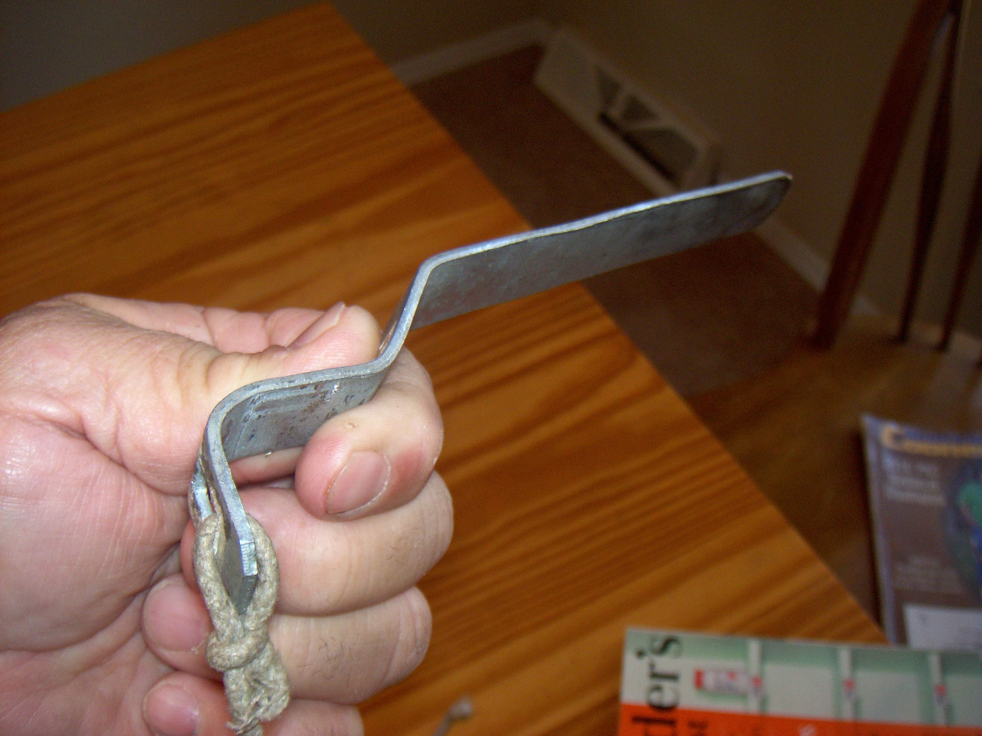

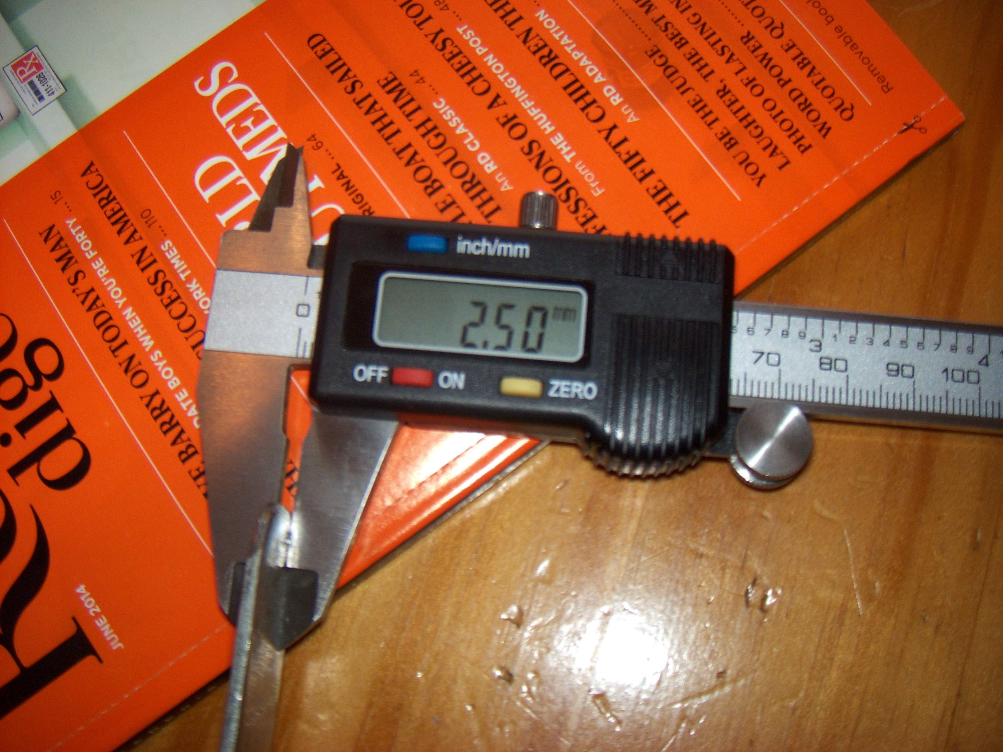

Here is a pic of the gauge I made for the 3 clutch fingers gauge at 2.50 mm
I still think the rod/fork at the clutch arm need additional attention
