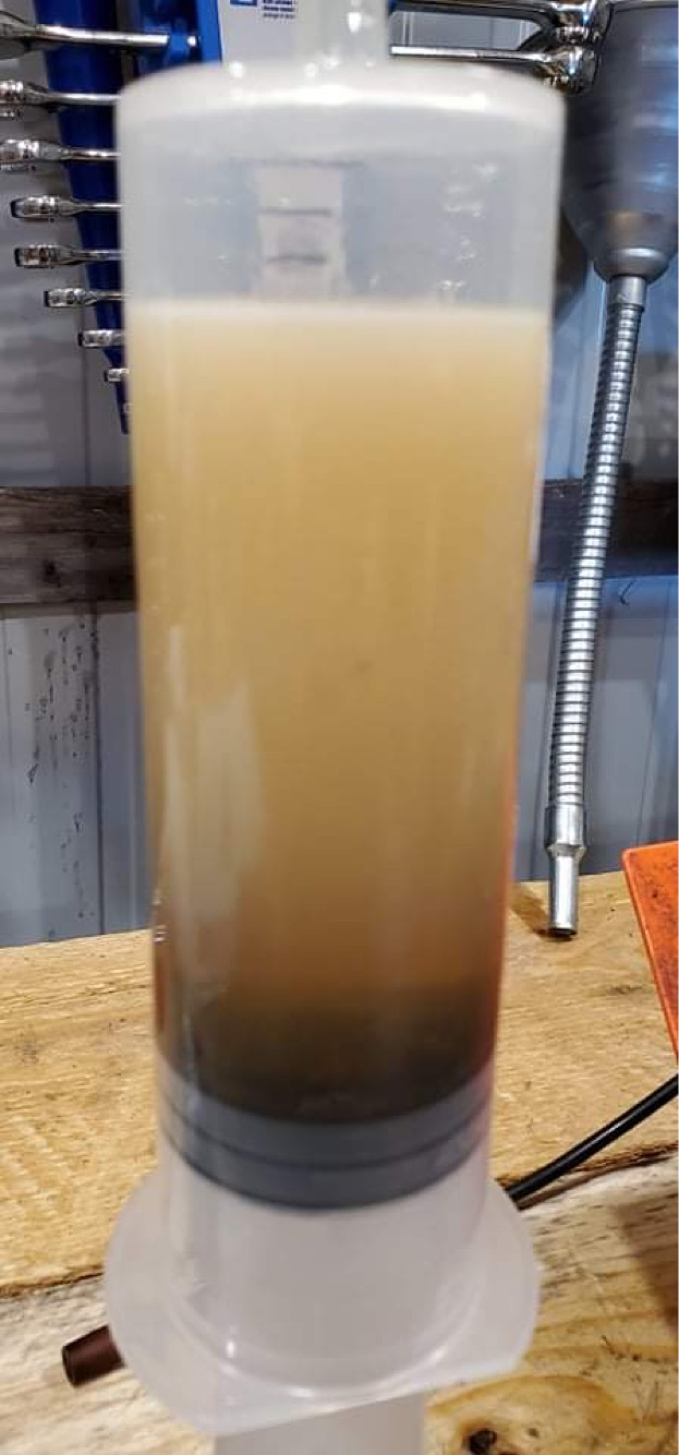

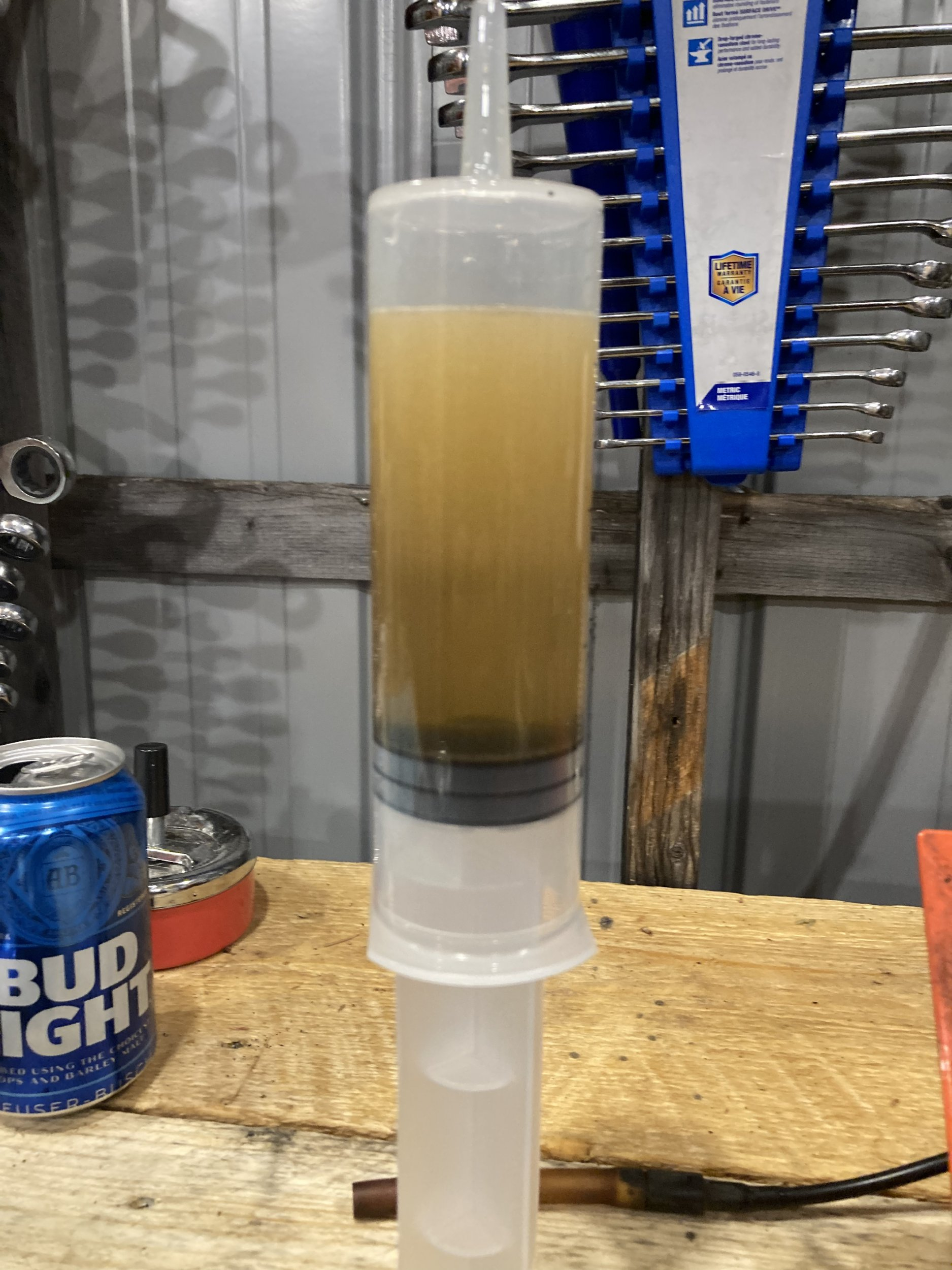

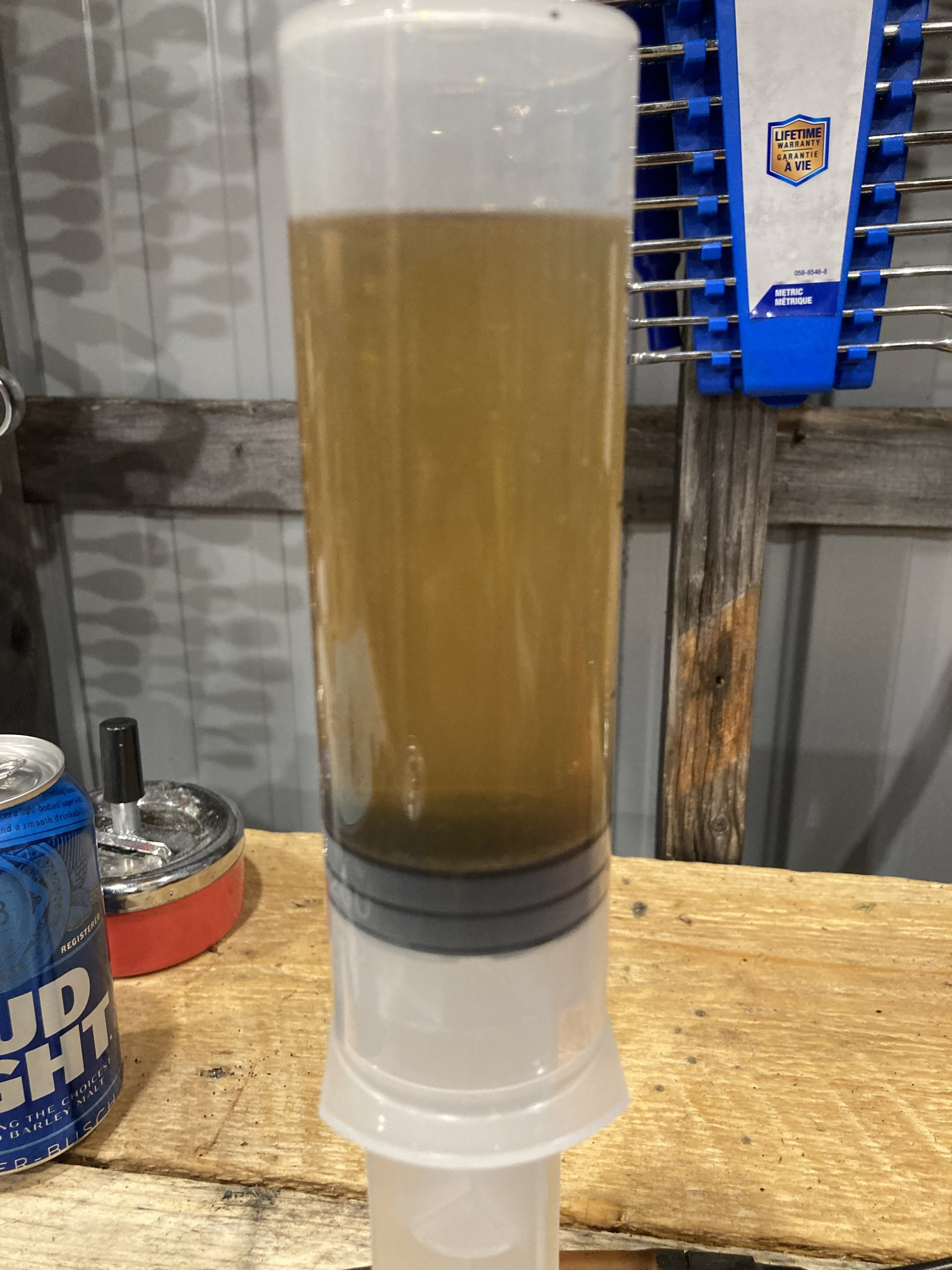

Recently changed my fluid in my hydrostatic transmission and noticed fluid becomes cloudy after running tractor for a few minutes...was wondering if this is caused by the return oil splashing when entering the reservoir or there is water, cavitation, aeration?

Can you siphon or drain some of the cloudy fluid out into a clear glass container? This way you can observe better if air entrainment or moisture. Air you will tiny bubbles water fluid is typically milky colored and over time there would be separation layer of water and oil.

Took some out there is no sign of water...it seems to be air. Any idea how air could enter the system? Can find any leaks.

How long did you let the container sit?

That sure looks like water to me. Draining and filling with new, may take more than one cycle of fluids to get all the water out.

It looks like air to me too. Microbubbles. Water is usually more opaque - it really can look like dirty chocolate milk.
Air goes away pretty quickly... The tainted fluid appears to rise up because the microbubbles make it less dense than the clearer de-aired hydraulic fluid. I've never timed it but that process takes hours rather than days.
Water takes days if it separates at all. Depending on detergency, sometimes it either doesn't separate or takes so long that I've gone on to other projects. If it does separate, I would think that the clear amber hydraulic oil is less dense - most oils are not as dense as water - and should float on top of the water.
As someone said, the only way air can get in is from the suction side - basically that means it has to be getting in somewhere along the path that starts at the bottom of the common transmission/hydraulic sump and continues up to the inlet to the hydraulic pump.
Typically that path will go from a cleanable crud filter inside the sump, out through a fitting on the bottom of the sump, up to a spin-on replaceable filter or even two spin-on filters in series - and from the last filter it goes directly to the hydraulic pump inlet side.
The suction line can be a rubber line although more commonly it is a steel line with compression fittings. We do see leaks sometimes associated with pinhole damage to the wall of the suction line itself, but by far the most leaks are in the end connections rather than to the line itself.
Look for suspicious places from the suction line as it exits the sump and goes to the filter, or from the filter to the inlet to the hydraulic pump . It is rare for the leak to be within the pump itself. Although I've heard of leakage past a rotating shaft seal and into the suction side of the hydraulic pump, it is fairly rare.
Don't even think of looking inside the pump itself until you are positive the suction leak isn't in the suction line or fittings.
