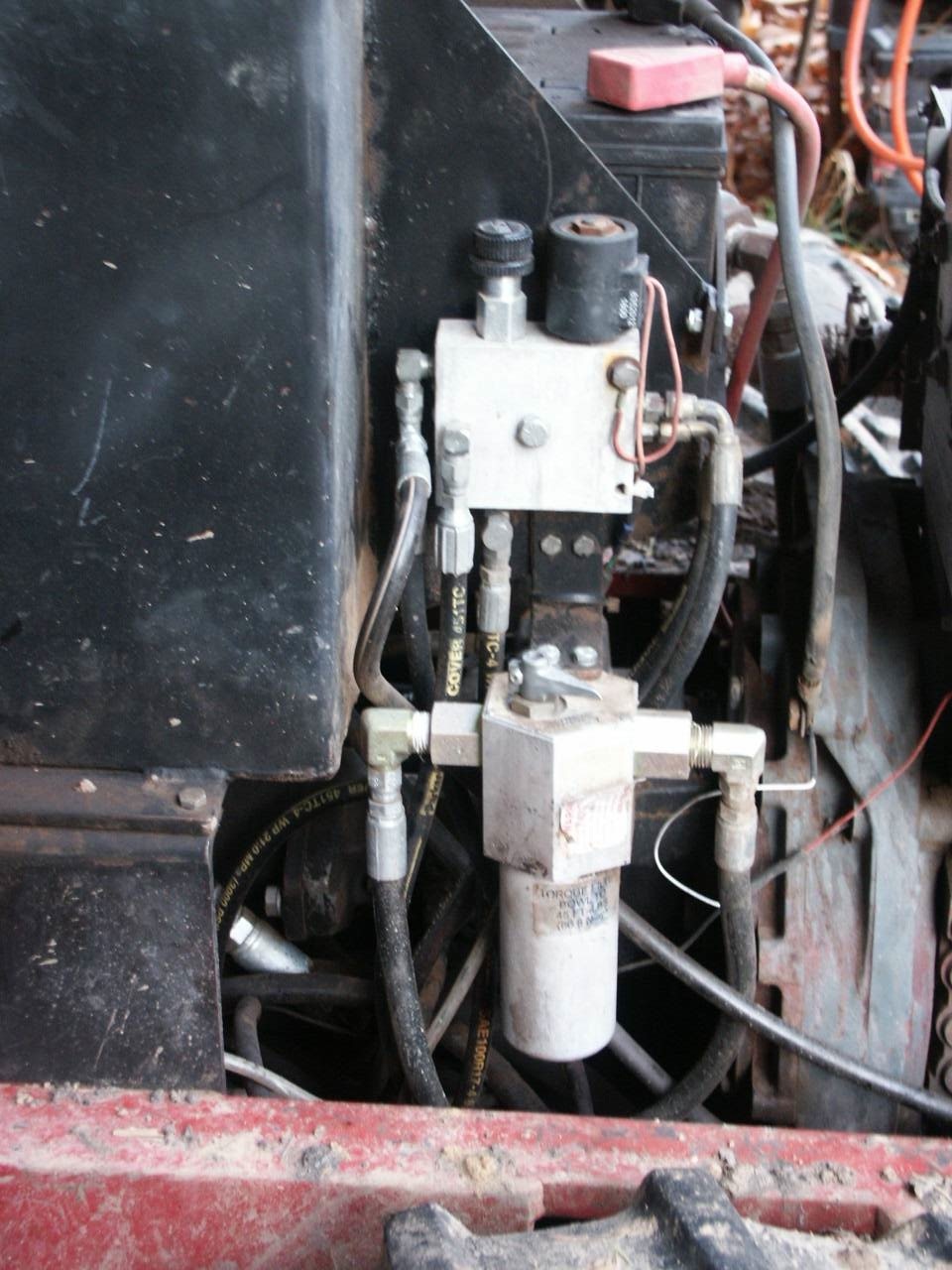

Woodlandfarms, when you get a chance, could you post a picture of the high pressure filter. I think you posted it before...but, as usual, I can't find it. To my knowledge, your PT is the only model I've heard of that has a high pressure filter from the factory (unless someone added it later). My 1845 only has one filter, but I'd like to add a high pressure filter. It would be nice to see where PT choose to put it.

Here is a picture of the filter.
On the top it says Schoeder F-11 but I cannot find any record of it on the net. There are some other numbers on the filter container but I have to take it off to read it. It takes a Schroeder N-25 filter, again, hard to find and grossly overpriced by PT. I find them now online for $8 per filter and PT charges me at least $25.
This all said... How it is run is there are two lines out of the "front" pump, one is PTO, one is steering and lift. They go into a aluminum block under the fuel tank left side that has a solenoid and bypass valves. The solenoid is for the PTO and the oil dumps back into the tank or into the system. So, from the Lift Tilt outlet on the PTO block it goes up the the filter feeding the RIGHT side of the filter in the photo, the outlet is on the LEFT side. From the outlet it goes down to the Accumulator valve located just behind the Left rear wheel. 1/2 inch hose I think.
This filter has a quality meter on the top which I do not think works.

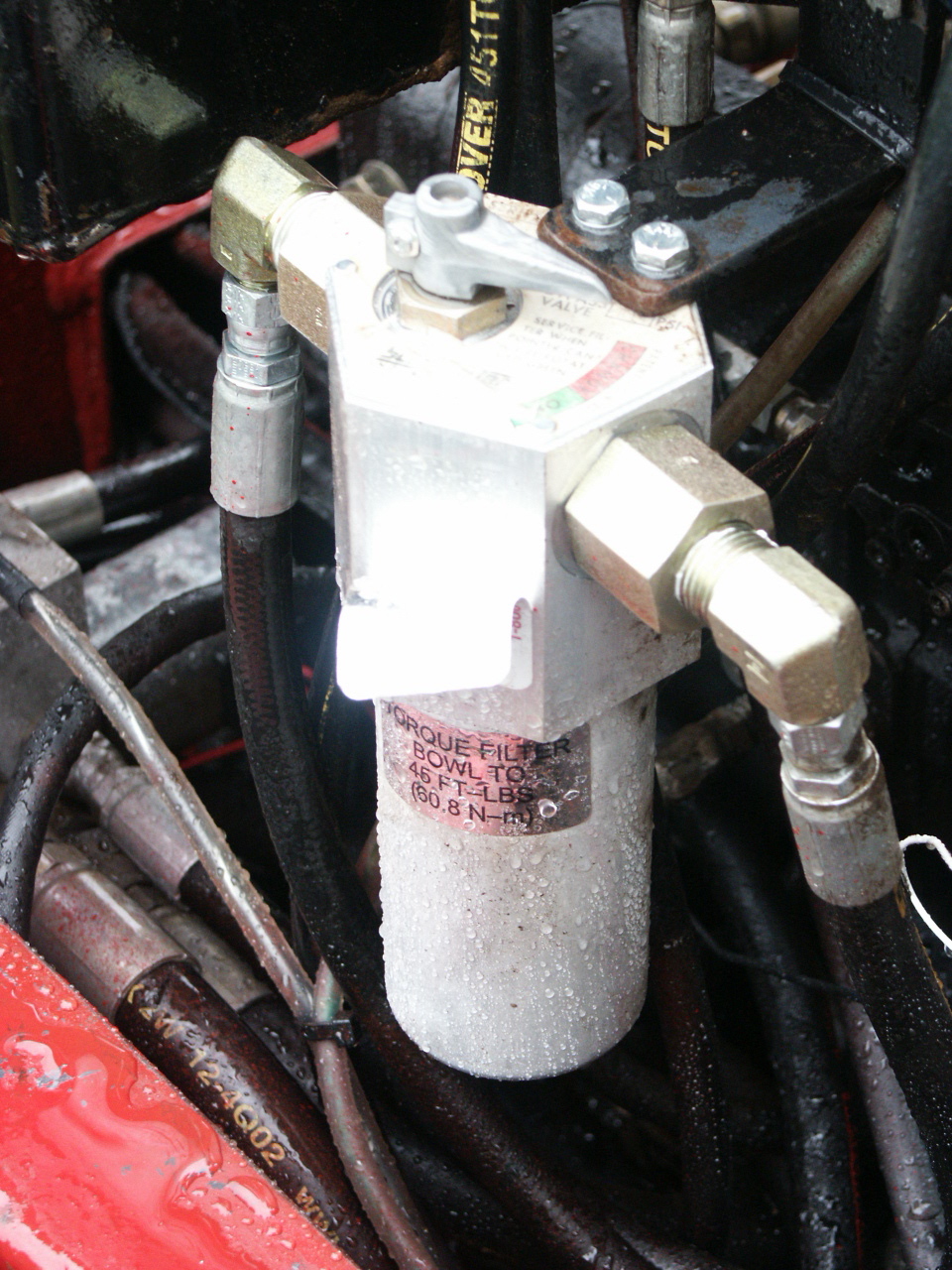

And here is one more.
Thanks JJ for the info. It is just that I have not found my specific type of filter holder. Must be an older model. I have found a few filter places to buy from, not sure of reliablilty.
Carl,
From your description of the circuit it sounds like this filter only filters oil to the accumulator. On my 1845 the accumulator is supplied from the variable displacement pump--which gets filtered oil via the charge pump.
My guess is that the accumulator is very sensitive to foreign matter in the oil and the filter is installed in your PT because the accumulator is supplied with oil from the lift tilt circuit which comes directly from the sump without filtering. For those of use with the accumulator on the drive circuit the additional filter is not required. Additionally, the high pressure filter would filter very little oil if it is only connected to the accumulator.
One thing puzzles me however--the annual filter change. The amount of fluid moving into the accumulator is quite small and at high pressure. It is hard to imagine that it would load up and require frequent replacement.
Your filter looks like the Schroeder NF30.
