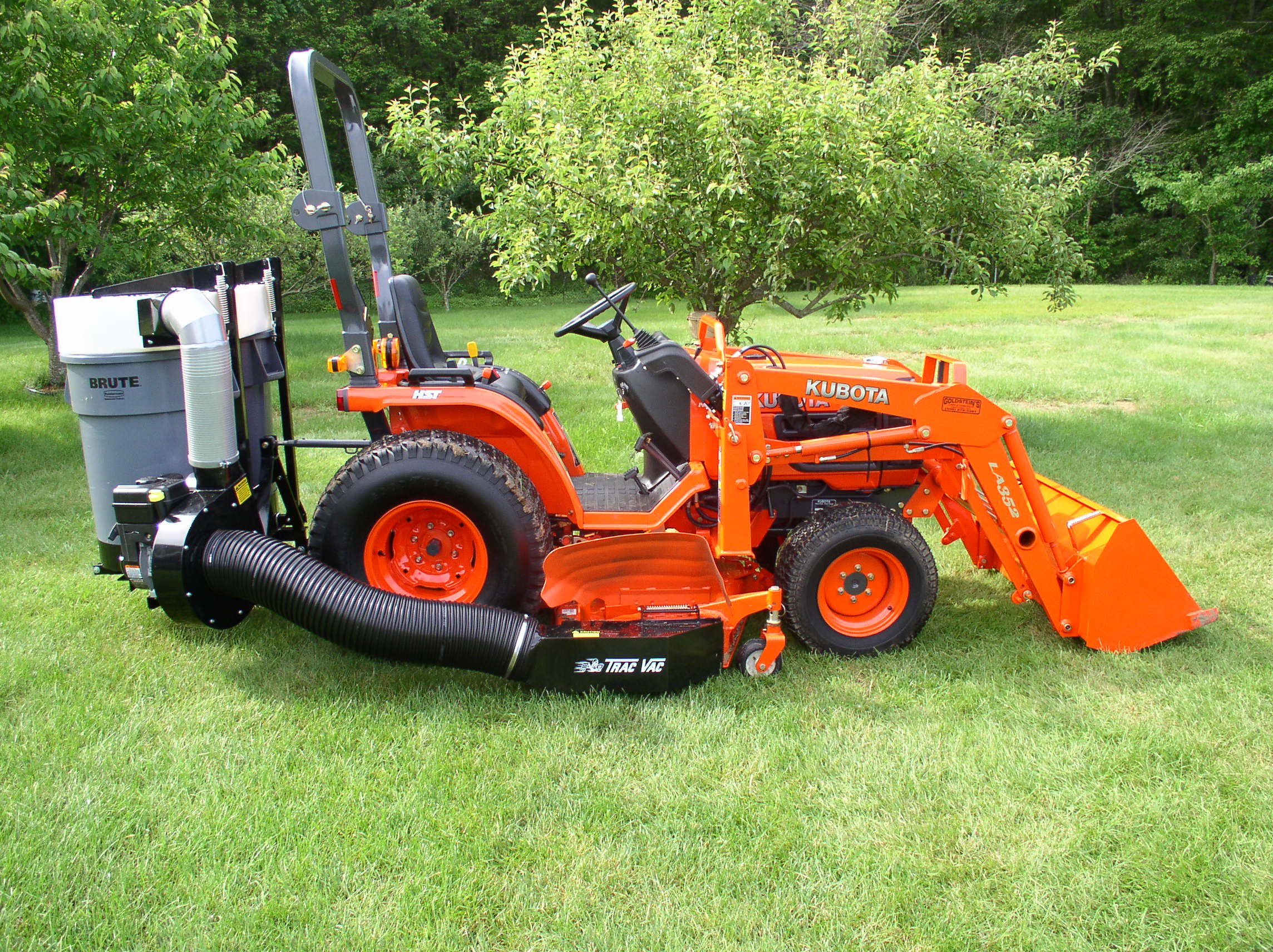

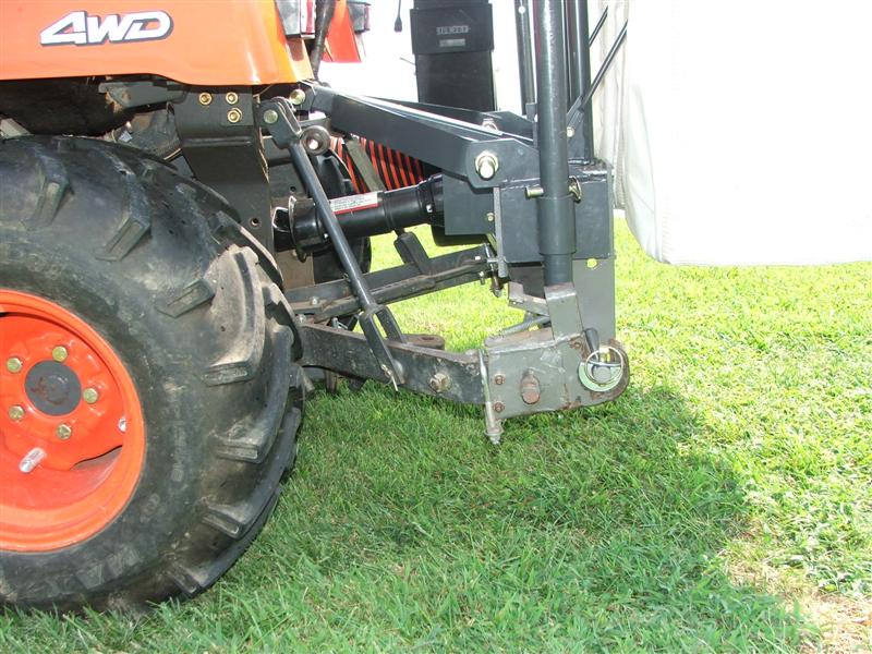

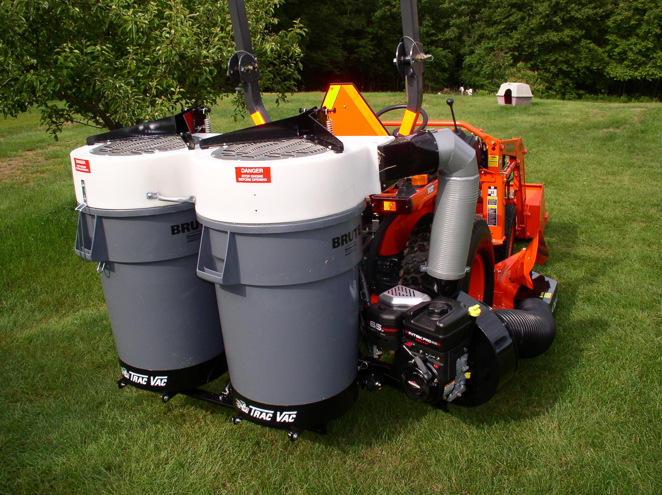

I'm running a Trac-Vac setup on my B7610 with a 60"mmm and I haven't glogged it yet. I've ran this thing through some tall thick stuff and it picked it all up.

/ Clogging MMM -- help! #29
Which model # is that one, I almost bought one similar, but it had two caster wheels under the rear and they retailed for $2100, priced to me for $1900, price and extra engine is the two reasons I didn't get the Trac-Vac, although it is the best looking setup that I saw in my search.
/ Clogging MMM -- help! #30
Milkman,
This is a model 662. I went with the bigger 6.5 hp briggs intek pro which also comes with a bigger turbine unit. This thing mounts to the 3-point hitch so there is no casters. So far I've been extremely pleased with the unit in all aspects. As far as taking it on and off, it literely takes me 60 seconds or less.
