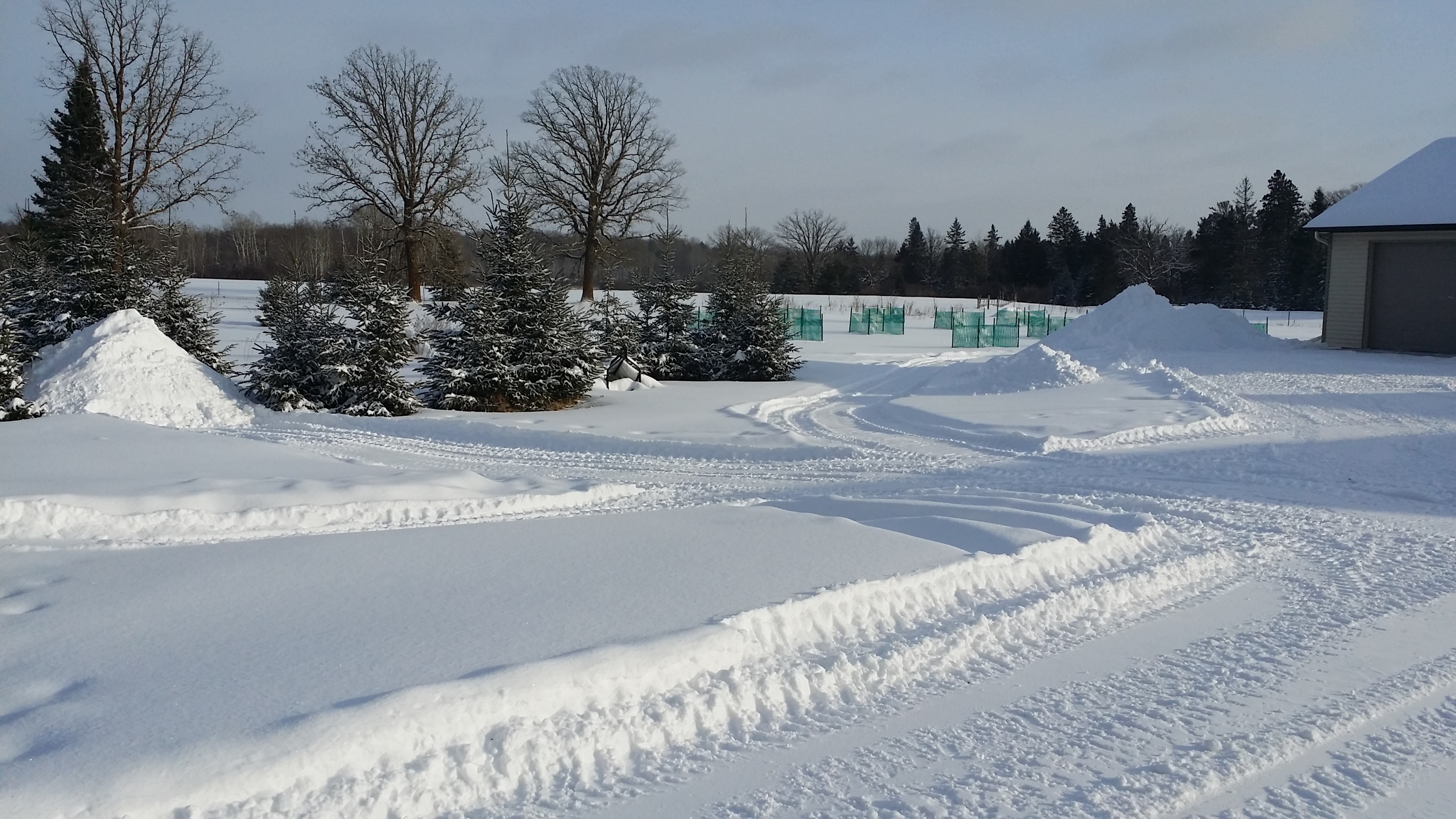

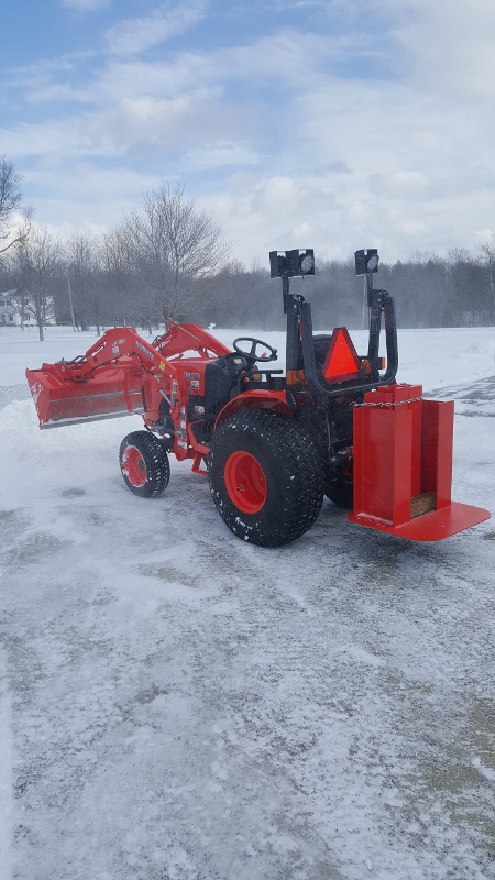

I just did mine for the first time a couple of days ago. I added a Snowedge to mine to save my asphalt drive and everything worked out fine. I finally started just pushing the snow off to the side and didn't even lift the bucket for the next pass. The tight areas I backdraged to get the snow out from close to the garage door etc. then pushed it off to the side. All the odd angles and such are not easy to clear as my drive way is essentially a big sloping doughnut with no straight lines anywhere not even the connection to the road to work with. Just float the bucket and push the snow off to the side. BTW I grooved my R4 tires for better snow traction and did the whole thing in 2WD.
