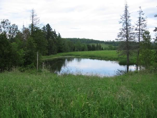

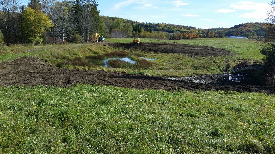

Had an excavator by yesterday to make an opening in the dam. The water flowed out with a thunder and a roar for a few hours. There's a pretty deep hole in the middle retaining quite a bit of water still. The plan it to dig a sediment basin upstream of the main feeder to manage the silt. Then dig down a few more feet clearing out the silt and weeds. Hope it will hold water when we're done... Have no idea what I'm doing.

The idea I had was to put the dredge material in piles to drain some then dump it over the side of the dam. It stinks.
The deepest point in the pond appears to be close to the dam. Will clean up some cattails along the dam and that should do it for that area.
The sediment basin, if designed right, should capture most of the silt coming in from the feeder brook. At least I hope it will.... :)

Plugged up the breach and installed a 15" poly overflow. Went down about 3 feet and sloped the edges. Set some stumps and logs along the bottom so the fishes have a chance with those pesky otters.

Can you give us pics, closer up, to the poly overflow, and maybe say more about why you chose to go that route?
/ Cleaning out the pond.
#18
Coyote,
I'm back in Jersey now. If you do a save as on the image I posted and open it up in photo viewer, you can zoom in on the overflow pipe.
There's two main feeders that keep the pond full year round. One is a small brook that drains the two fields and the other is a spring. Both flow year round with the brook's volume varying, depending on the amount of precipitation.
There had been an open 4" sched 40 pipe set low in the dam that kept the water level about 2-3 feet below the top of the dam most of the time. That drain was damaged during the clean out and is no longer functioning (although I might be able to clear it). In years past, during the spring snow melt and with any extended period of very heavy rain, water would top the dam at the far end where the new 15" overflow pipe is now.
The top of the new overflow is set approx. 12" below the top of the dam.
