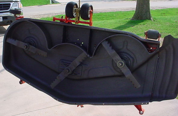

Here is what my deck looked like after 3 fresh coats of slip plate this spring..
Brian
