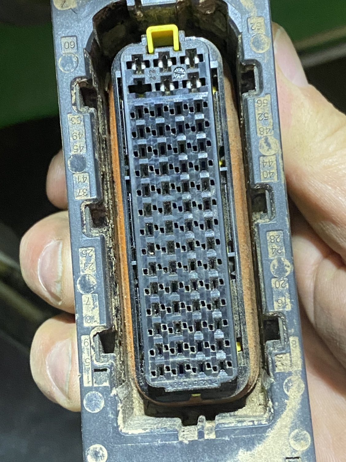

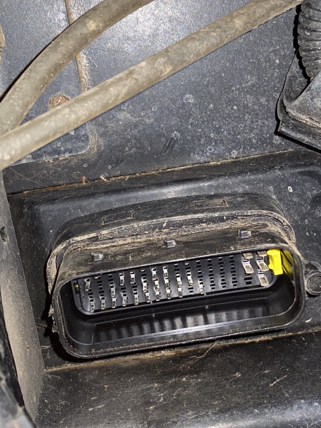

What’s the acceptable service department method of cleaning this?
Wiring Harness 6430 Premium
Part Number AL201847
DescriptionWIRING HARNESS, ENGINE/4-CYL. 4VHPC
I’m getting low and  variable voltage readings in the cab in various codes seating low-voltage in causing the SCVs to stop working and I think it’s due to connector corrosion somewhere.  alternator output is steady and battery stays charged.

I use contact spray cleaner than small cleaning tool design for clean,once dry little Deoxit grease....yet to have problem with tractor or snowplow.
   / Cleaning Harness connections #4
I had a similar problem on a piece of equipment. Sprayed all the connections with a plastic safe electrical contact cleaner then sprayed the connections with fluid film before reconnecting. Solved the bad connection.
