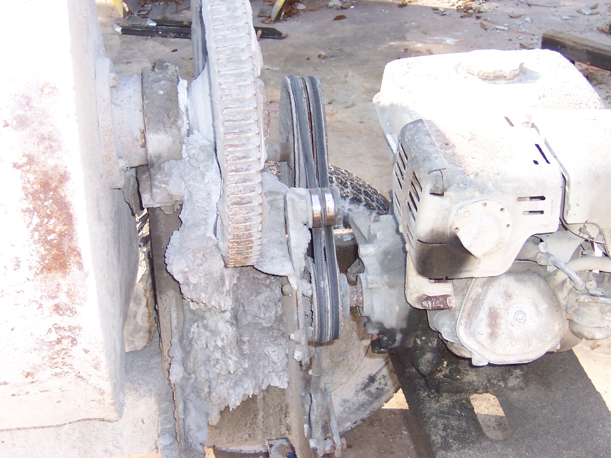

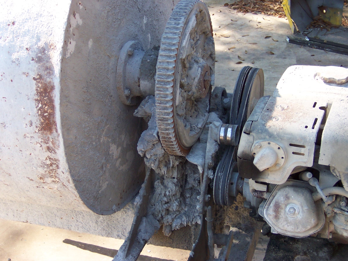

I sell and repair Mortar Mixers, I am a dealer for two brands. I use an air chisel with a flat tip punch to clean machines before I can repair them.
Muriatic Acid will disolve mortar/concrete but it is slow and dangerous.
Here are a couple pics of a machine that I repaired.

Stimw
I assume those are the "before" pics. :D
They sure look daunting to me.
How about some "after" pics ?

So you clean the entire machine or just where the build up is? What I am thinking is needing to clean similar to what is on the drum in your pics. Basically strip the trailer down and ultimately have to repaint it.

Hard to believe anyone would treat a piece of equipment that way - but it's good business for you at least :)
