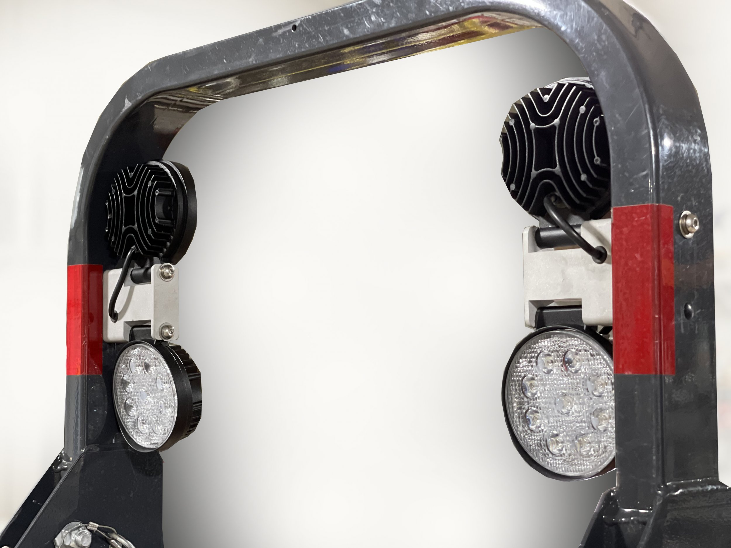

I was wondering how you all have made a bar to attach to the ROPS, to mount your lights on? I need something that will tuck in the ROPS so that when I brush against a tree limb, the limb goes against the ROPs and doesn't hit the lights.
Curious to see what people made and how their attaching to the ROPS. My current is just some angle iron, nothing fancy. Looking for a cleaner setup.
Have a look at the Kit we designed at this link -->

Check out the light kit by Tractorbracket.com

I drilled and tapped mine into the rops just using sheet metal screws. Nice and easy but a good idea to dab a little paint after drilling just to cover the bare metal.
Don't EVER plan on selling or trading it in because what you did is highly illegal as far as the ROPS is concerned and if you trade it in the trade in dealer will have to replace it before it can be resold to anyone and you, as the original owner are liable for the replacement cost.
You obviously never read the sticker on the ROPS or in your owners manual where it states that modifying the ROPS voids the warranty as well as the structural soundness of it.

For clamps 2 flat pieces of metal drill hole in each end
and bolts long enough to fit. cheap fix
